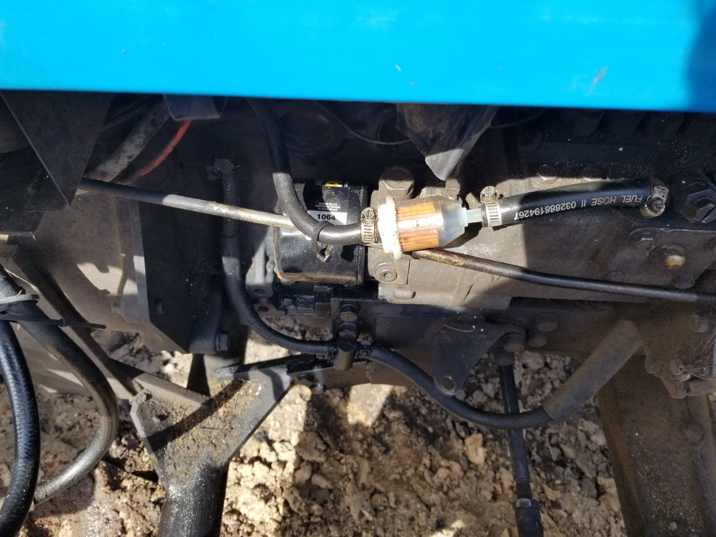

just recently changed oil, last weekend, was running great etc. .. fast forward 4 days weather is nice, i am like lets take this baby for a spin grade some dirt etc, anyways about 20 minutes in the engine sputters and dies, went to check gas seems enough? then went to check oil level.. whoops the dipstick is gone anyways the question is would the engine stop running due to low level? i have no idea what its at right now due to no dipstick, also where can i find dipstick for my tractor seems to be pretty hard to find one? anyone have part number?
one more thing i am not sure whats the horsepower on this thing is, the engine cover says 18ps, and some sites list is as 18 hp and others as 23 hp?

Thanks alot sir, couldn't get ahold anyone by phone sent an email. Also a little update did oil change just to be sure that it wasnt empty and got little under 4 quarts out, so it wasnr running dry, the problem turns out was a dirty fuel filter after I replaced that it started right away.
Also seems like the previous owner got rid of that filter bowl and use swapped it to universal inline filter, is there any major benefits of using oem style bowl vs a generic inline filter?
It's pretty easy to go (back) to a spin-on filter. Kits are available. Perhaps the previous owner thought the filter cartridges were too pricey. But many of the kits have a clear bottom to allow you to see water/sediment and drain it out. The filters last longer.

That's a basic gas engine fuel filter for 60s, 70s and early 80s vehicles. If you machine is diesel, it would be smart to switch it back. HOWEVER, your machine is a gray market Mitsubishi. Thus, the smart thing to do is, look at US domestic sold Mitsubishi-Satoh machines and see if you can convert over to them. As a heads up, pick one that is popular and will work with the engine size and power to your machine. Then it's simple. :)

Looking at the OE filter for the D1850, it's really pricey and it's a full metal can. You wouldn't know it's dirty till the tractor wouldn't start. And the fuel filter is inline too.
