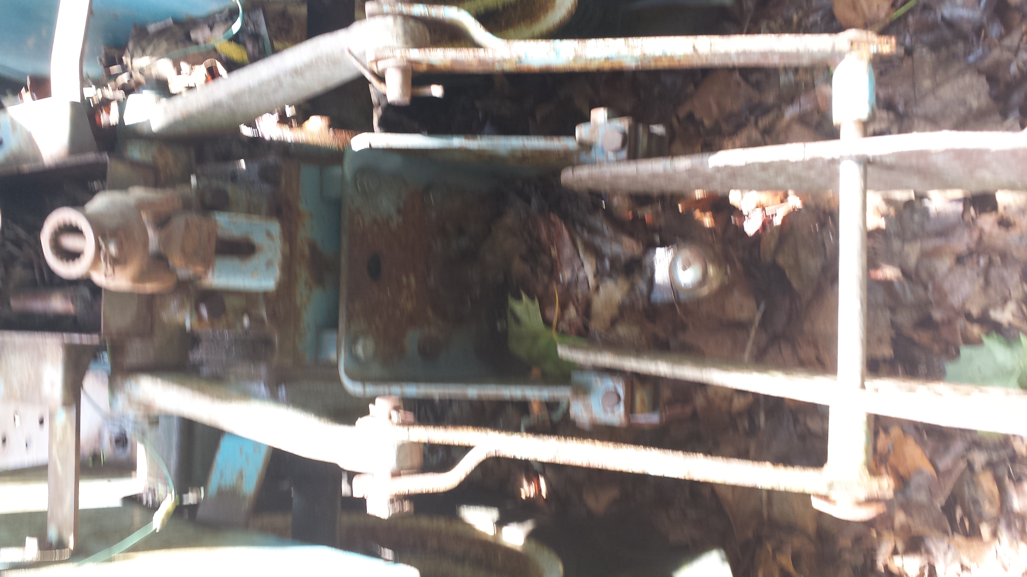

This is my first post here, and thanks in advance. I recently acquired a Mitsubishi d1500 that is completely naked on the rear end except for a homemade bracket for a blade. Could anyone post a pic that shows what I need to attach implements? There is a bracket where the top link should go that looks like a chain goes instead. I'm wanting to get set up for a brush hog first. I'm a tractor noob so be patient.

Well I can't post links until I have three posts. So here's #2. After rereading my first post I see I wasn't clear. I need a visual to see exactly what I'm missing. I've found a few "complete" kits, but I need to make sure before I order.

Most D1500s came with a 2 point tiller so most d1500s didn't have a 3 point. It was available according to the parts book. I do have a D1500 with a 3 point so I could put one together for you.
