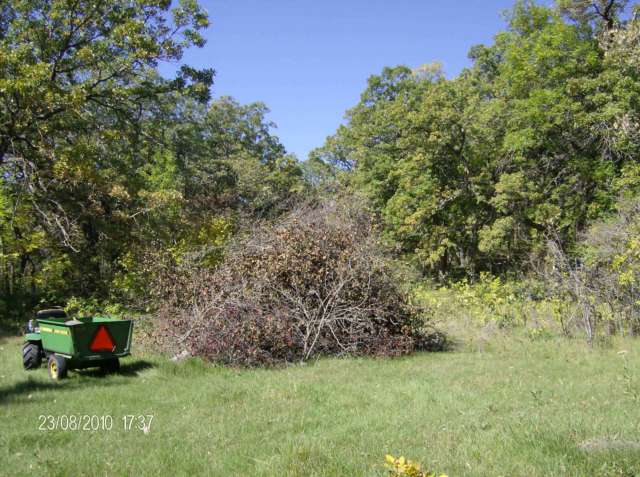

I must maintain 2 miles of trails on the 100 acres up here. I finally replaced my 2 front tires after about 20 patches in each, from running over chunks of Hawthorne. I have a JD15 cart that I put the chain saw, 1" Corona loppers (for brush cutting), and other tools in for brushing and sawing out the initial trail. I used to exclusively use the JD2305 with 4' brusher, but it chops up the thorns and you have a zillion pieces to clean up that go throug the tires instead of dragging the sticker bush or thorn tree off the trail. I spray the stumps with Garlon 4 and diesel to keep the brush from re-sprouting.
If you put in a lot of trails, a Billygoat Outback or DR mower does good on smaller brush and a Stihl brushcutter with buzz saw blade for bigger thorn trees leaves no staubs. Once you get the trail "clean", a lawn tractor works fairly well. A 4 gallon sprayer with brush killer along the trail will keep down maintenance.
Here is a trail that was cleaned out with loppers, saw, etc. The pile of thorn trees is ready to burn. The catch is, you need the clean trails as fire breaks before you burn the thorn bushes.
