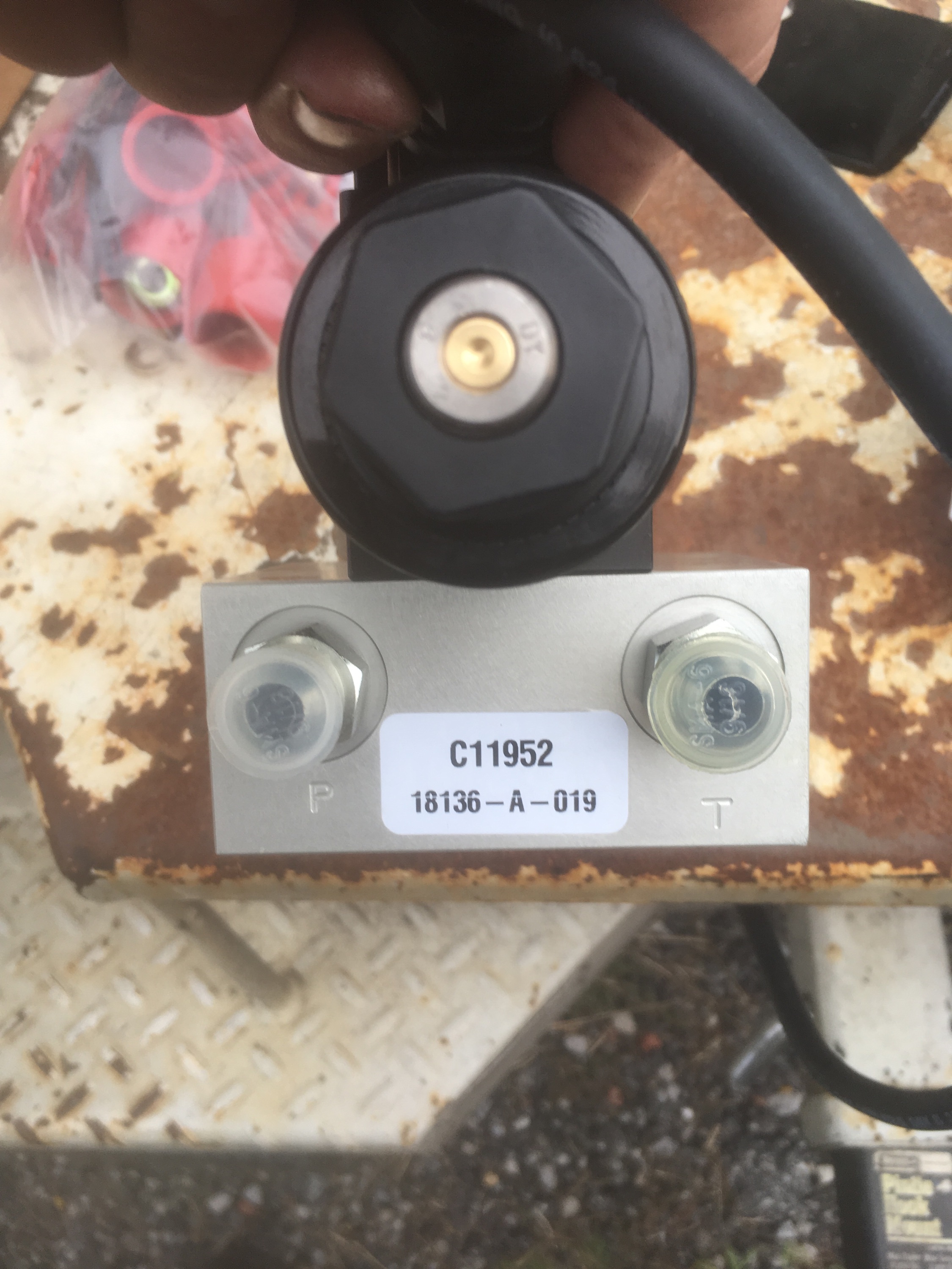

Looking for manufacturer of this D05 subplate, or one just like it. ..
Has on it c11952 .. 2nd line 18136-A-019 google comes up a blank.

More pics with port layout required. What ports does it have, what's the schematic for it, what's it off?
Take the solenoid coil off and see if it has some numbers on the barrel.

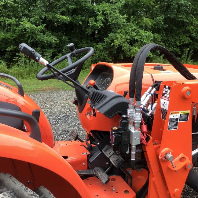

Its off a aftermarket 3rd function kit.

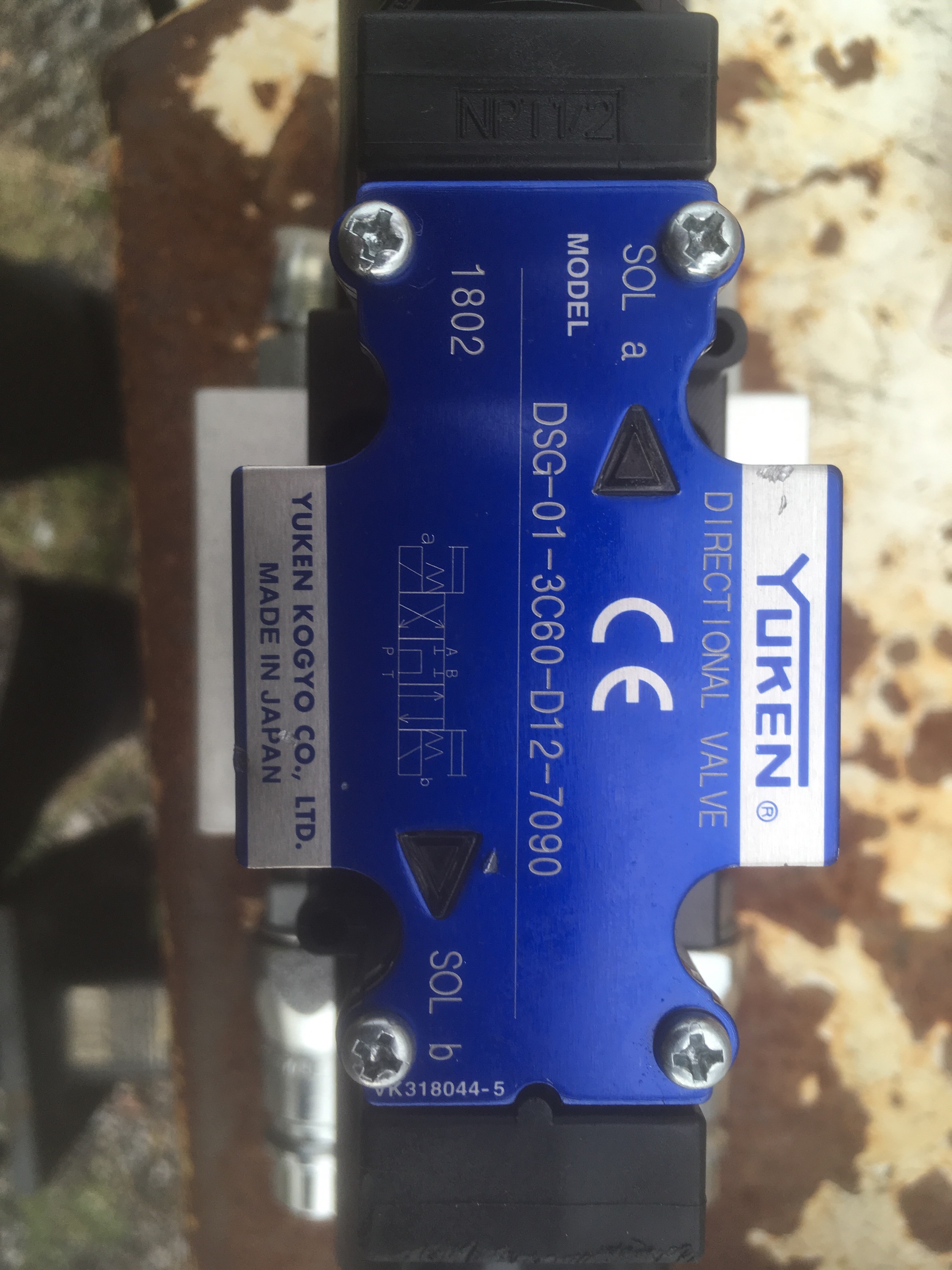

Solenoid valve I have already sourced. Its a yuken DSG-01-3C60-D12-7090
Subplate has parallel ports. P and T on one end and 2 function ports on other side.
