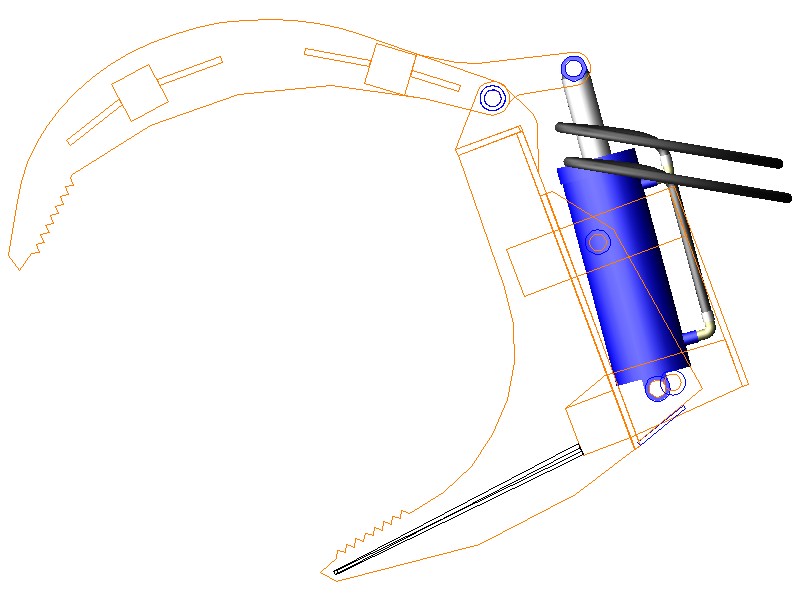

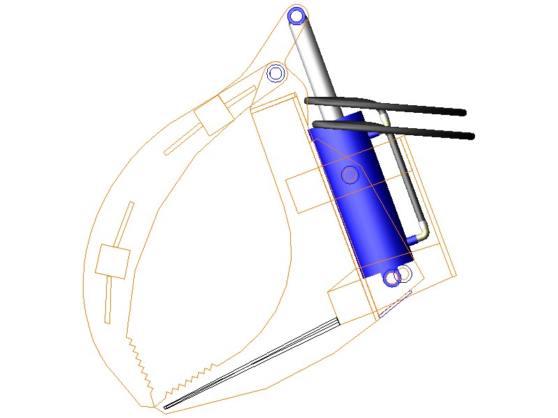

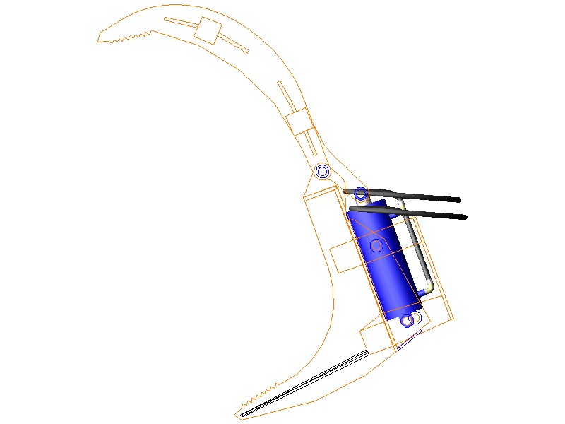

If you have trouble making a mockup, let me know and I'll try to recreate the post. It was basically what steps to take to easily figure out the actuating arm length and placement for your cylinder. One of the important things to note is that the cylinder ram and the actuating arm should make roughly a right angle when the grapple is half open. See the center image.
Other than that, it just needs to fit together without binding...
I used a 3" X 8" cylinder to get 100 degrees of throw on my root grapple. That equates to over 46" of movement at the grapple tips. I figure I have over 2200 pounds of closing force at the grapple tips worst case, so it's plenty strong.
Regards,
- Just Gary
