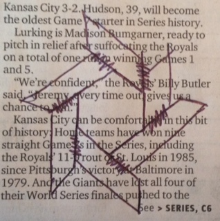

Are you certain that's a threaded nut? Some glands are just turned and as it turns it feeds a spring clip into a groove, and those take very little force to turn, in that case a pipe wrench wont crush it.
If it is threaded, Gland nuts seal by O-ring, therefore are often not "tight", so I'd "try" a pipe wrench first (carefully).
If other wrenching methods don't work out,,,,
You can make a large box wrench quickly, maybe in less time than driving somewhere (or even less time than posting on TBN :D ) if you have this stuff.
-Welder
-Chopsaw or other way to cut 60 degrees
-Steel flat bar
