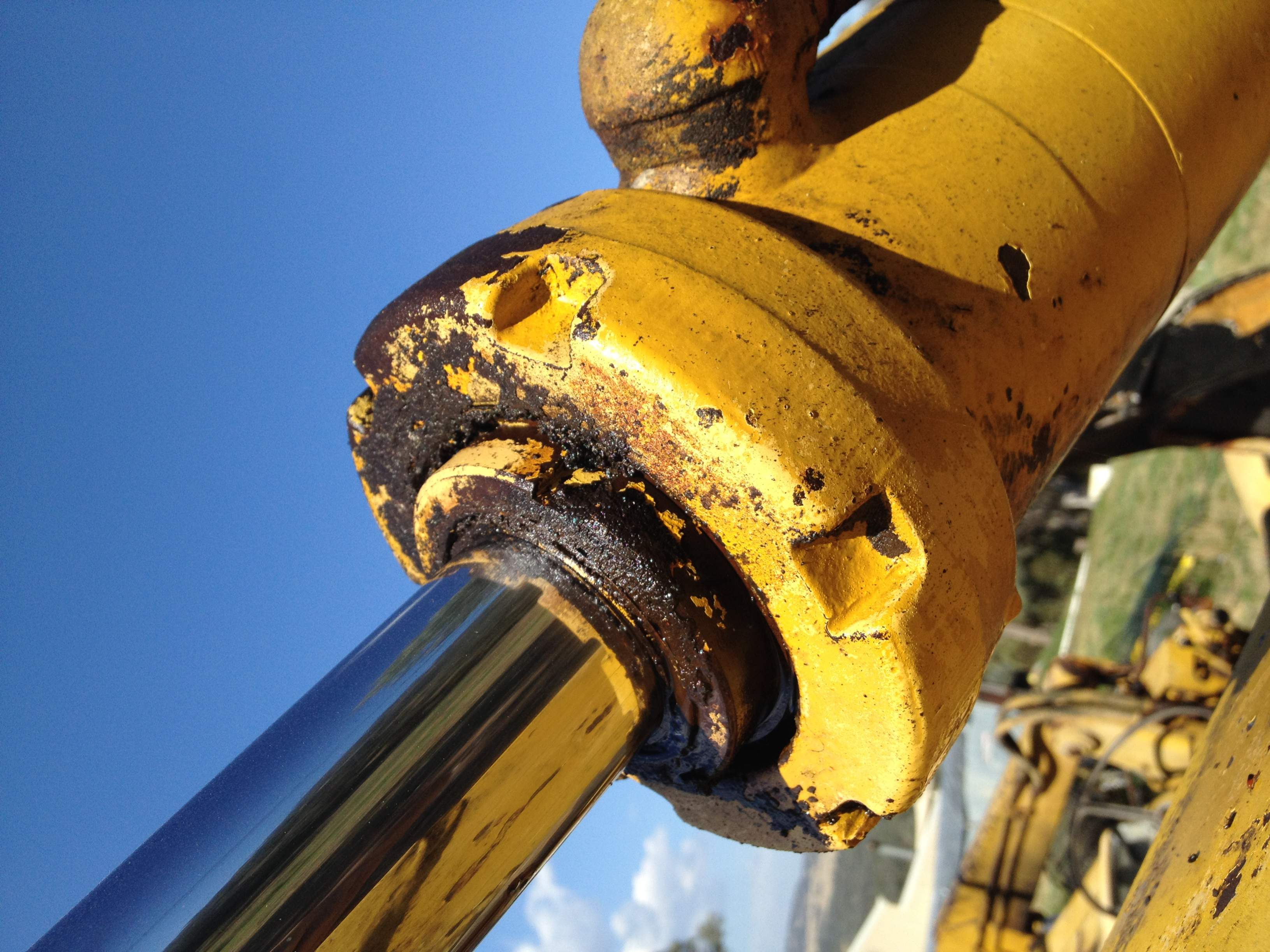

Hello,
I was hoping someone may be able to advise me on the best way to remove the end cap off of a boom cylinder on a Ford 4500 backhoe? I have read about 'gland nut tools' but the job seems a little too large for one of these? Caps are around 6" across and have several recesses to take a special tool. I have heard Stilsons mentioned also, but would rather not burr up the surface too much. Judging by the leak, these have not been serviced for many years so it may take a bit of effort removing them. Oh, and this will be my first go a resealing a ram, wish me luck (happy to hear any and all advice!) Cheers.

It looks like it is leaking at the rod from your picture. Before you go and disassemble and repack, loosen the inner nut and slide it down the rod. If there are any shims under it, remove one or two, tighten the nut back and check for leaks. If there are no shims left under the nut, then you will have to repack.

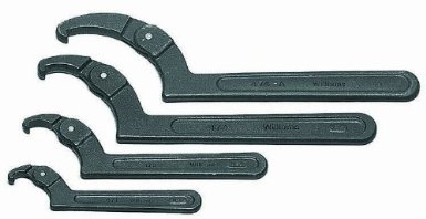

A Stilson or pipe wrench will work without marring the gland nut too much. What is used is an adjustable notch-type spanner for lack of better name.Adjustable Hook Spanner.jpg

By removing the shims under the packing nut and tightening the nut, you are squeezing the packing cups tighter, hopefully sealing the leak. Sometimes it works, but if the chevron packing has torn, then it doesn't stop it.

A preliminary update for anyway following this thread. A large pair of Stilsons (pipe wrench) with the added advantage of a four foot length of water pipe on the end made short work of undoing the end caps. All went pretty straight forward once I positioned the loader and backhoe so that the weight was off the rams and they wouldn't fall after removing the pins. Only had two issues so far:-
1. couldn't physically pull the crowd cylinder out even with the hoses disconnected. Ended up reinstalling hoses and pushing it out using the hydraulics (a bit messy though!)
2. cannot push the lift ram in to clear the mounting point for removal (all hoses are disconnected). Has about 6" of travel left but will not budge. Unless I work something out all I can think of is to wait until I reassemble the other rams, then use the hydraulics again to shift this one?

Replaced gland seals only due to cost (stabilizer leg seal kits were $490 per cylinder! - I had expected < $100). All went well (extra leverage needed here and there) and all back together. Old girl is running well with no leaks and should last me for a few years (very low usage on the farm - just handy to have)
