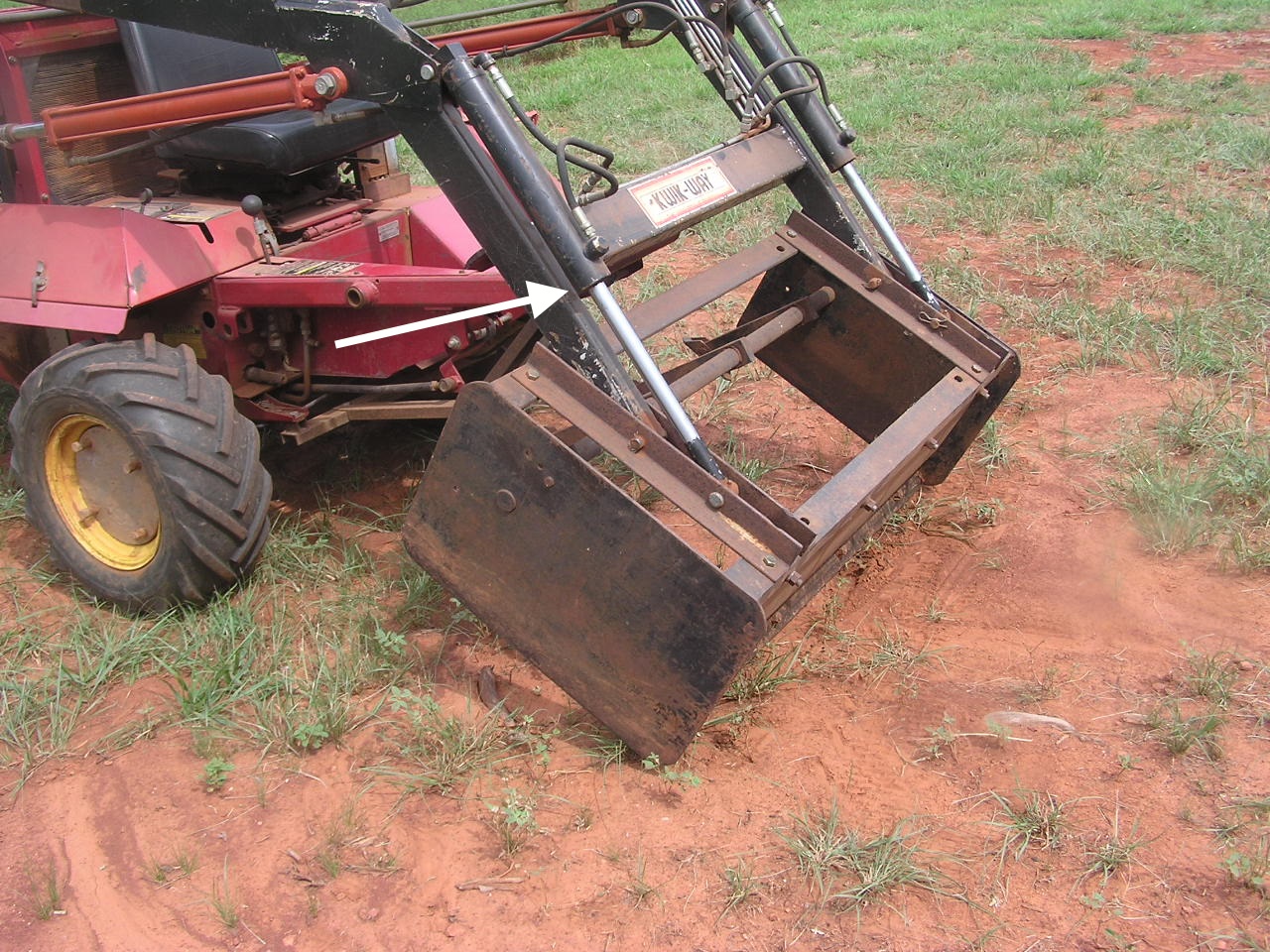

So i have a scat trak 1350 that the front cylinders on the bucket were changed. Unfortunately they are too short and dont allow the bucket to dump fully. Is there a way to figure out the size i need?

Are the cylinder mounts still in place? If yes measure the distance between the mounts with bucket fully curled back and fully dumped. The difference in length is the cylinder stroke required.

they are still there. ill have to do that thank you

To measure max dump length, you need to disconnect the rods. If you go too long the cylinders can contact the arms and bend the rods.
