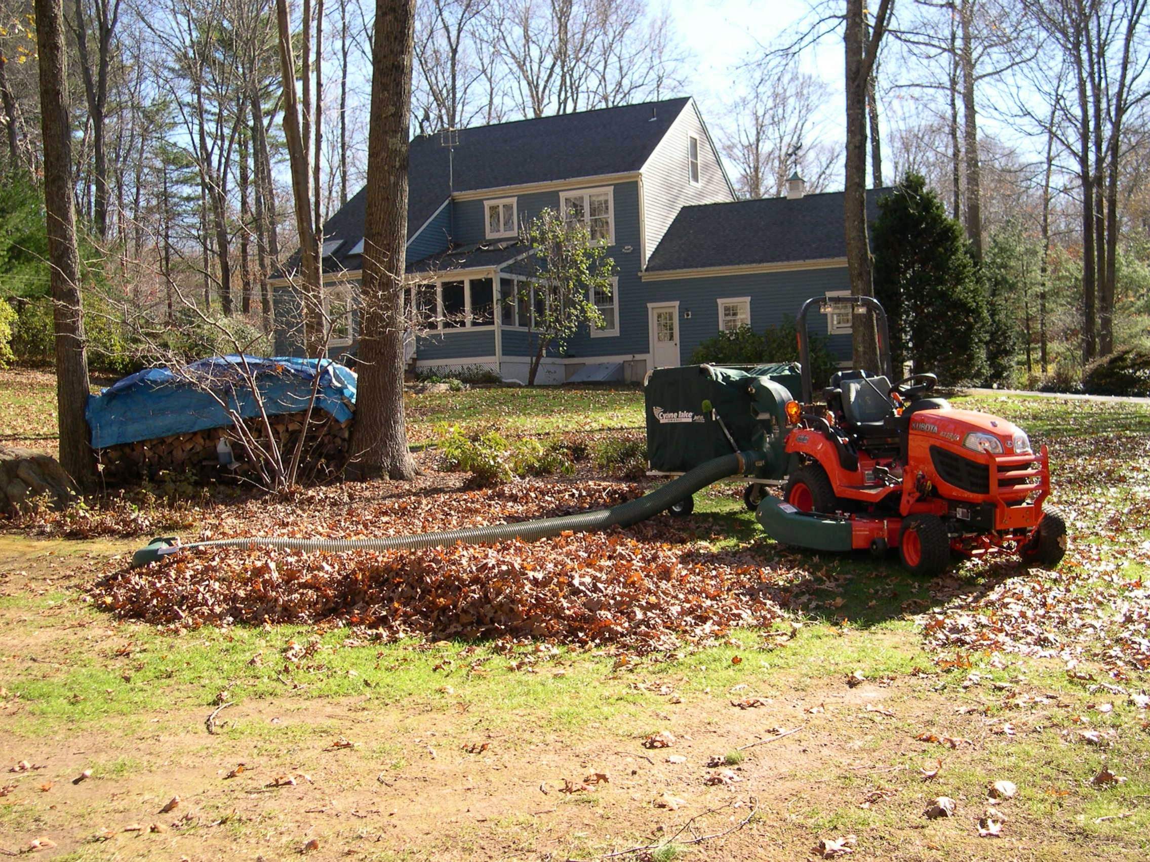

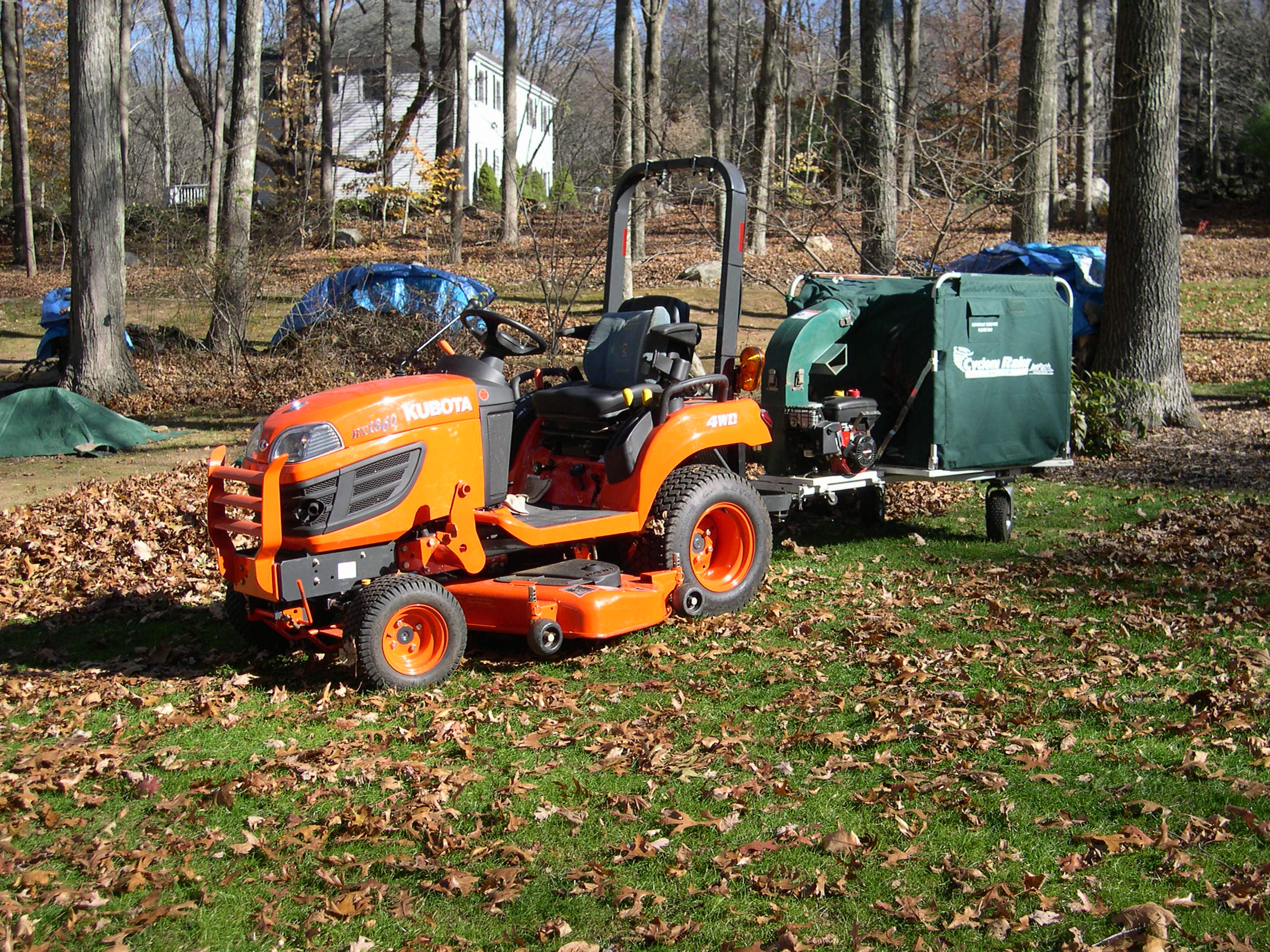

I started with the CR Classic and upgraded to the Commander (next size up) by changing the "bag" out to the larger size, plus some hardware. I use it with my 54" deck on my BX (old 1860 and now BX25) and it works fine. But, I bought mine back in 2004 and the hose size then was 7". I think they've gone to 8" minimum now. I would recommend going up one size to the commander since it empties easier. The classic is square shaped where the commander is wider at the back than the front making dumping a little easier. They always run a one-year, no questions asked return policy I thought (haven't checked recently), so you could always send it back if it doesn't work out. On the other hand, I'm pretty sure you can just adjust your speed if it has any issues sucking it all up in one pass.

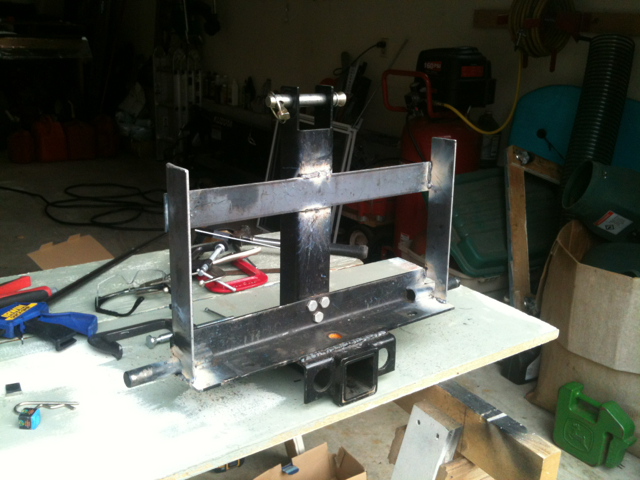

Cyclone rake sells a three point hitch draw-bar for hooking up the CR. It has two pins so it won't jack knife. I've seen where a few members here have made their own attachment hardware, but if you're not into fabricating something, you just need the 3PH drawbar option. I think I paid $38 back in 2008. I've since modified it by welding a 2" receiver onto it and some steel to hang suitcase weights off of. Here's a pic when I was adding the suitcase weight hangers. If you picture it without the vertical side bars and cross-bar, and without the 2" receiver hitch on the bottom, you can see what the CR hitch would look like.
