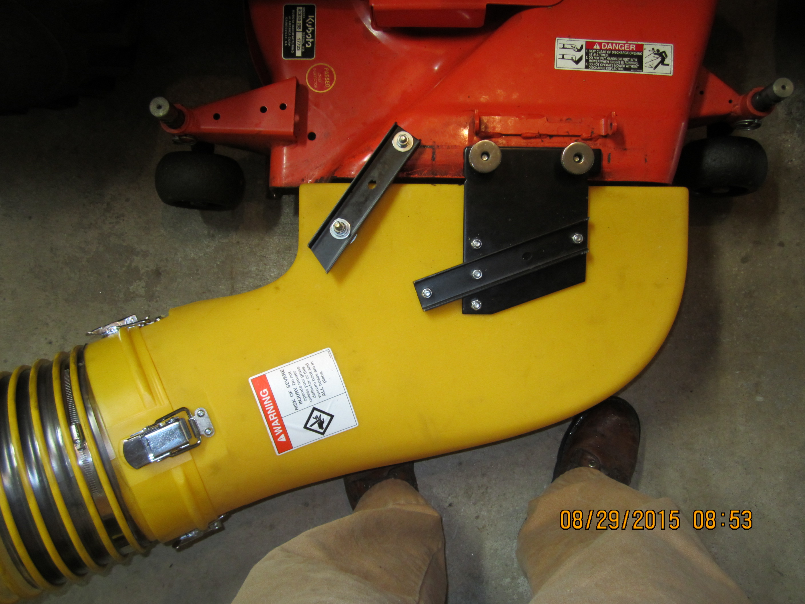

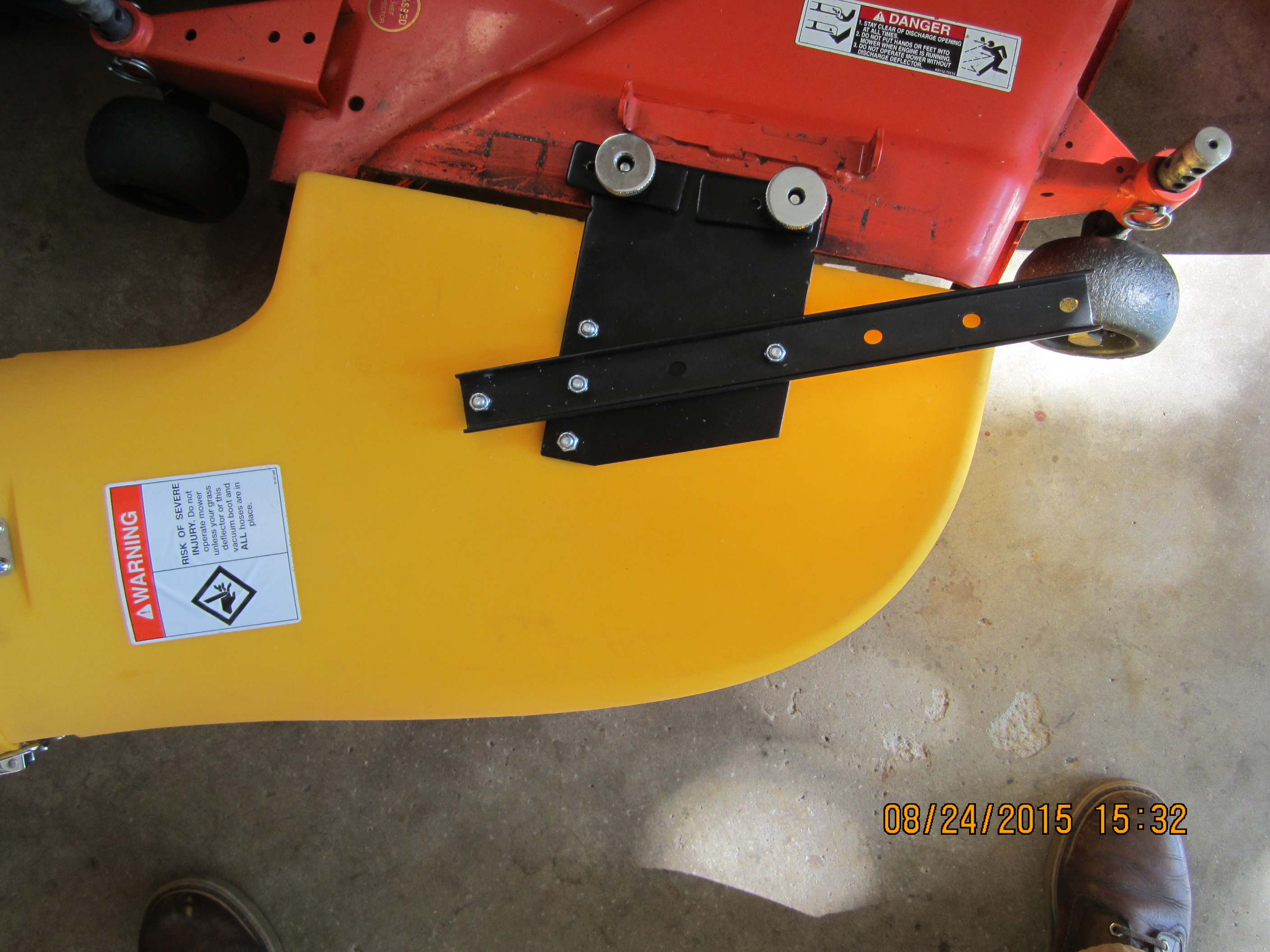

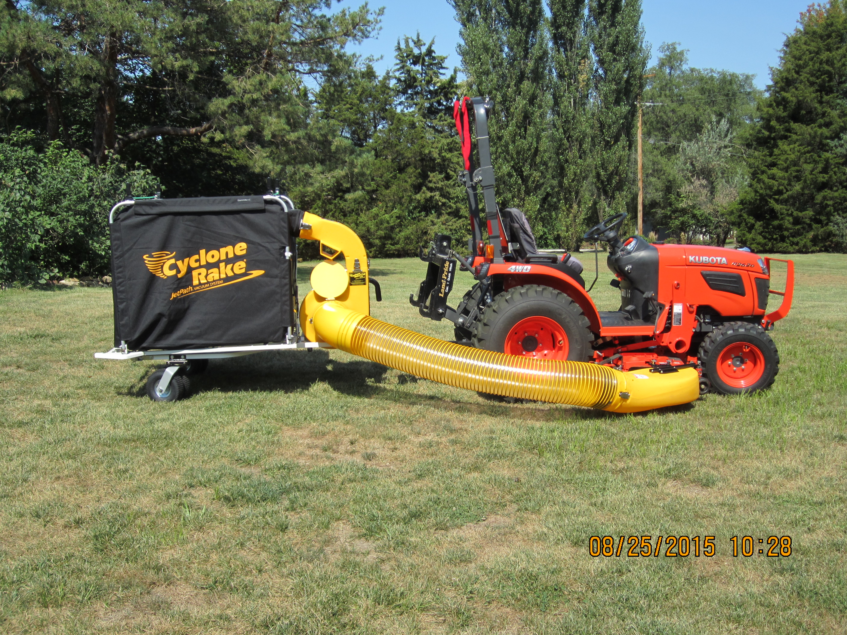

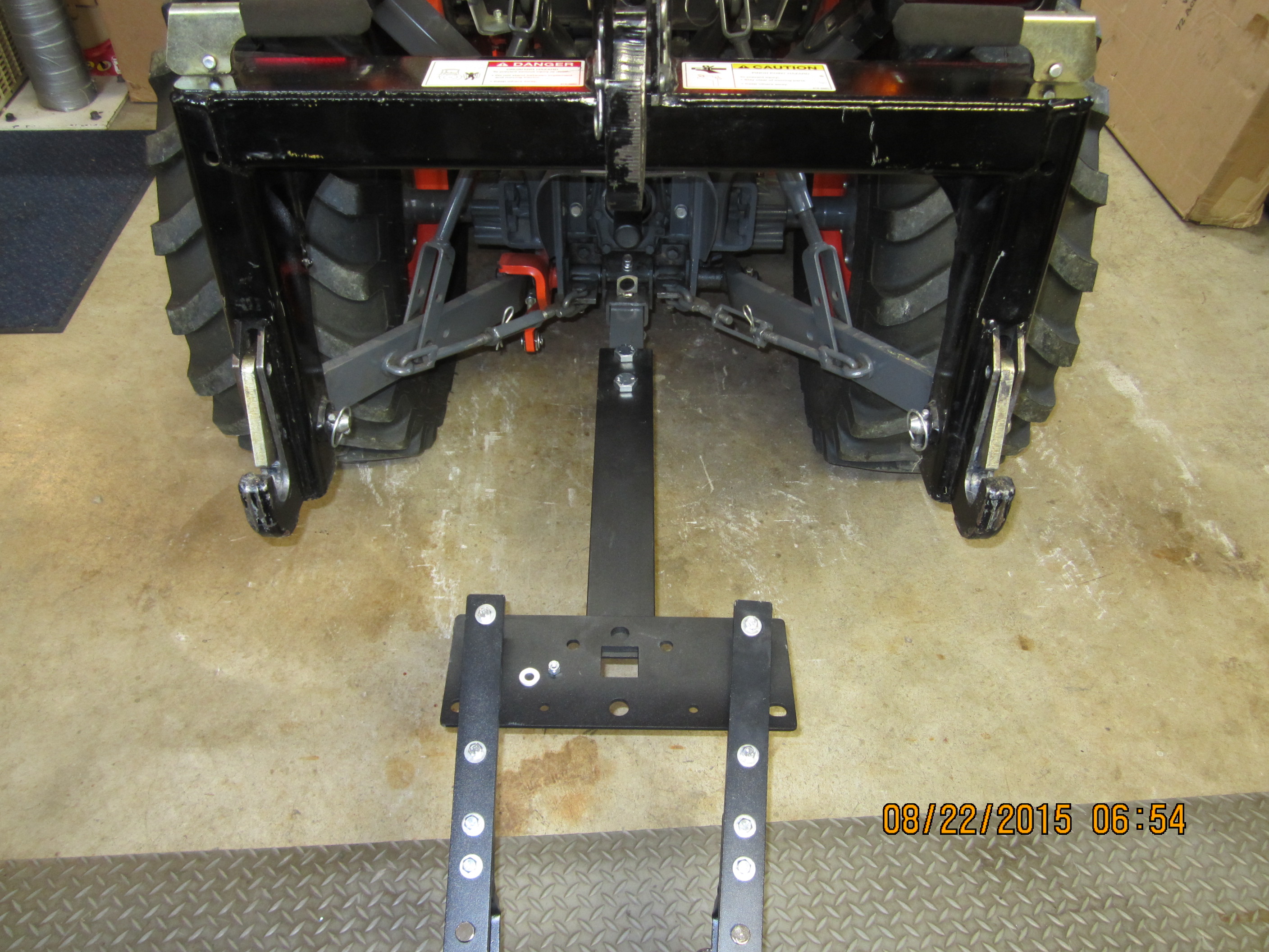

I've had the Z-10 for two seasons now, using it on the Kubota B2620. I found it to be all they advertise it to be. The pull start is easy for me at 84 YO and 150 lbs....and i didn't buy the dump assist gadget. When the Collector unit is stuffed full, it is necessary to rake some of the load out before I'm able to lift for dumping.
Their hitch adapter connects directly to the tractor draw bar and works better (IMO) 027.JPG001.JPG002.JPG than hooking it to my three point trailer hitch adapter. So far I've not used the Power Vacuum or the Unloader unit. Most of my use is for Fall and Spring leaf cleanup and I have plenty of uses for the mulch and a place for dumping. My unit has the double wheels and I store the whole thing assembled in my out building.
Their Customer Service is outstanding. Note that my B2620 has greater ground clearance if that makes any difference. The deck height selector cam needs to be tight or the weight of the deck adapter plus the 10 inch hose may put some serious wear on that cam that holds the mowing height in place...in my opinion.
I did make a few of my own modifications to the MDA (Mower Deck Adapter) for fitting to my satisfaction.003.JPG
