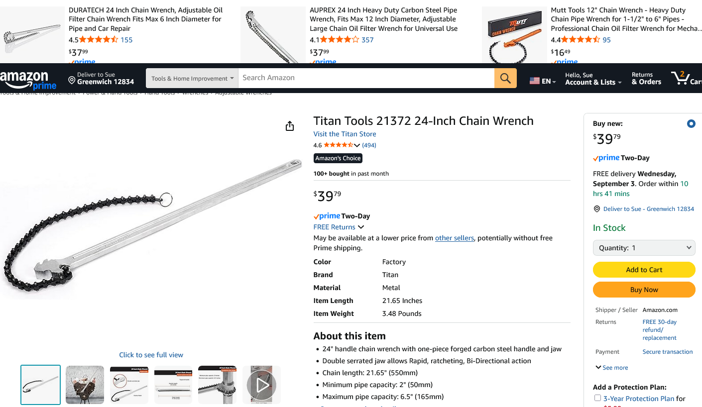

Skip the filter wrench and get a large set of channel locks for the filters.
