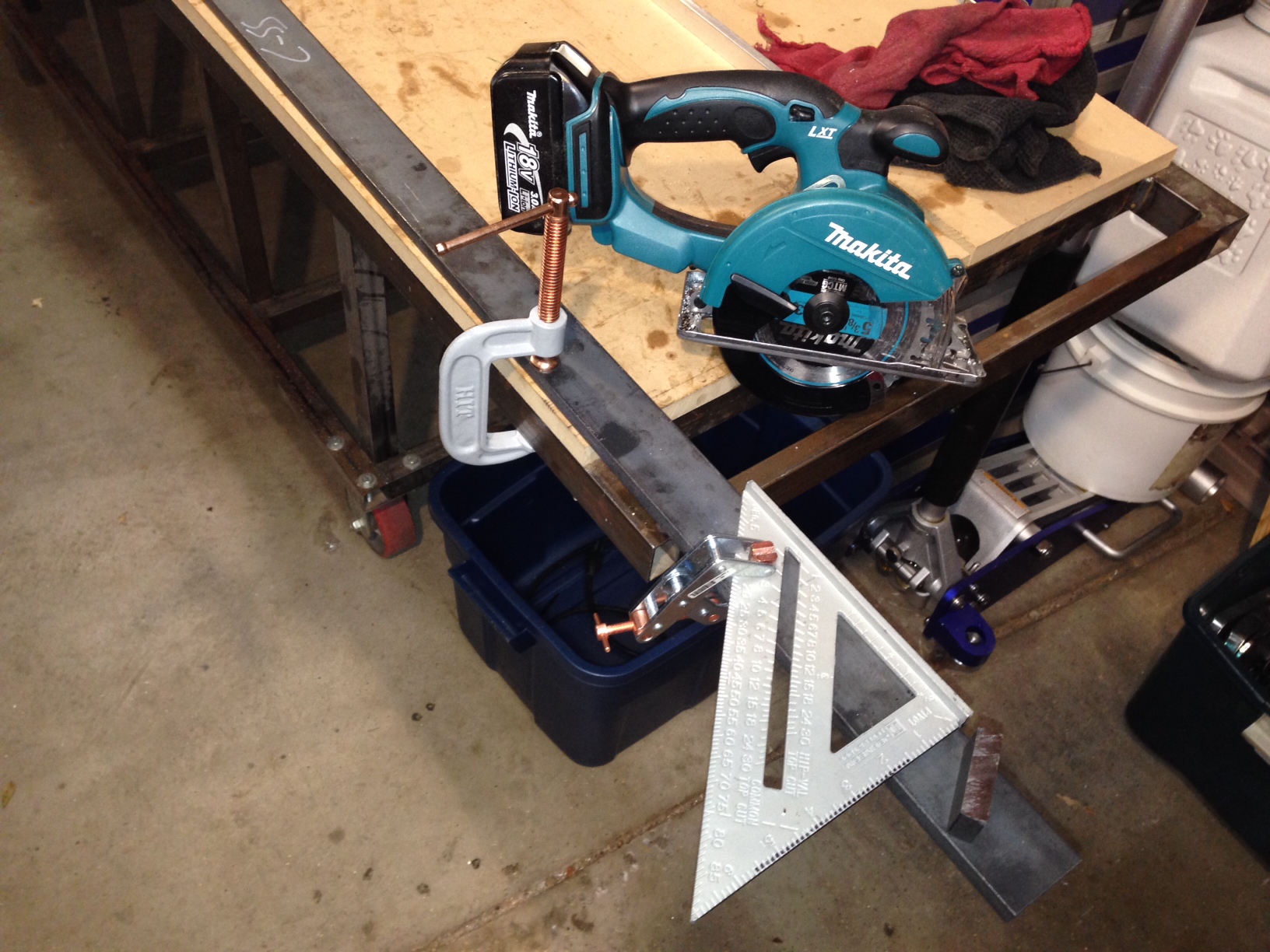

There are several hand held circular saws specifically for cutting metal. Milwaukee, Jancy, Makita, Rage, probably others. I use this Makita:
   / Cutting up to 1/4in steel - what do you recommend? #9
Forgot about the Rage saw - I have the handheld one and it cuts good.
Face shield mandatory! Yikes those shards can be sharp!
