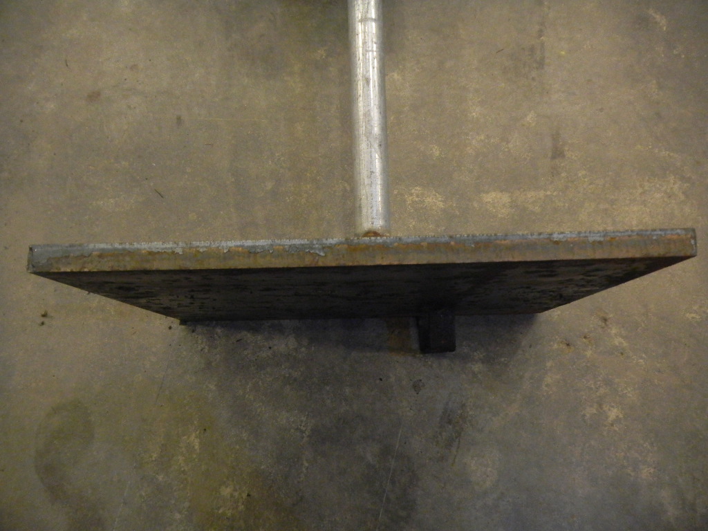

/ Cutting torch pressure #2
I run 40-PSI oxygen when cutting.

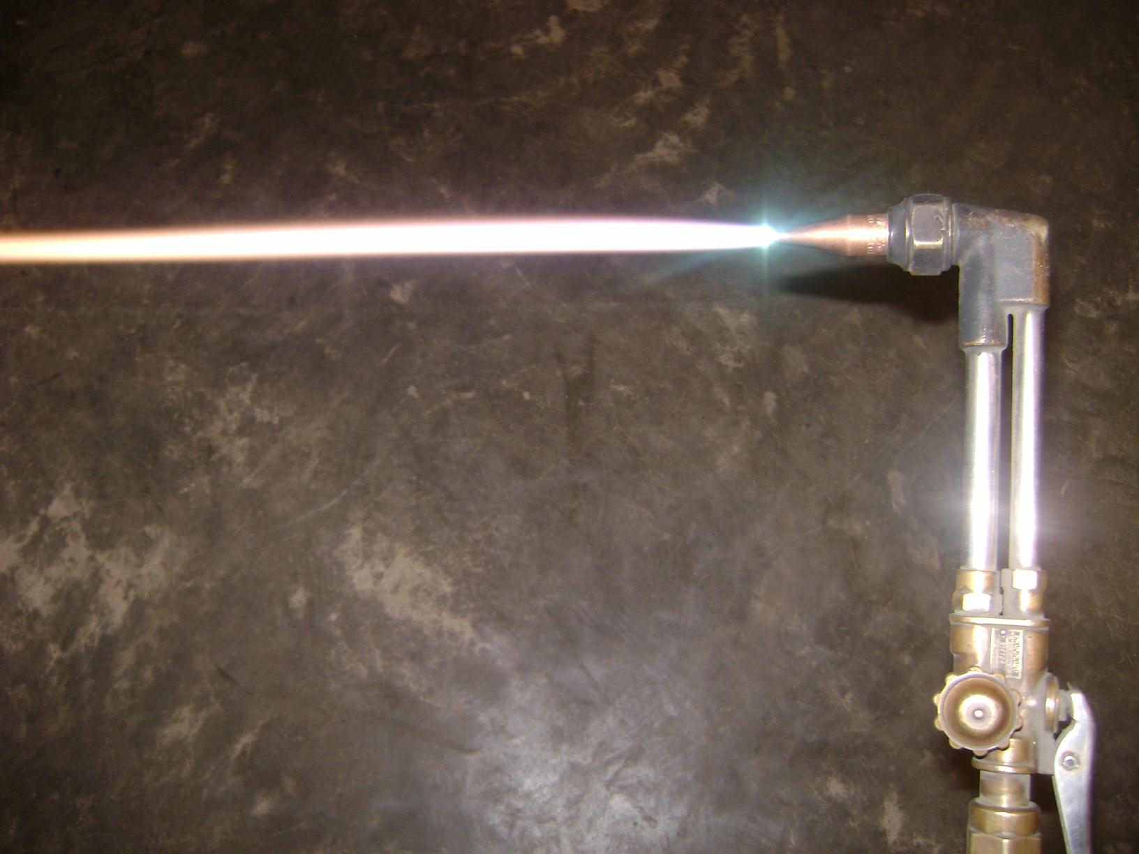

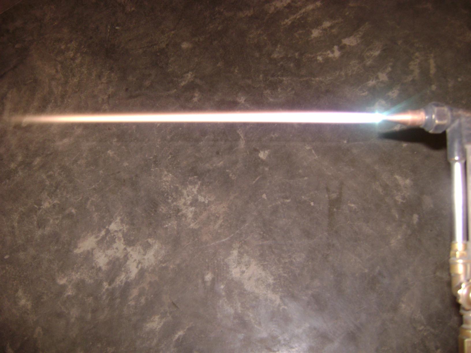

/ Cutting torch pressure #5
I find all torches have a different sweet spot. I adjust the torch to a neutral flame. First picture. Then I slowing push the oxygen lever until the cutting cone goes out far as possible from the tip, and sounds like a jet engine. That is the sweet spot, second picture.
