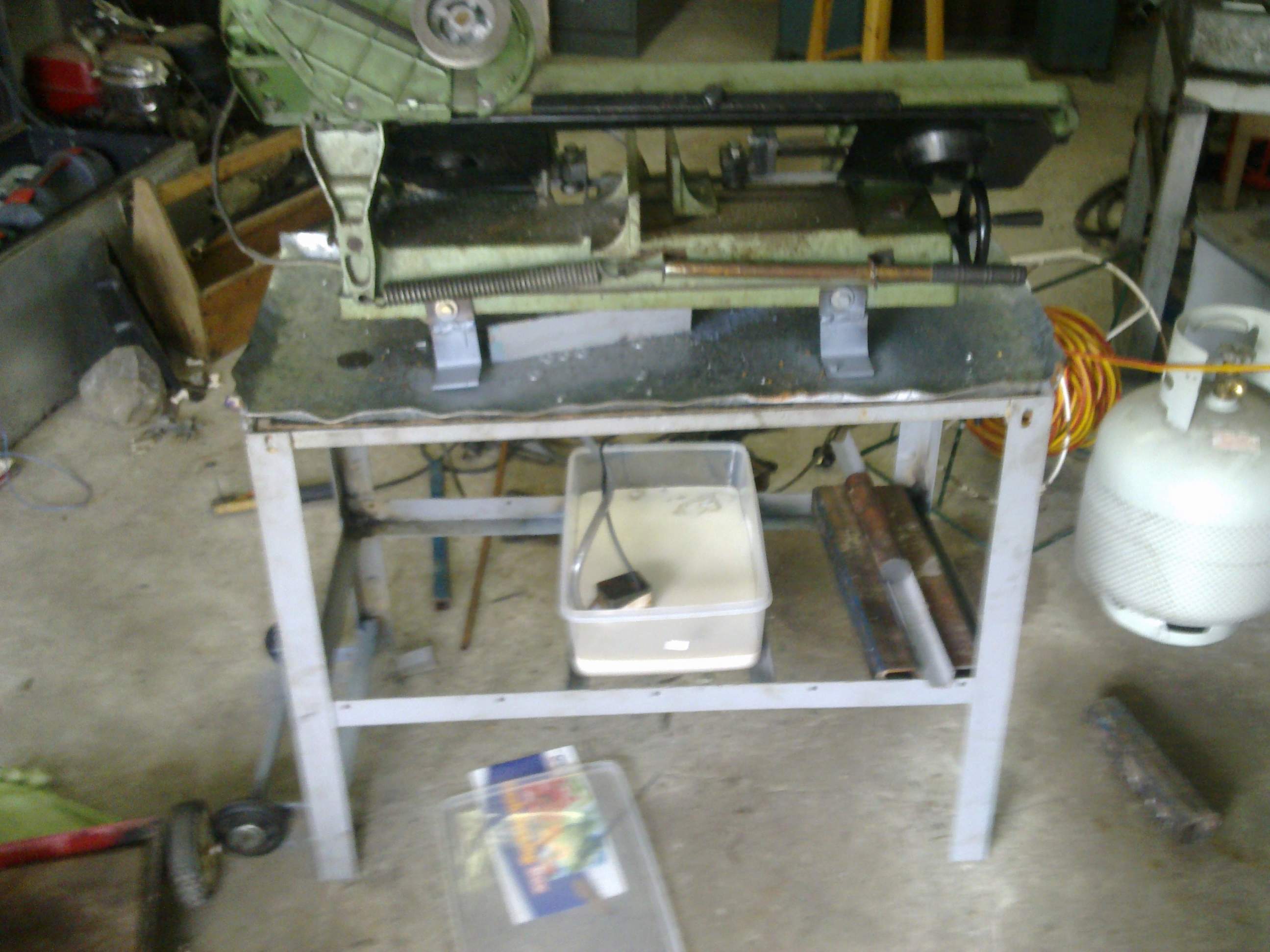

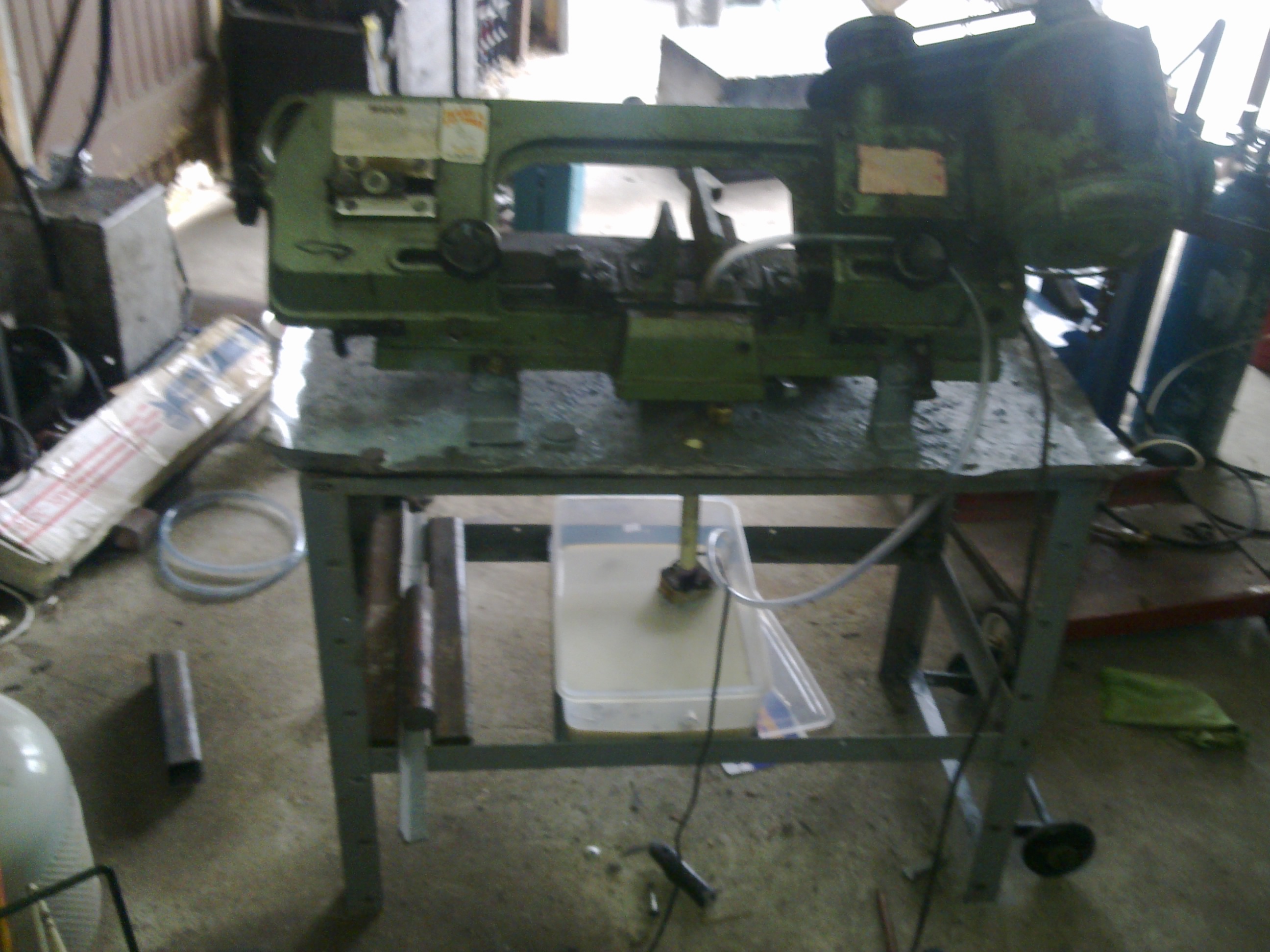

i built on for my bandsaw and plan on making on for my drill press lathe and mill. i just made a drip tray under the saw and put a container with a pond pump on the stand

Bob Cat Fan, what kind of cutting fluid is that you are using ? It almost looks like water. And what holds your plastic tube pointing at the right place and does it have a nozzle of some sort on it ?

i am using soluble cutting oil which you mix with water. the plastic tube i just cut down the middle and it just sits over the top of the blade.but when i make one for my drill press i will buy a nozzle from my local tool shop for $20 they are flexible neck and magnetic base.

it have been using this setup from a bobut 2 months. as for odor and rust the old school non synthetic stuff will smell but this is fully synthetic. i don't know what it is called but i came from penrite and the engineering shop decanted it for me.rust has never been an issues i have not seen any rust from using this coolant.
