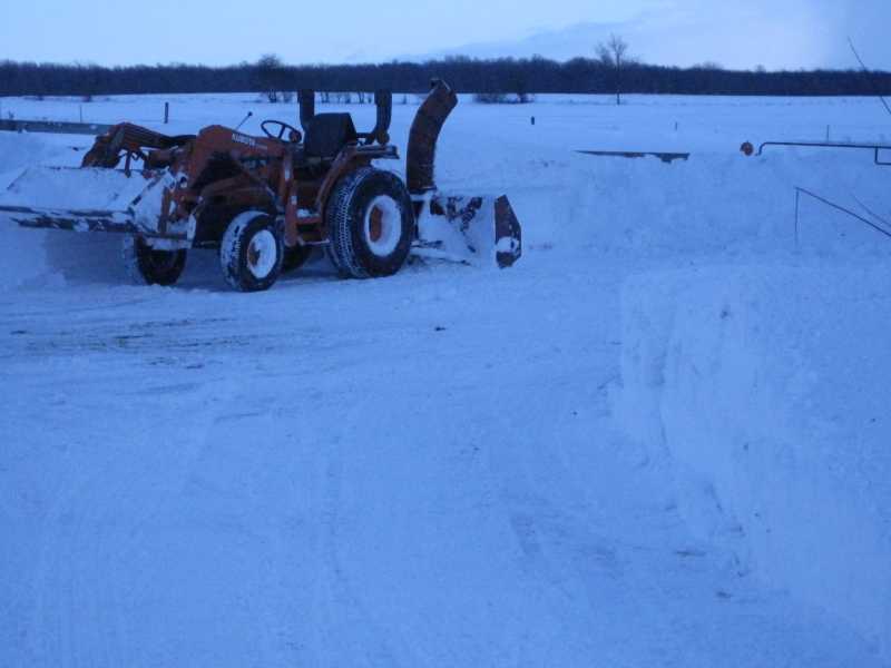

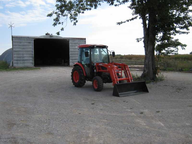

Well Grumpy old man I have been moving snow for a few years in my 40 years. Some things make life allot easier hence the new DK45SE cab with loader. You have to rely on the skid plates until there is frost in the ground and even then it still helps with keeping the lawn repairs to a minimum.
Not sure where your from but around here we can get 2 feet of snow and no ground frost. Then the snow acts like insulation and the frost will not go into the ground. If you keep it clear in time frost will go down into the roadway.
Picture of two years ago with the old kabota its cutting edge was stock and the new iron.
Cheers Don.

Please don't take it the wrong way but if you have been plowing snow for any amount of time you would know these things ,your post read like a new tractor owner and that machine should do anything you want it too , from the picture it looks like bone flat land and a gravel drive !is there no float position ?
