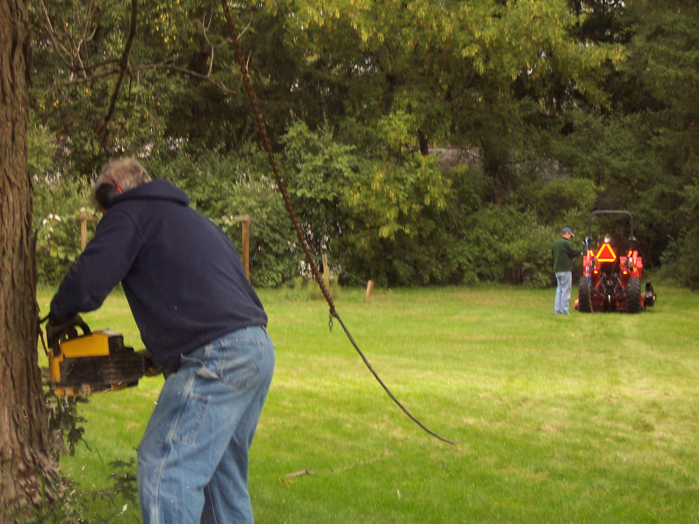

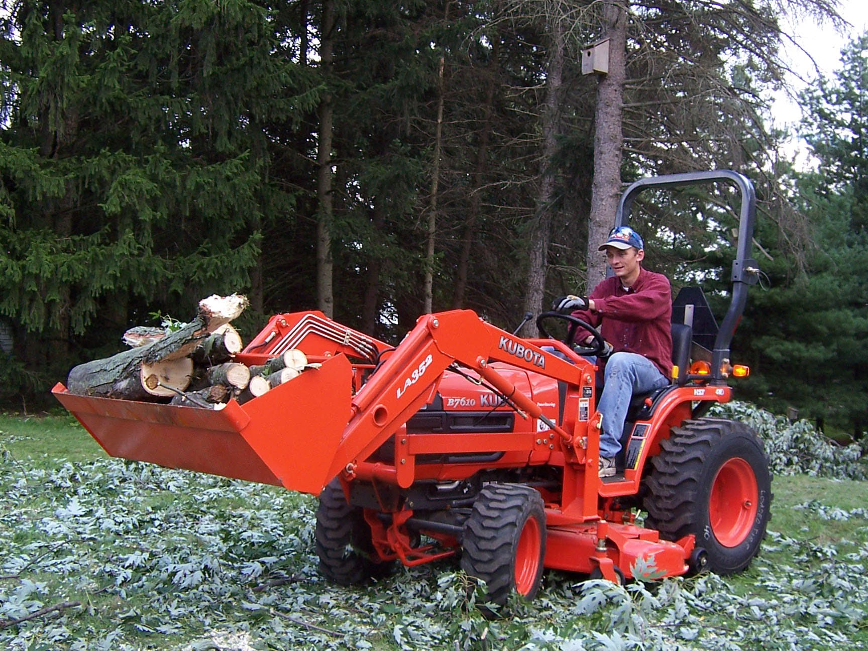

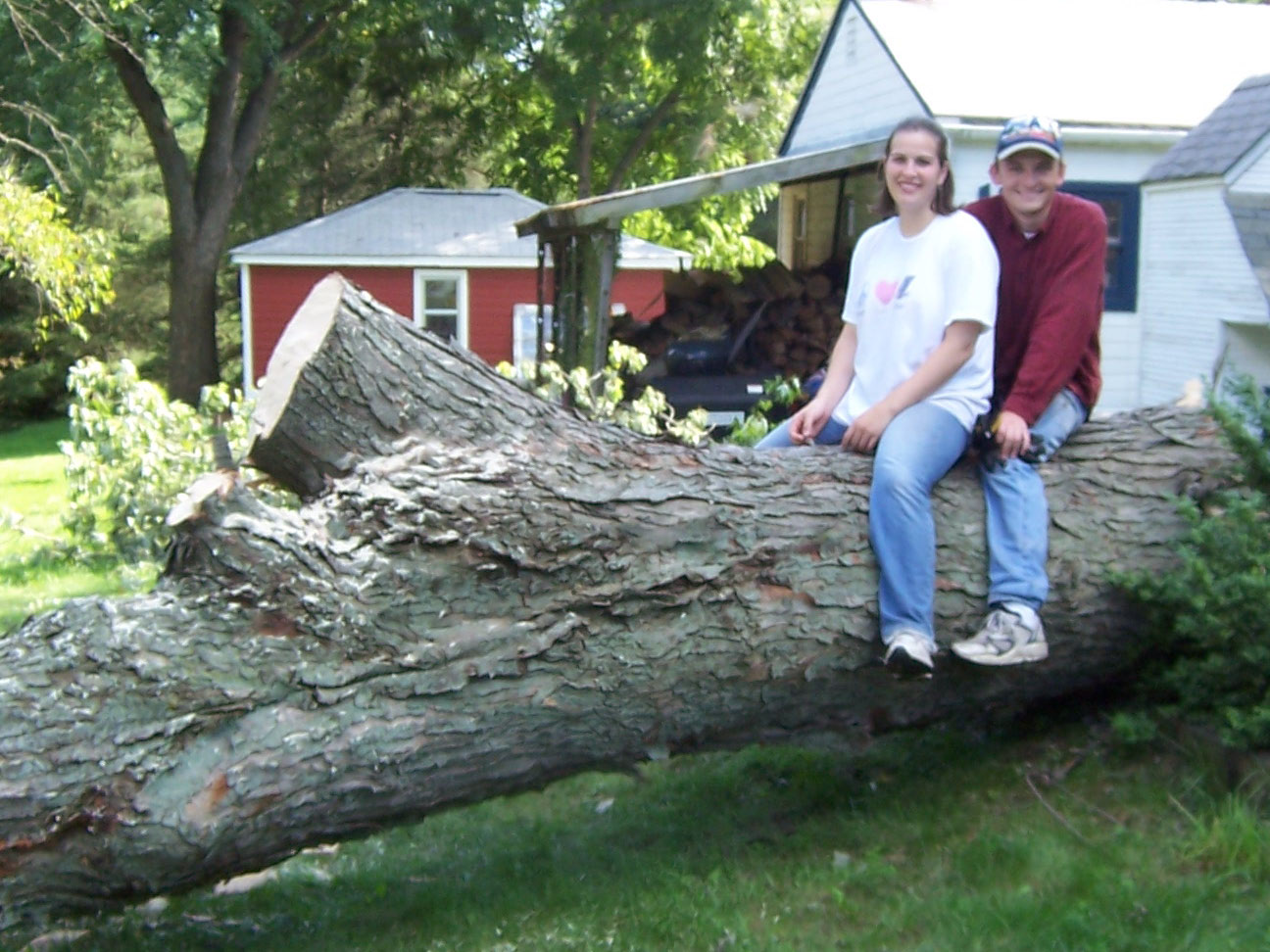

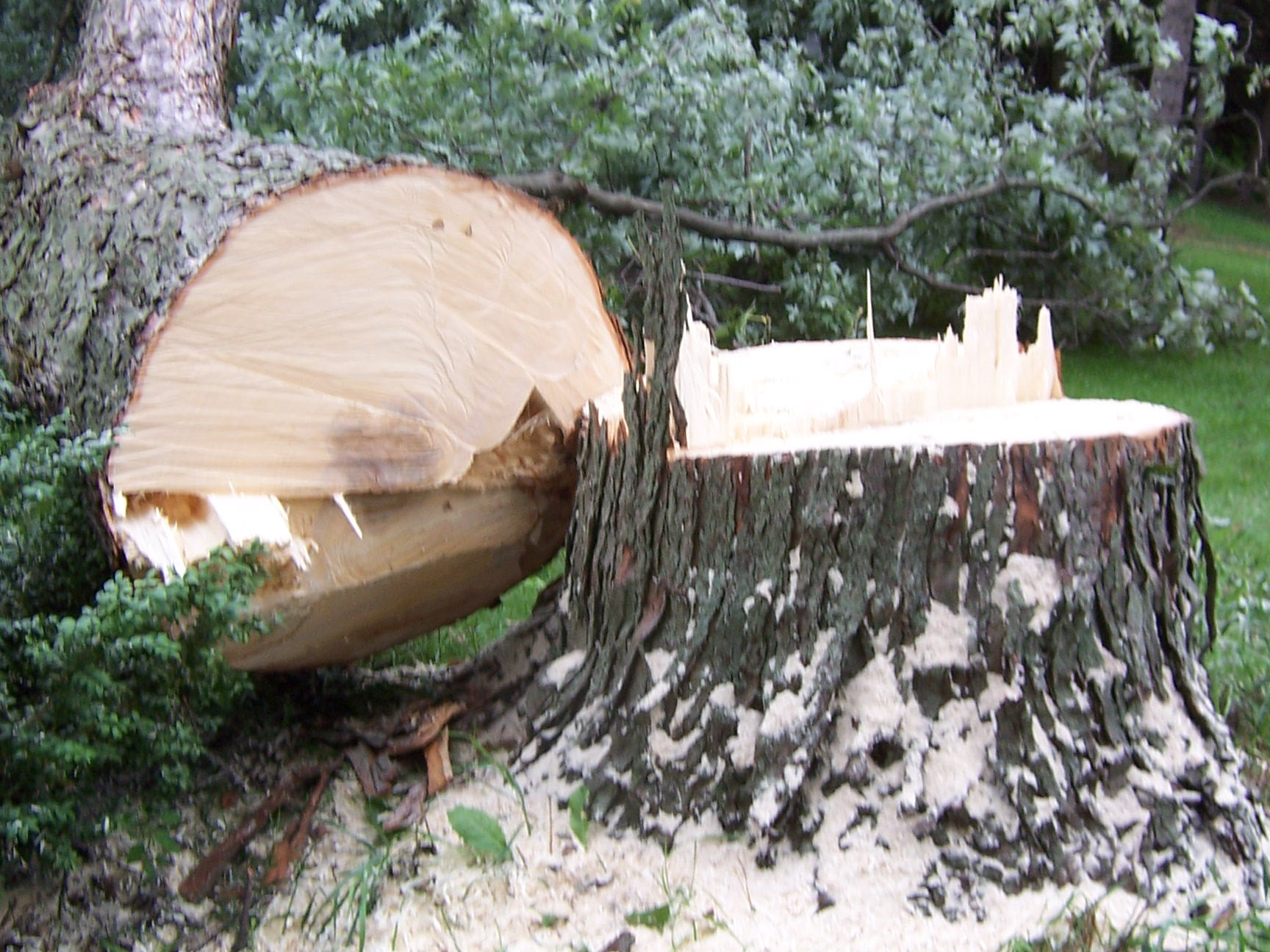

This tree was 15 feet from my house 20 feet from my garage and wires plus the large branch overhanging the house was looking sick. The number of leaves had been declining and some of the smaller branches were dying.

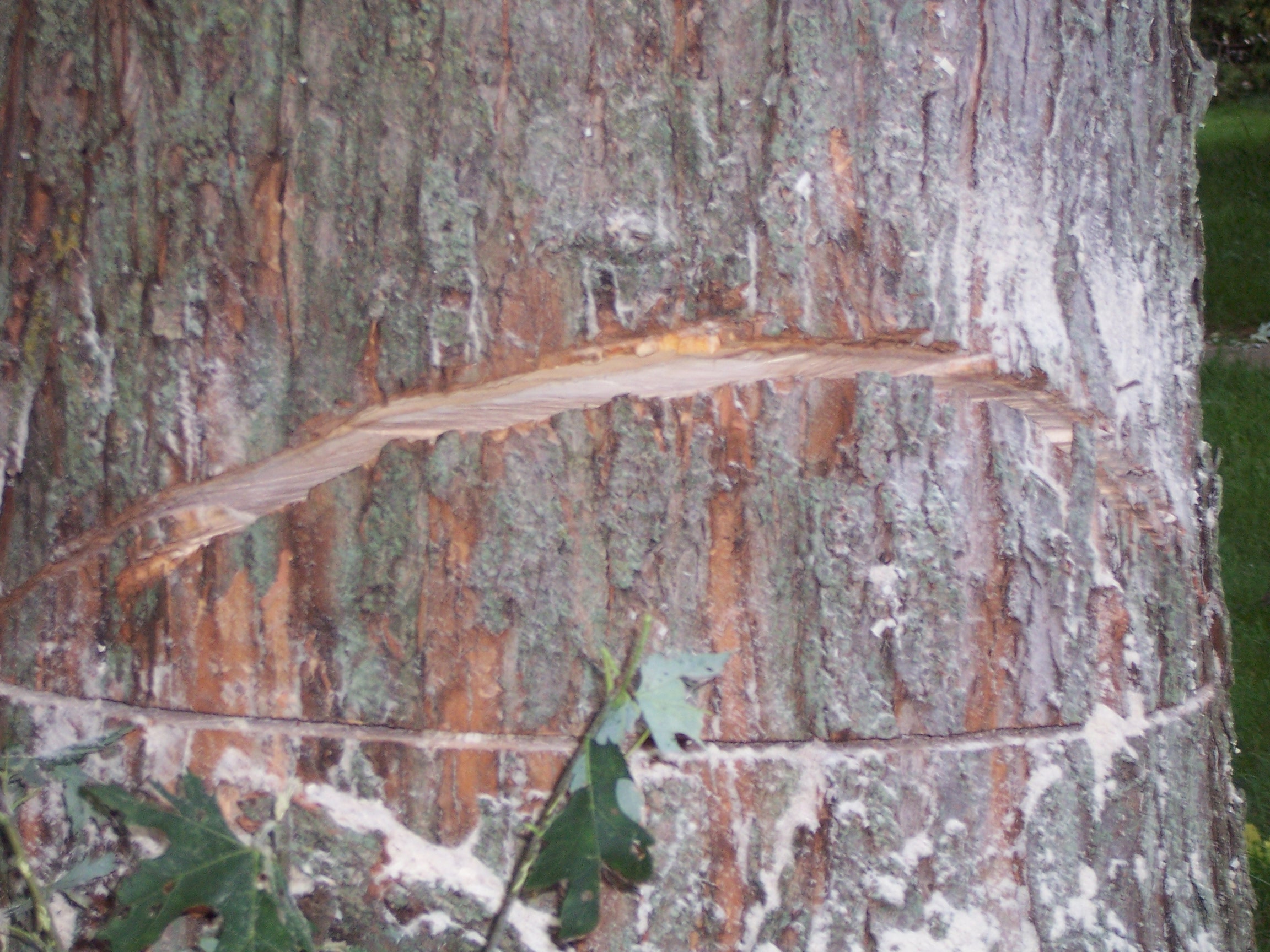

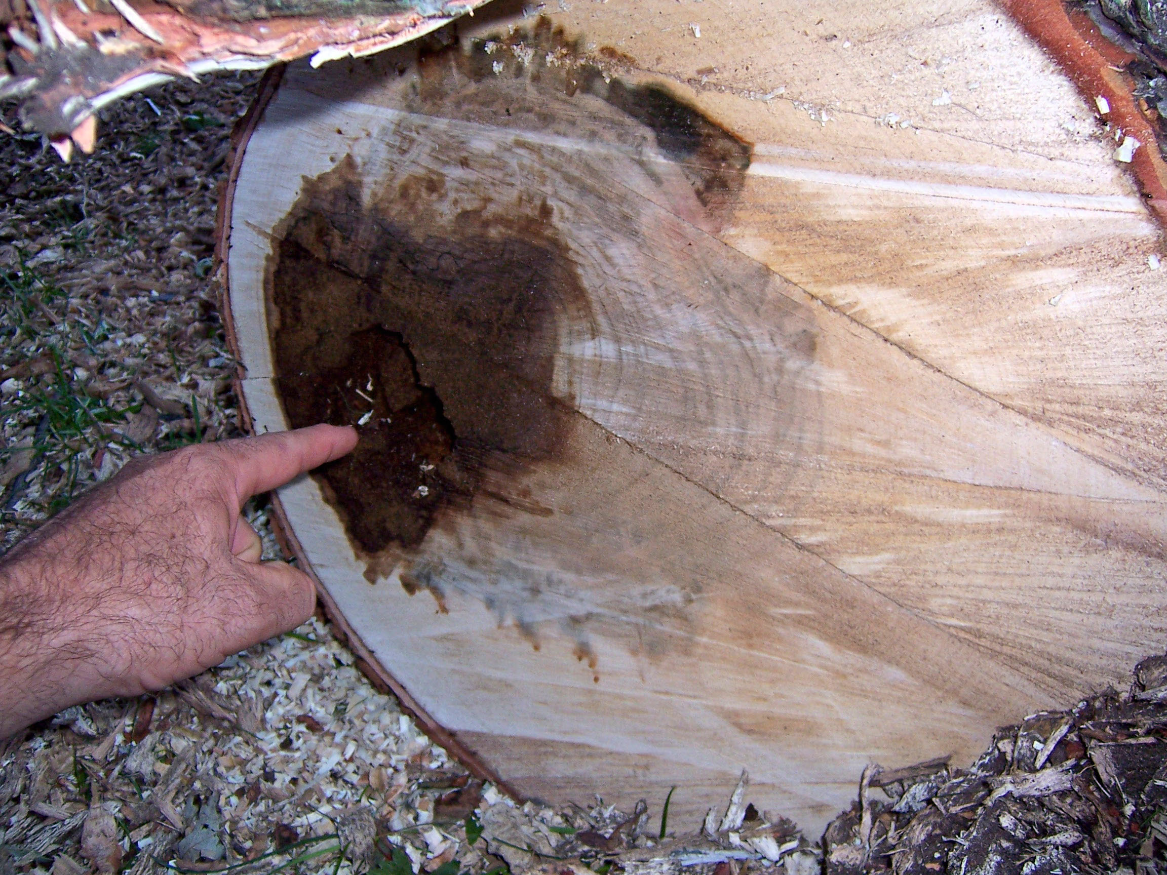

I started by removing as much weight on the house and garage side by cutting all the branches I could reach with a 28 foot ladder. I then put chains and cable as high as I could get in the tree connected to my B7610. The tree was 75 feet tall so I used every chain I have. I then cut the birds mouth on the side I needed the tree to fall to. Then I made the money cut even with the birdsmouth while my trusty Son in Law pulled with the tractor. As soon as it started to move I backed off and down it went. Now the work starts, renting the chipper and cutting all the fire wood. Using the FEL sure helps move all that wood. It is invaluable moving the logs that are 3 feet thick. At 80#s per cubic foot some weigh 500#s. You can see the rotten center of the branch that was overhanging the house.
Pay attention to the health of the trees near buildings and wires. I saved myself from a potential disaster.

You got a good start on next years wood supply once you got it cut and split also stack...by the looks of the tree couple good fel loads should fill in the compress areas...agree about the fel,for its almost better than a third hand also save on the back and legs.

I would think you have some "Furniture to be assembled" there!:D

Unless you just wanted rid of the tree, you had many years to go before this tree was a danger. Maples will become completely hollow with only a thin ring of limb inside the bark before they break off. This tree was cut in it's prime. I hate cutting them when they are hollow clear down to the stump. They don't respond to normal cutting technigues. I'll bet it feels bare in that part of the yard now!!! :)

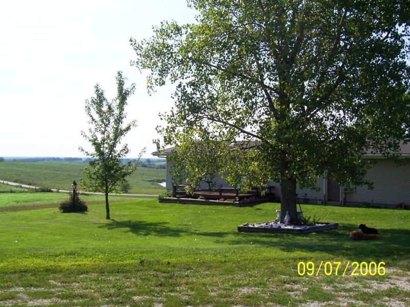

To give you an idea of what you have lost, the small tree on the left in this picture is a maple I planted when my grandson was born. He's fifteen now.

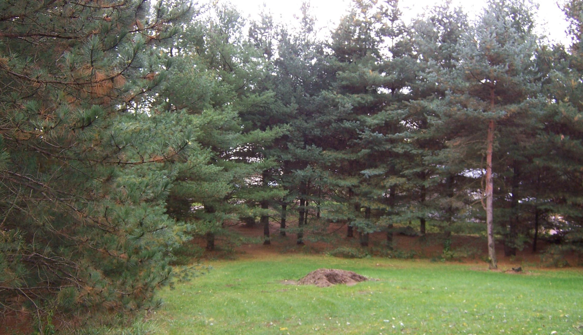

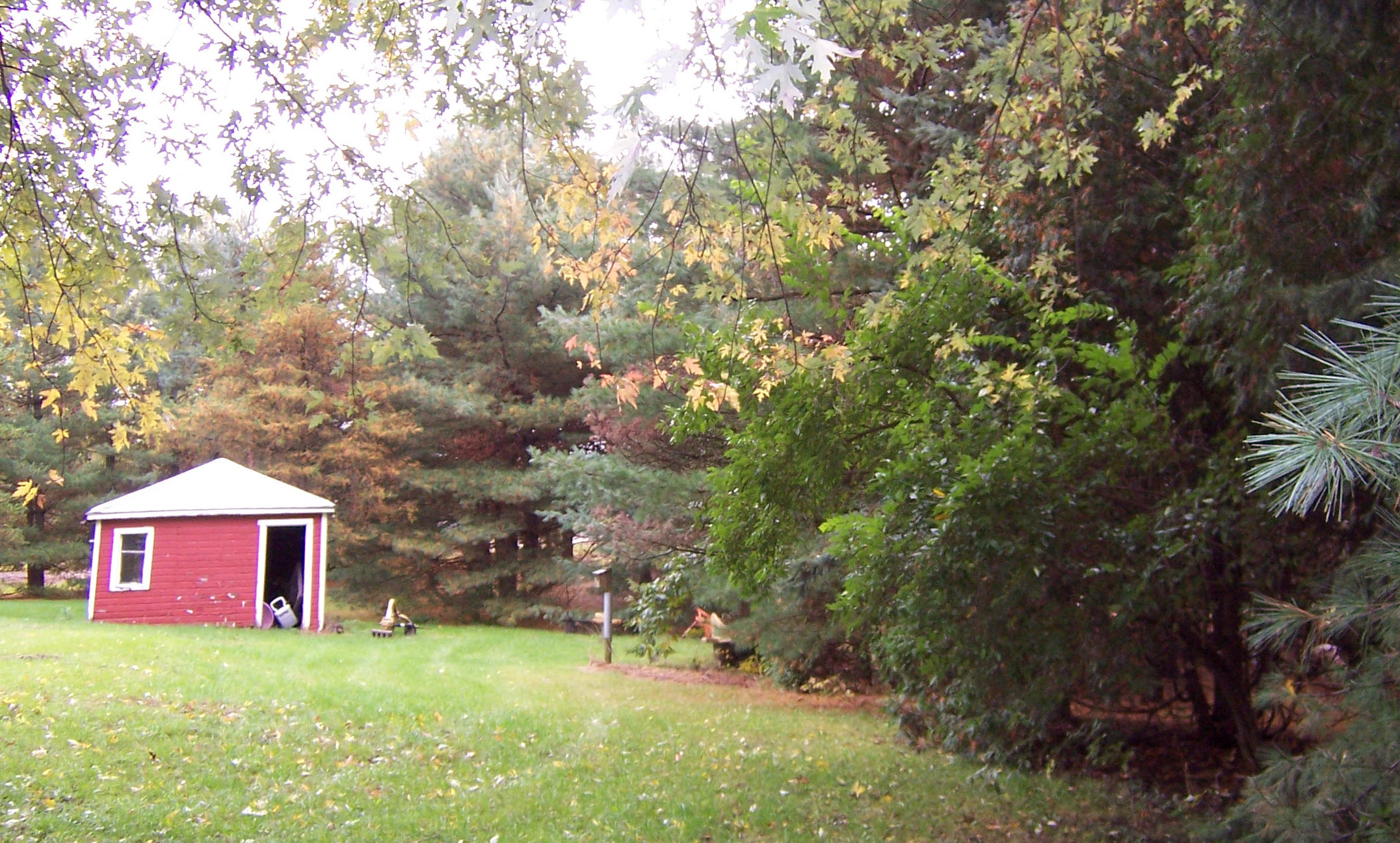

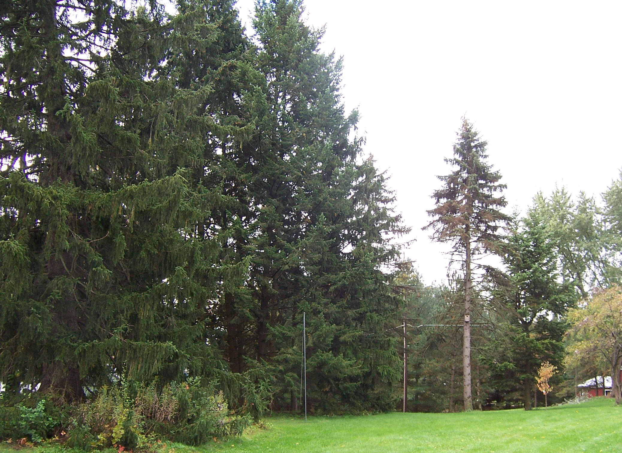

In the 30 years I have owned this 180 year old farmhouse I have planted over 300 trees consisting of 40 different spieces. You can see in the attached photos some of them are 16 inches thick and 50 feet high. I wanted to insure that my little forest would survive any blight like Dutch elm disease or the emerald ash borer so I diversified my plantings. It turned out to be a prudent move since I have lost all but 4 of my Scotch pine in the last few years. Two years ago I lost all 4 of my ash trees. Every year a few die off. This year I lost a scotch pine, norway spruce and two white pine. I just planted two flowering cherry and 10 Fraser fir this fall. I will do another planting this spring. I fertilize twice a year and have watered during a drought we had a few years back. Other than that plant them and mulch. The county soil conservation district sells trees twice a year and I purchase them at a very low cost and so I usualy plant when they sell their trees. About $00.25 each the last time. Some of the more unusual spieces I have ordered over the internet and have paid as much as $5.00 each.
