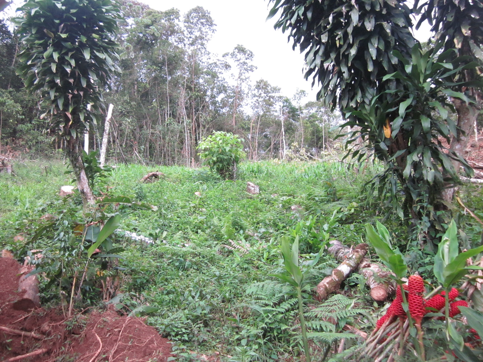

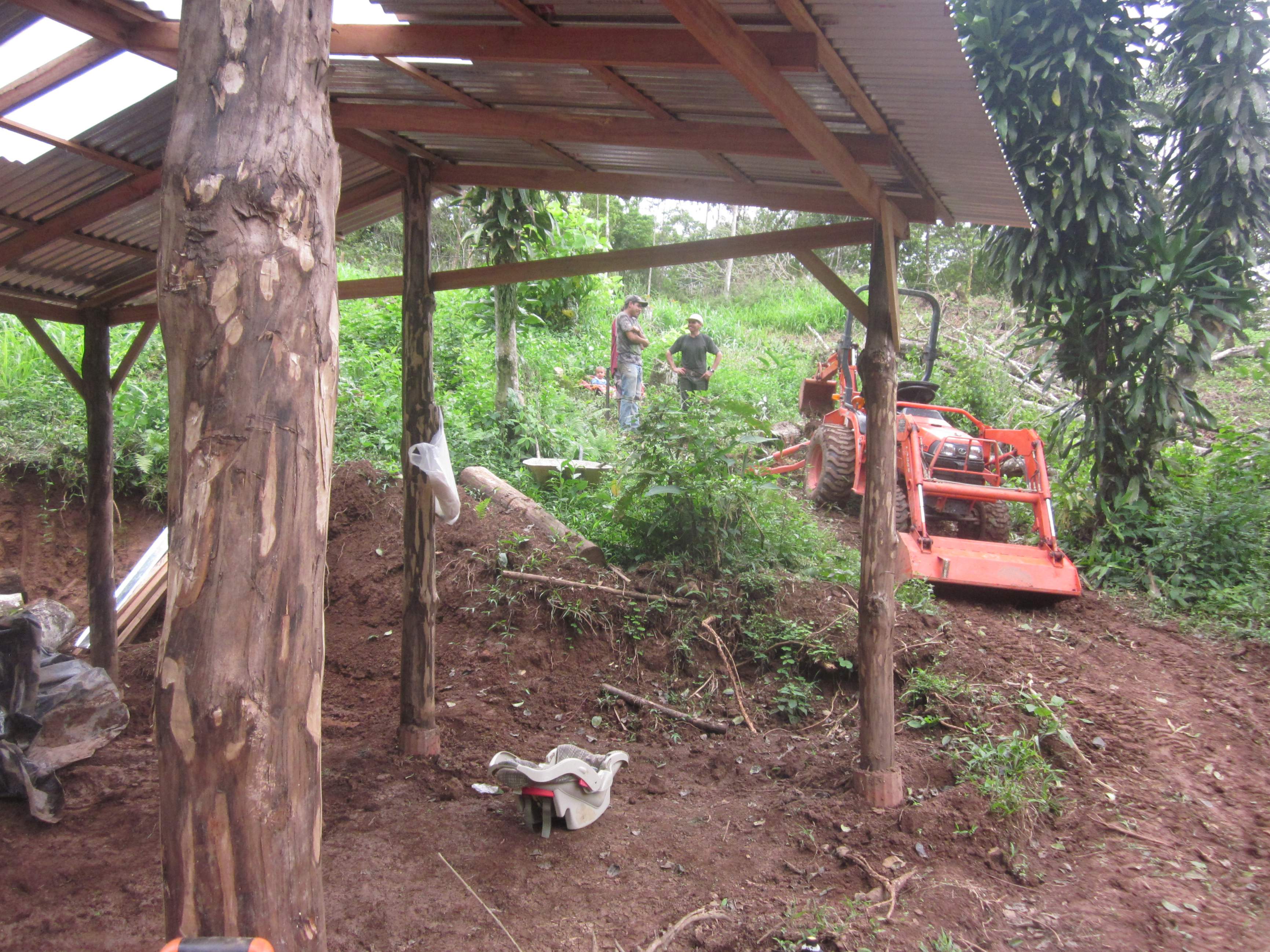

Hello, does anyone have any pointers on how to cut an access road/driveway going across and up a somewhat steep slope? Attached are a couple pics of the slope that I happened to have around to kind of give a better idea of the situation. The one that has the tractor backed uphill on a cockeyed angle is pretty much exactly the path the driveway is going to take, we were digging out a pesky tree stump with the backhoe right then, lots more pesky tree stumps to dig out still... Since then I've dragged a lot of sawlogs down that way so its becoming a compacted path of sorts.
Eventually this is going to be the driveway to a house site a little further up, itエll probably be about 40-50 meters long or so when done. Like I said, its becoming a sort of navigable compacted sorta smoothed out pathway, but it remains really cockeyed and itエll have to be leveled out side to side before itエll be a suitable driveway for the family SUV. The tractor is kind of new to me and Iエm still learning how to drive it, and every time I try to level the road out or clean it up I make a worse mess of things.

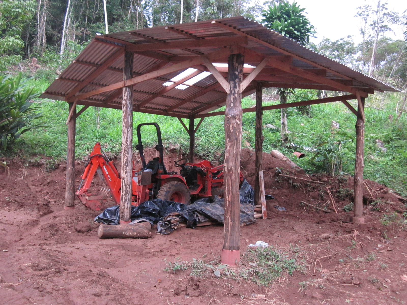

All weエre working with is the Kubota with the loader and the backhoe (and hand tools), donエt have access to any grader blades or box blades or any of the other attachments that are commonly used to make roads. The tractorエs pretty light so at first whenever I tried to do any scraping or grading with the loader bucket it would just skip around on top without actually doing anything, and if I tried to really dig it in then it was making a hole and not smoothing anything out. Have since welded a tooth-bar/rake thing and bolted it to the loader and that makes it much more effective for scraping up a top layer of dirt in an orderly manner. Havenエt really adressed the driveway issue again since installing it, though. Right next to the tractor shed is a flat spot where I could begin from to try and make a controlled level scrape with my new improved tooth bar loader, but that would be working uphill, which I dunno if thatエs how things are customarily done. Itエd also be tricky. Iエve thought about going up backwards and using the backhoe to scrape dirt off the uphill side, which could work, but thereエs a big possibility of just making a mess too. Iエve seen bulldozers a lot bigger than my 23hp tractor make roads around here, and they usually go downhill and they also have a plow blade that adjusts its angle to compensate for slope and grade properly and stuff, its a much bigger, different piece of machinery.
I donエt have a lot of experience driving this thing yet and none with any other types of machinery, and Iエm finding its waaay more difficult to grade something flat than it is to just dig a big hole and carry the dirt away. Does anyone have any suggestions? Thanks in advance, I really appreciate it.

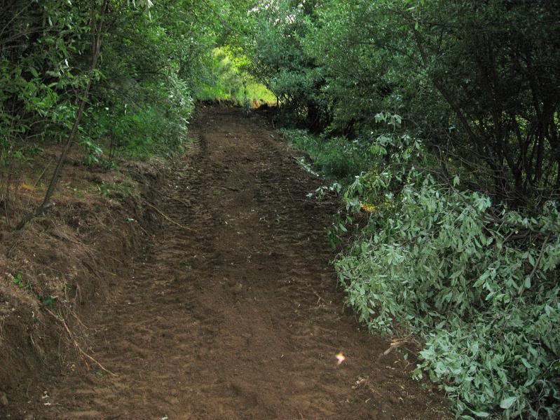

I did about 200 feet on a slightly steeper sidehill using my BX. The two biggest helps were a good toothbar, and keeping a level place to work from.
Dig about half a bucket (left or right side) and dump it on the opposite side. Repeat a couple of times, then drag or push with the bucket to smooth it some. Pack it down with a front wheel. Repeat for hours.
Once I had a level path, left to right. I used a box blade to lower the high spots and fill the low spots.
I had rocks up to 2 ft diameter, but no stumps.

A few tips:
-I like to work going up hill when possible, it's tougher going but safer.
-Basically a road along a hillside can be thought of as a shelf, you have to cut it out of the hillside
-You can start the cut at the bottom with the backhoe, dig away from the upper side and place dirt on the lower side to get a nice level area to start. Then if the digging isn't too tough use the loader to continue digging away at the upper edge and placing the dirt on the lower edge, compacting with the tires as you work your way up the hillside. If the digging is tough you may have to use the backhoe for a majority of the work.
-With a loader and backhoe you have the perfect tool for building a small hillside road, a box blade, scraper blade, etc are only good for the final finishing and not needed for this basic task.
Take a look at this thread I made awhile back on this subject: http://www.tractorbynet.com/forums/projects/197254-road-building-compact-utility-tractor.html

When dumping your bucket try and keep the front wheels at right angles to the slope or as close as reality allows and keep the bucket low. Also watch out for the outside shoulder being soft. If you get onto it and parallel there could be an Oopsie. In the event things get tense drop the bucket and steer down slope. :)

Wow, Guys, thanks lot for all the information. I really appreciate it and it'll help a lot. Especially that other thread, Verticaltrx; lotsa good info and pics there.
I´m gonna try to make the whole thing a shelf, rather than put the fill on the downside. It'll be a pain in the butt to back down each time with a bucketfull, but I can really use the fill in some other spots on the property where we're filling and leveling some depressions. Also, I´m going to be cultivating right below the road so I don´t want a bunch of loose fill piled up making the access difficult as well as washing down onto the crops. It rains a lot (like monsoon) here, so its also better to dig down to "tierra firme" if you want anything to really stay put.
