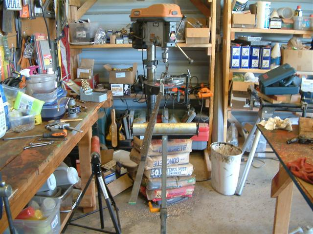

The cutter bar on my MF31 sicklebar (7-ft) was bent so I had to replace it. Got a piece of steel bar stock and commenced to drill about 60 holes (about 1/4" size). It took a few hours at the drill press.
DSCF0006 (Small).JPGDSCF0007 (Small).JPGDSCF0008 (Small).JPGDSCF0009 (Small).JPG
I used the old bar as a pattern, mate drilled the new bar. Drill a hole, insert a bolt, line up the next hole and drill, move the bolt to the hole just drilled, repeat until you reach the end of the bar.
I suppose I could have checked around for a replacement bar already drilled, but the cost likely would have been a shock.
Good luck.
