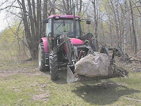

I concur with others & suggest a heavier tractor 10-12K lbs 60-90 HP. The weight will put the power on the ground & get the work done faster. I bought a cabbed tractor last year with a jump seat & seat belt for passengers (big kids ride too.) I had a 60 y/o Aunt ride with doing some logging last Saturday. My cost with options was $30K & change 1/04. Pix is of the loader rock fork & grapple.
www.zetor.com
