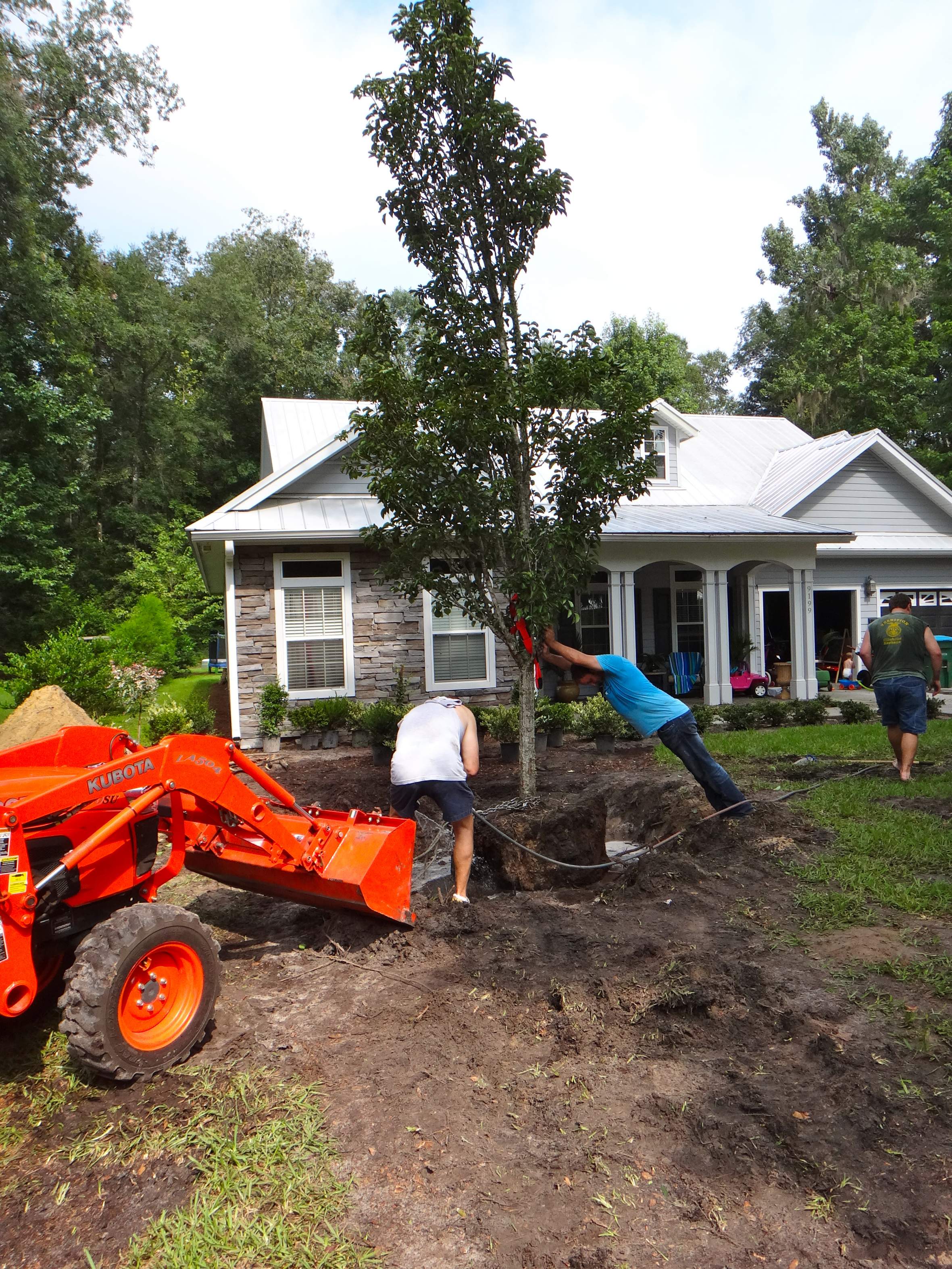

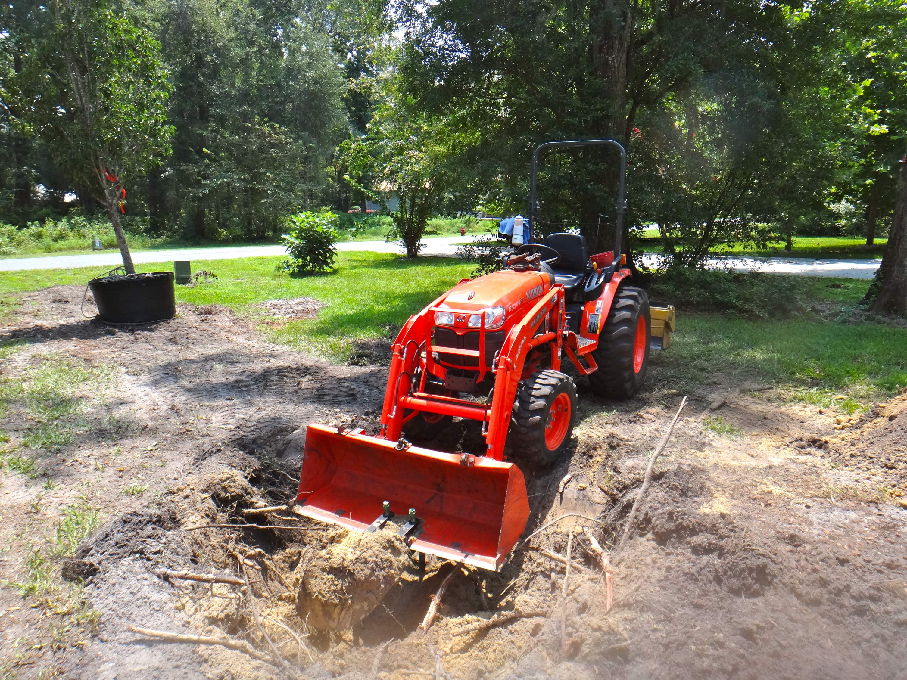

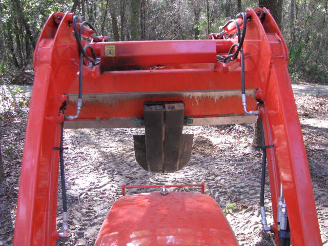

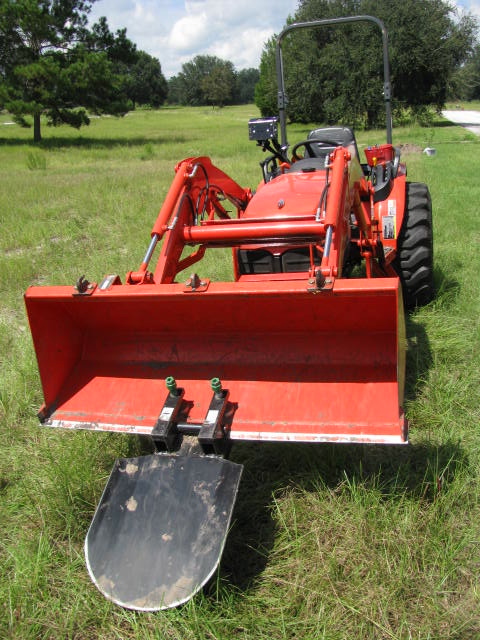

Sounds like what I'm hearing is that weight is much more of a factor than HP in the applications I'm interested in. Also, from you pictures, are you actually digging with that bucket spade?
   / CUT sizing advice #7
1) Yep
2) Yep
I used Bucket Spade for 400 hours on B3300SU bucket, which is the standard 'B' bucket. However, it is better on optional L2296 Round-Back Heavy-Duty bucket available on 'L' series. L2296 comes with highly desirable SSQA (Skid Steer Quick Attach) feature.
