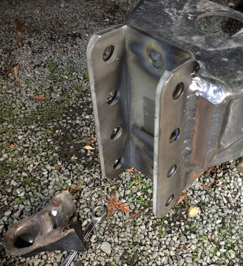

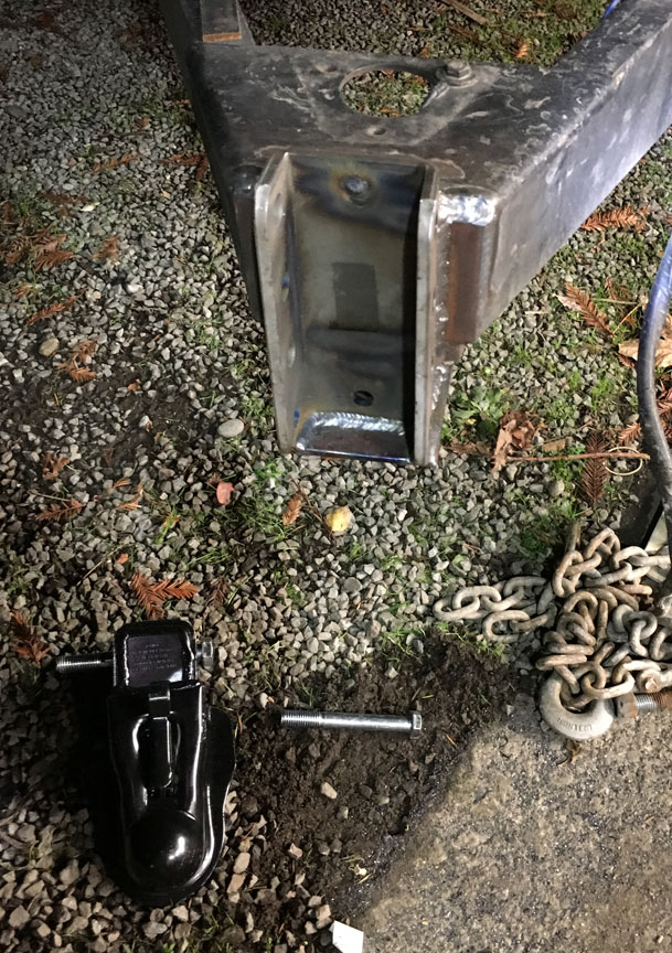

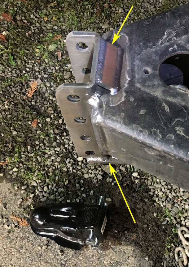

My dump trailer coupler was damaged a little and was difficult to get it coupled. The locking mechanism didn't want to slide into the closed/locked position. From looking at the scars below, I thik the trailer was backed over an embankment, and the ball or tongue bent the mechanism.

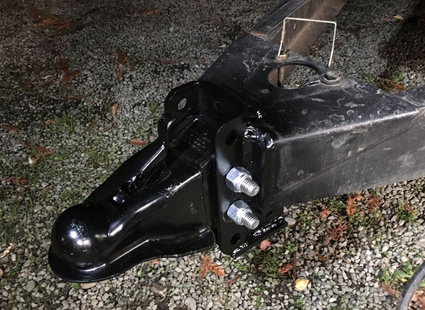

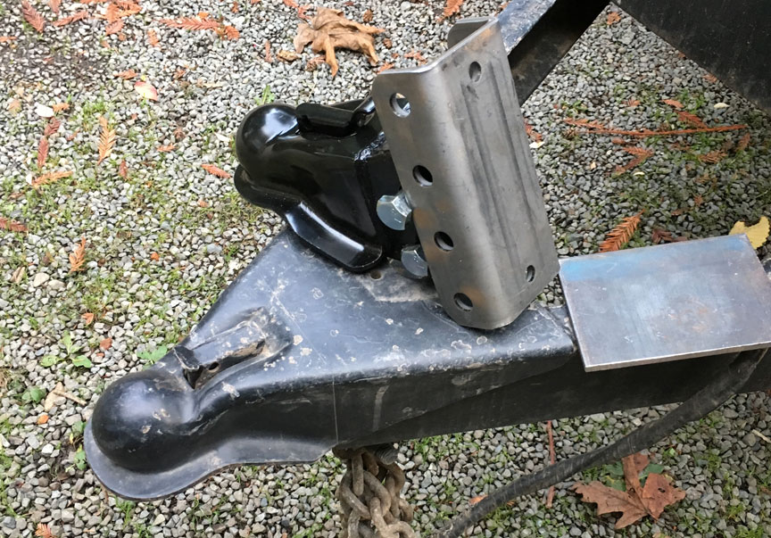

Anyway, I decided to replace it, AND instead of the same type, with an adjustable height coupler. Got this adjustable kit for $58 on Amazon. It's rated for 14,000 lbs.

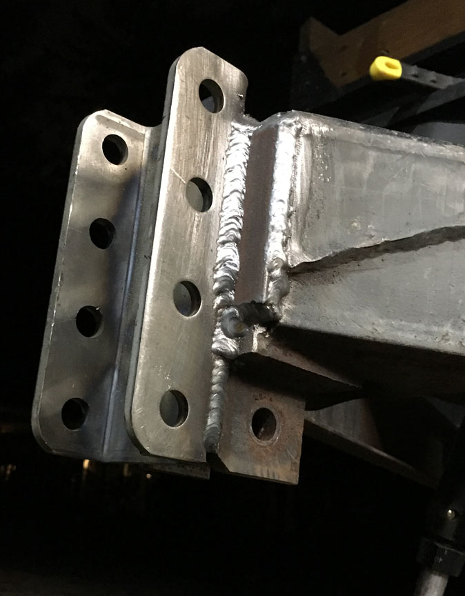

Welded with a Miller MultiMatic 200 wire feed (portable MIG TIG Stick) on 240v.
577391d1541307185-cut-dump-trailer-coupler-weld-adj_coupler31-jpg

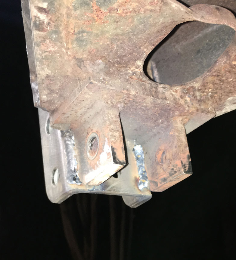

Cut it off with a steel-cutting skilsaw.
577392d1541307185-cut-dump-trailer-coupler-weld-adj_coupler32-jpg
577393d1541307185-cut-dump-trailer-coupler-weld-adj_coupler34-jpg
577394d1541307185-cut-dump-trailer-coupler-weld-adj_coupler37-jpg
577395d1541307185-cut-dump-trailer-coupler-weld-adj_coupler39-jpg
577396d1541307185-cut-dump-trailer-coupler-weld-adj_coupler40-jpg

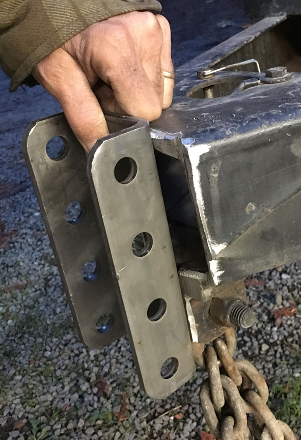

Why not tie it in top and bottom?
577397d1541307185-cut-dump-trailer-coupler-weld-adj_coupler45-jpg
Added some more steel to top and bottom (like 'wrapping the ends'). Just to be sure it was over-done.:rolleyes:
577398d1541307185-cut-dump-trailer-coupler-weld-adj_coupler48-jpg
577399d1541307185-cut-dump-trailer-coupler-weld-adj_coupler50-jpg
All done! OK there it is.

Looks good, looks like you MIG'ed it between squalls and before the wind?
Now you'll be able to use a pintle if you wish.

What grade are those bolts? Did they come with the coupler?

I did it the night before last. A little wind but I turned up the gas to 30CFH plus I'd wait for calm before pulling the trigger. Someone can use a pintle hitch if I sell it but it's still a 10,000lb GVWR trailer (6x10). If you have a pintle hitch prob wouldn't look at 10k trailer. I think of its resale value but not selling for awhile. This thing has really been performing for me, it hauls 2.5yds maybe 3 yds.
5/8" Grade 5 - came with the $58 kit.
Nice, Sodo! How long for the cut with that metal cutting skil saw?
Maybe 3x as long as if it was wood.
   / Cut dump trailer coupler, weld on adjustable height coupler (w/pics) #8
I have a Porter Cable metal saw that looks just like the one in Pic 2, they do a great job at making nice clean cuts where you can use them.
