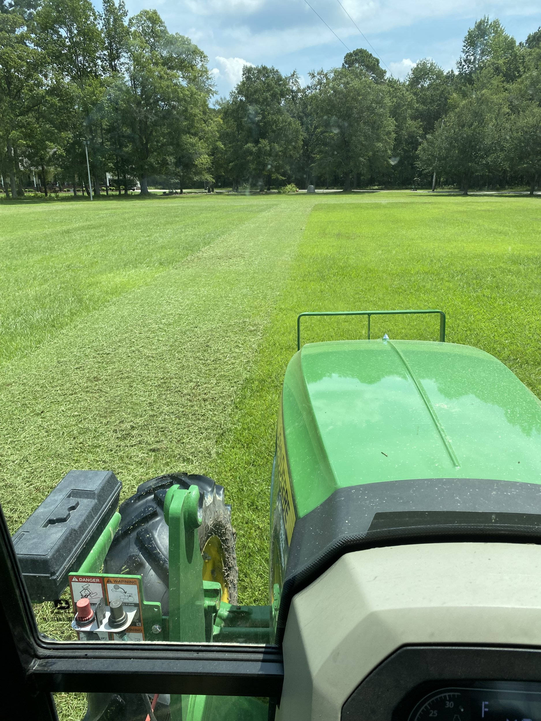

   / Cut 10ac with finish mower - Advice Requested #10
This was yesterday with my Maschio Tigre 300. It cuts and mulches weeds and brush just as good.
