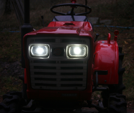

I have a Yanmar 1510 D. The headlight bulbs have been burned out for some time now and I have not been able to find replacements here. I am trying to have it ready to plow snow this winter (probably won't snow now!!) and that means that lights are necessary. I tried to find replacement bulbs here but without success. I know that I could order them from the States and get them, but here i could not find them.
I decided that I was going to change them to some other bulb, the standard halogen headlight bulb fof cars were not too expensive, but they draw relatively high current 55-70 watts rather than the original 25/35. Since I want to add more work lights I decided that the bulbs much be low wattage. I finally settled on one of the new LED bulbs that is supposed to produce the light of a 60 watt bulb but only use 1.5 watts!! If they work I will be able to make all kinds of work lights and still not draw too much current for my smallish alternator.

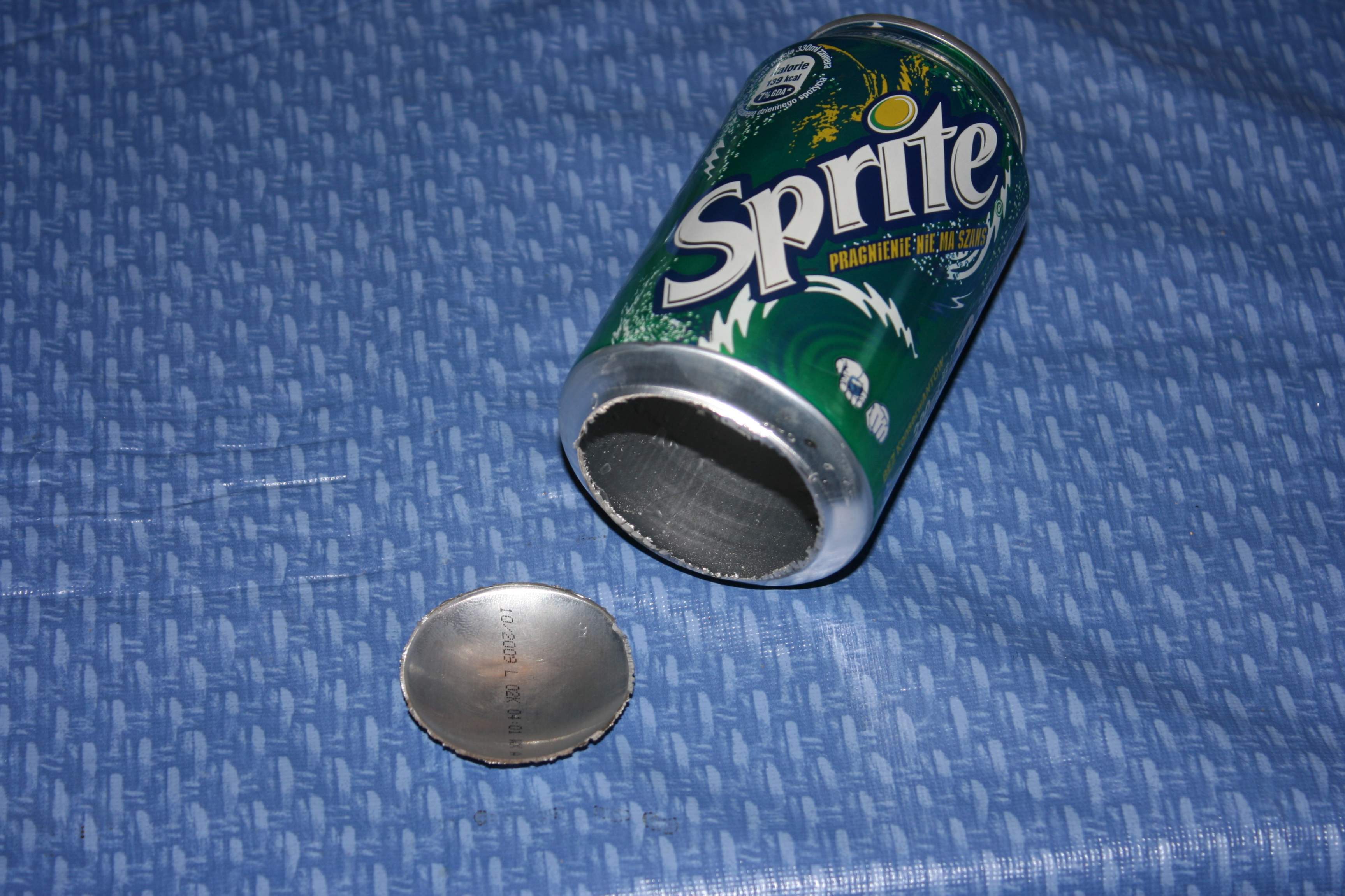

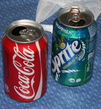

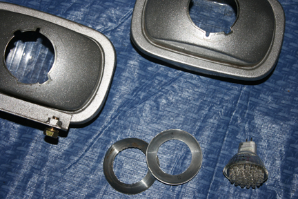

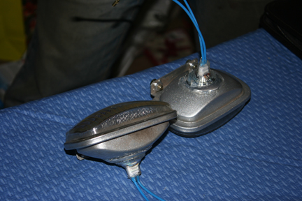

I choose the smaller standard size and need to make an adapter to fit it into the old light housing. I did not want to ruin the original light housings. I carefully cut the bottom off a couple of soda cans, used a hole saw to cut the middle out for the bulb "socket", Then I hotglued the bulb and the adapter together and then into the old housing.
Then with short pigtails soldered on and terminals they are read to reinstall. They work!!! I cannot wait to full dark and see how it helps!! I want to now plan how to add additional work lights using the larger LEDs.
I thought the project might be of interest to some.
Mike

I drove around the yard last night just for fun and the lights are much brighter than the original Stanley bulbs I believe. Thanks for your kind comments and if any one was laughing they kept it to themselves.:D
I worked for many years as a heavy epupment mechanic in AK. Often it was in inaccessible places where parts would have to be flown in. In those situations you get creative to get the machine through a few more shifts so that part have time to get there. Make it work!
I did find a place here where you can buy driving lights for cars that are LED, but they are kind of expensive (over $100) for a pair. I have less than $20 in my project. Admittedly they use bulbs that are rated brighter, how bright do you need for traveling at 15 mph max?
Mike

Heh it is good to know that I am not the only one huh? Kevin, I tried to use the MR 16 but they are a bit too big to fit in the existing opening of the headlights of the Yanmar so I went with the MR11 which is only 35 mm vs 50 mm. That is why I needed the adapter. The 16 was a little bit brighter Maybe 30 LEDs but the 11 fit with a meager 26 or something like that. They each only draw 1.5 amp. The bigger ones drew 1.7 or there about.
