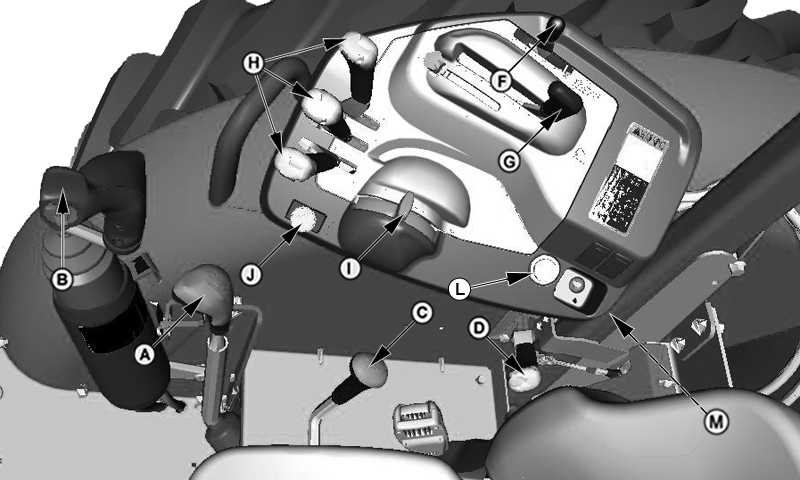

Isn't there a power outlet in the cab just for such things? The ones I've seen have a screw on cap that is retained by either a short chain or something like that so you don't loose the cap.
   / Customization virgin seeks help connecting new toy to 12V power on tractor.
There is a "cigarette lighter"-type connector, but I was looking to make this a more permanent type connection if it makes sense to do so.
   / Customization virgin seeks help connecting new toy to 12V power on tractor. #4
Labeled as "L".
I think the one you are talking about is "M".
My console. Listed as "L" here.

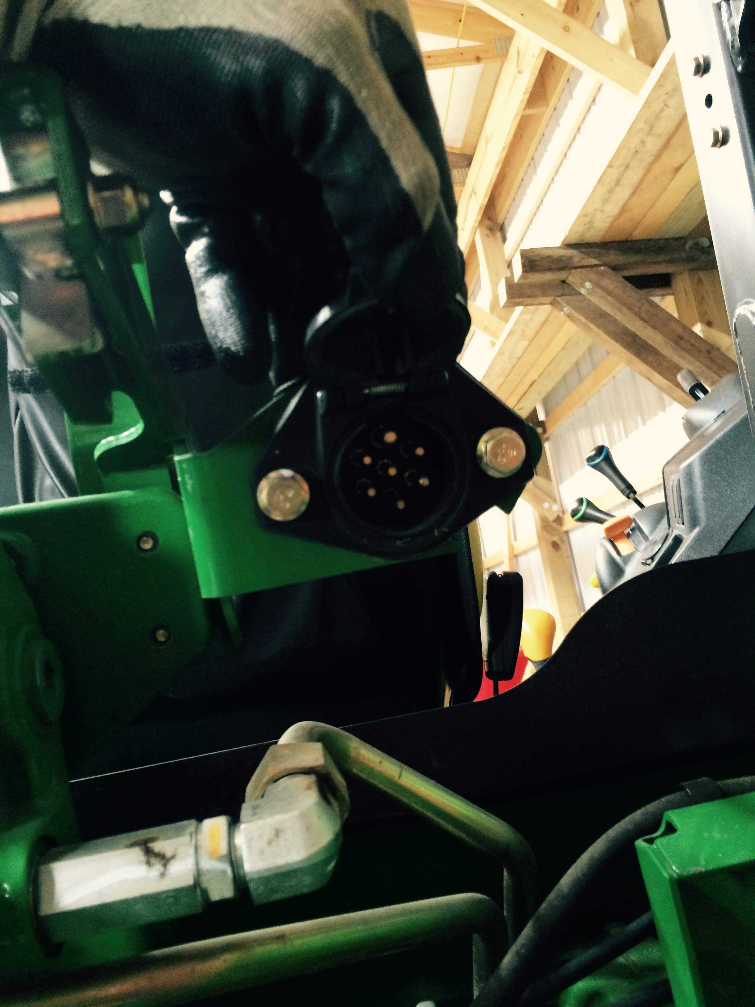

After looking the tractor over, hiding in plain sight behind the seat was this 7-pin Pollak brand receptacle:
This should do. Now I just need to find a 7-pin female plug to wire the control panel to.
There are plenty of 7-pin adapters out there, just not the unwired plug.

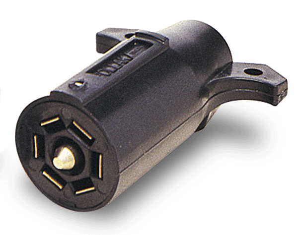

Just be sure that you don't get the RV style.
This is what you need.
#9
James k0ua-Perfect. I ordered the plastic one.
Xfaxman-I ordered the round pin plug. Thanks.
