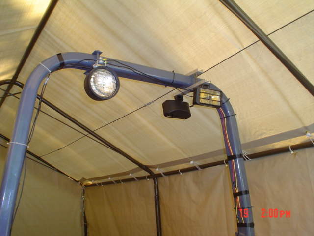

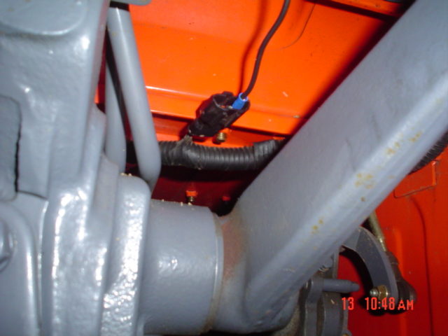

I am trying to put in aux lights on my CK30. On the fuse box, there is a Customer use fuse (15 amps). Does anyone know where I can access this circuit? If you have a photo of the connector and where it is at, that would be great.
   / customer use electrical circuit CK30 #2

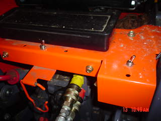

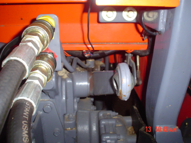

I put lights on my CK35 about a year ago. The connector you are looking for is under the right side, underneath the back of the seat area, looking forward. I used 2 toggle switchs mounted behind the tool box area. Have 4 lights, 2 front and 2 back at the top of the ROPS. I really had to look for the connector as it is hard to find. Hope the pics help. :)

On the last picture in the post above you can see a hole by the edge of the orange decking, they make a light that bolts into that hole and the terminal connector plugs right in. Got mine from Wallace 2 years ago or so. Great for use with my backblade. The line is hot when the key in on.
