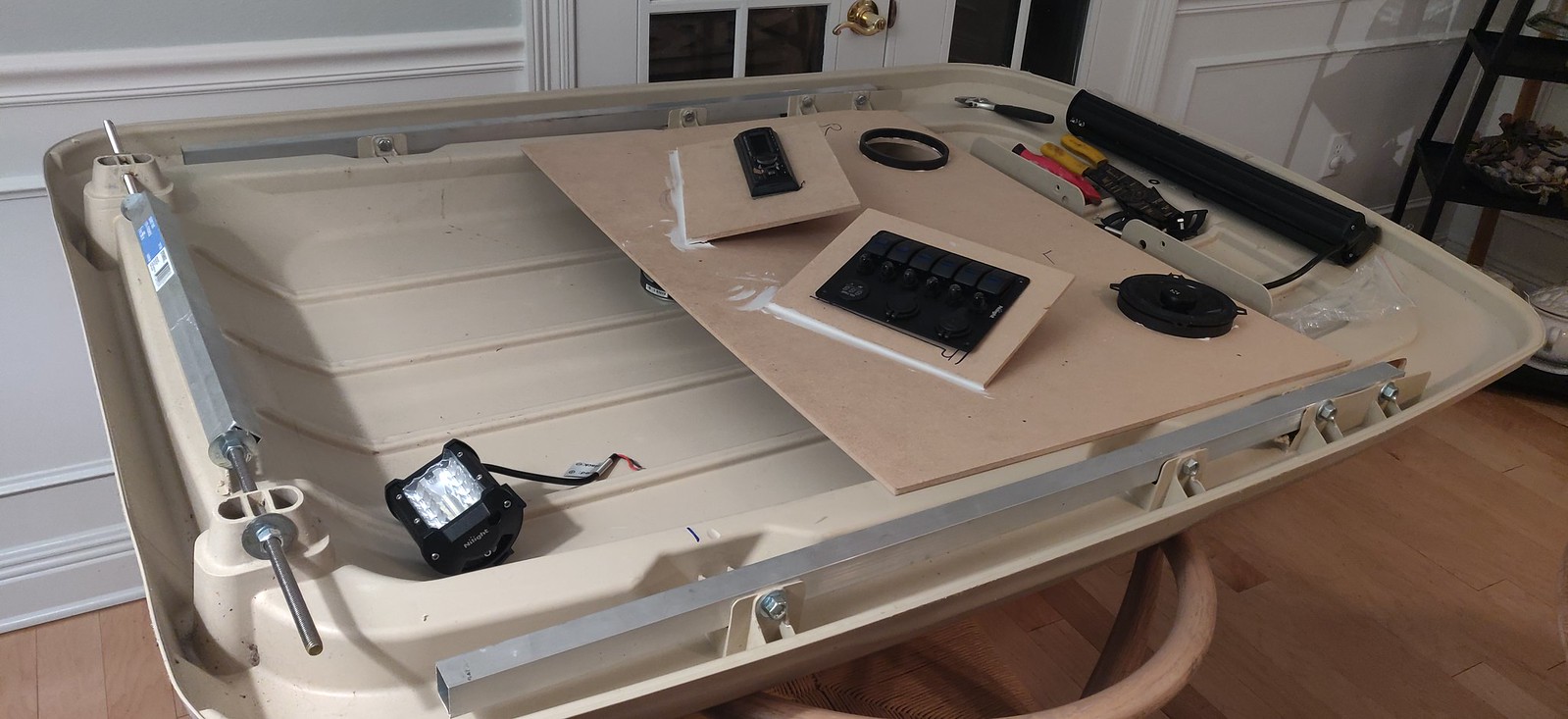

Well... After seeing how expensive a factory ROPS canopy was and seeing the DIY tops, I found a Club Golf Cart cover close by on market place for $40 and got started with my build.
This is my first post so bear with me on trying to add photos etc to this post.
Decided to delete the handle assists and bolt the aluminum to the existing brackets. Threw a stainless rod through the drainage holes in the back and put a piece of aluminum on the bar to mount the rear LED PODS.
Thin MDF is my base so I can build the toggle switch brackets and stereo. I'm going to wrap this and waterproof it with fiberglass resin.
Ordered a 12 inch radiator fan to give me some cooling for working in the summer.
Waiting on a few more parts before I can put it together.
Hardest part is my tractor is parked at my property so I'm building without being right next to it, so I know the mounting brackets will have to be somewhat modified when I go to attach it.
Here are some pics so far, I'll attach them.

Looks great so far. But I have to ask; Are you building that in your dining room? :eek: How'd you get that past the "other half"? :confused2:
   / Custom Tractor Canopy
#9
Haha! Good eye. The garage is packed from out move and weather has been terrible, so I set up shop here to get this done.
