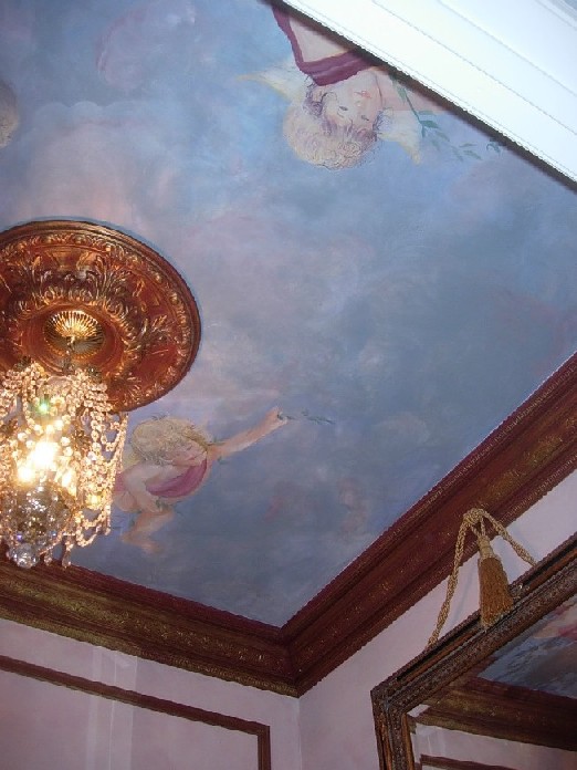

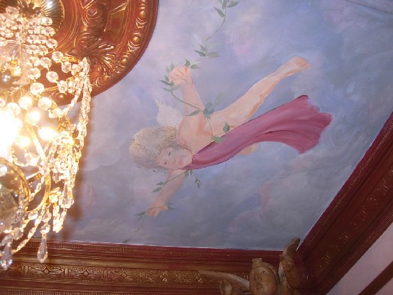

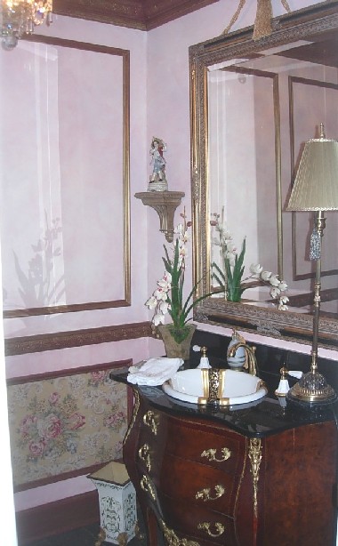

Yep, cherubs... would you like to see some of them?
Here are 2 pics showing the ceiling from two different views. The third picture is looking in. This is our 1/2 bath, so it's pretty small. We did 100% of it, from laying the marble floor, converting the bombay dresser into a vanity (and kept 2 of the 3 drawers working). The crown molding has seven (yes SEVEN) pieces of wood per each wall. She hand painted & fired the lavatory, faucets and even the toilet tank lid. I'll bet I'm the ONLY person on TBN (or a lot of other places) who has had their toilet tank lid and lavatory & faucets inside their oven, baking the paint on :cool: . She also drew freehand, the design of the cultured marble top on the 'vanity' and had it custom made.
Bathroom is too small to show all of this on a couple pictures... if ya ever want to stop by and "contemplate", you're welcome to! :p

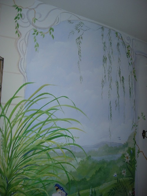

This is the other bathroom wall. no cherubs in here but a wall mural that is on 3 walls (tub/shower on 4th wall)
