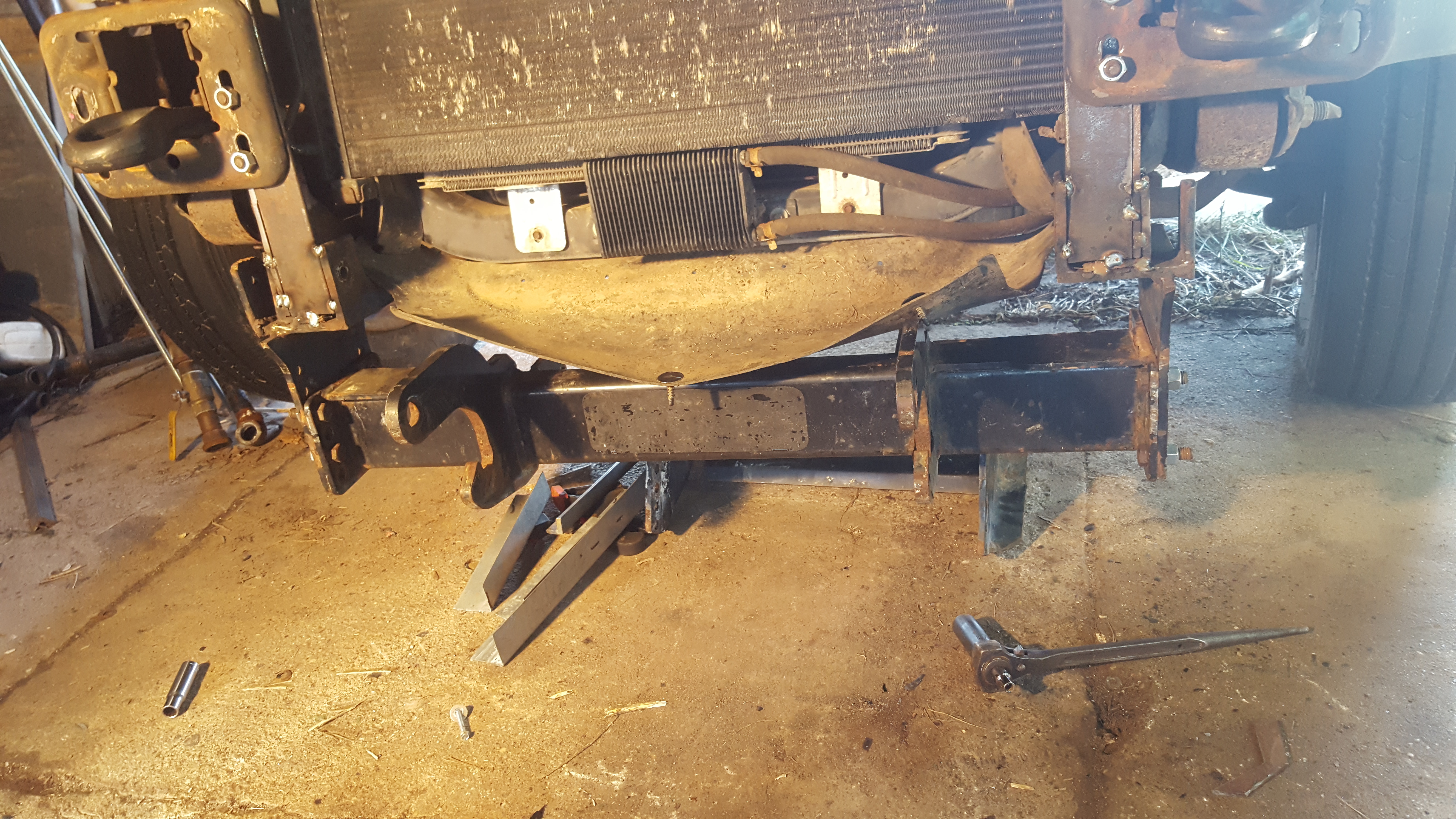

Have been looking heavily for a rt3 mount for my 2000 f550 but only found one and didnt have money at the time. But i have inquired one off a chevy through a trade for so have to make it work
Building it all out of spare materials for cost sake. Mostly 2x2.5x.25in and 2x2x.25in angle
Sorry about the bad quality of pictures. Only working with 2 small lights and a 500w flood lights.

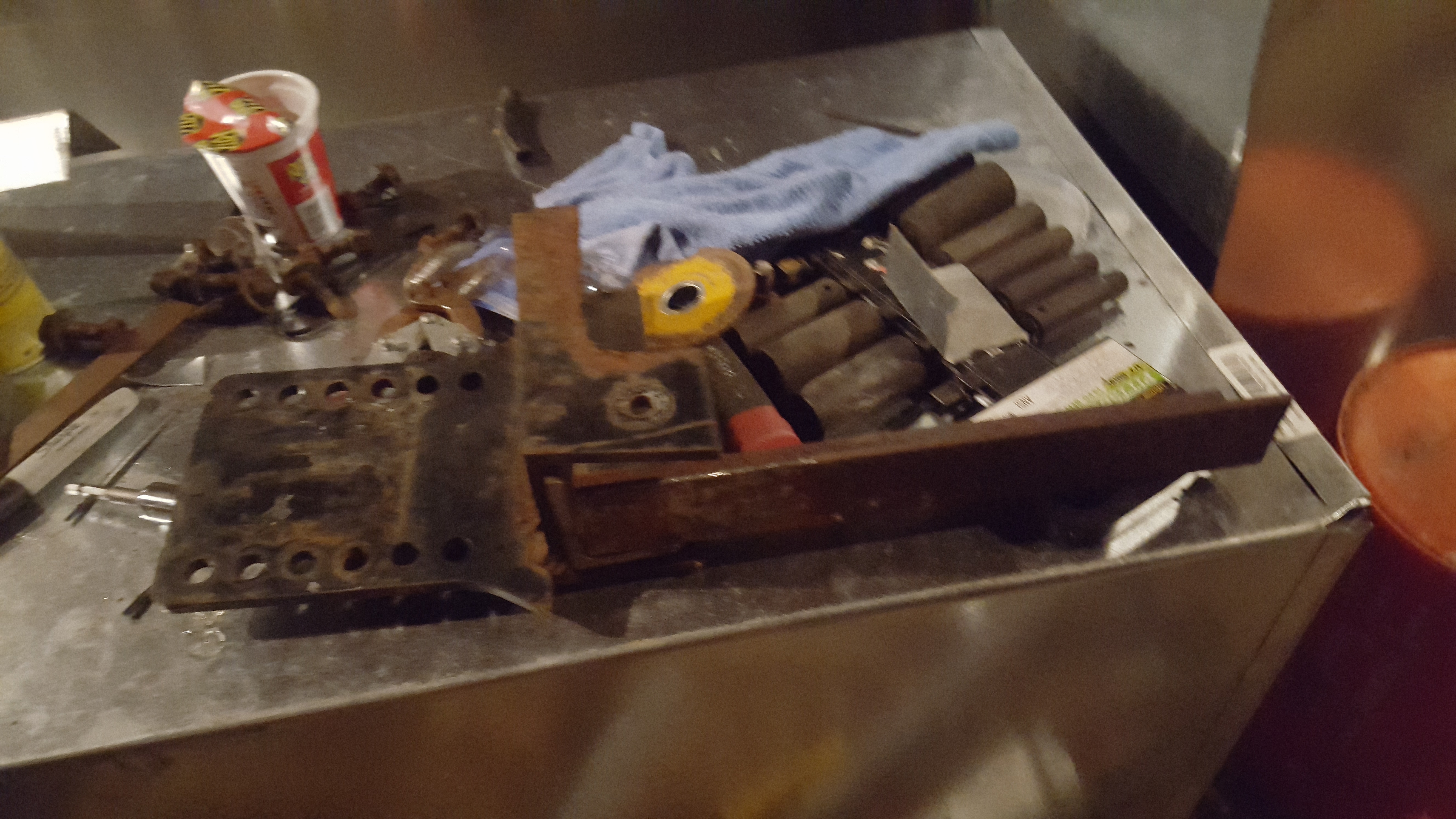

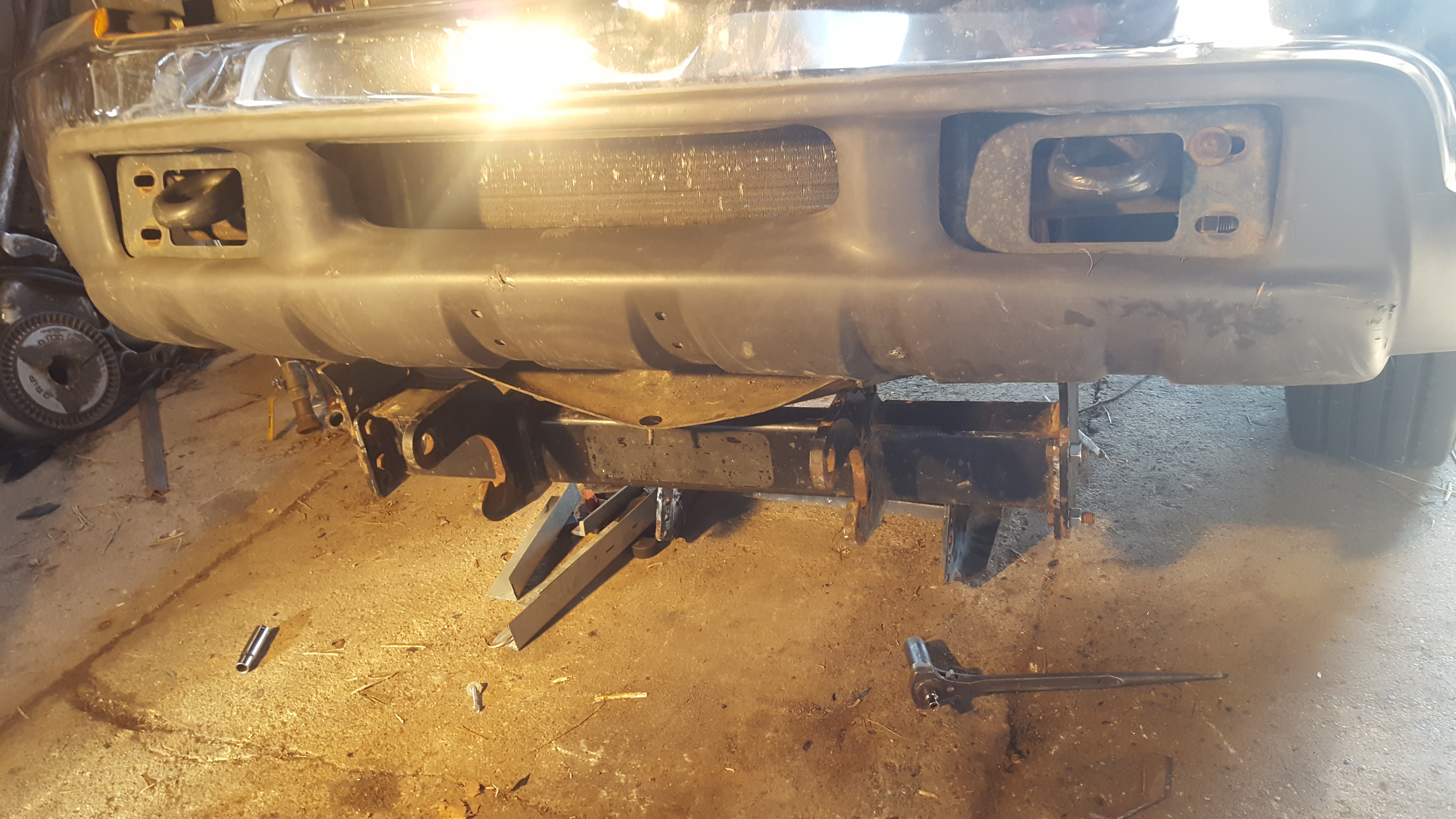

Got the bumper off and set the push bar under the truck

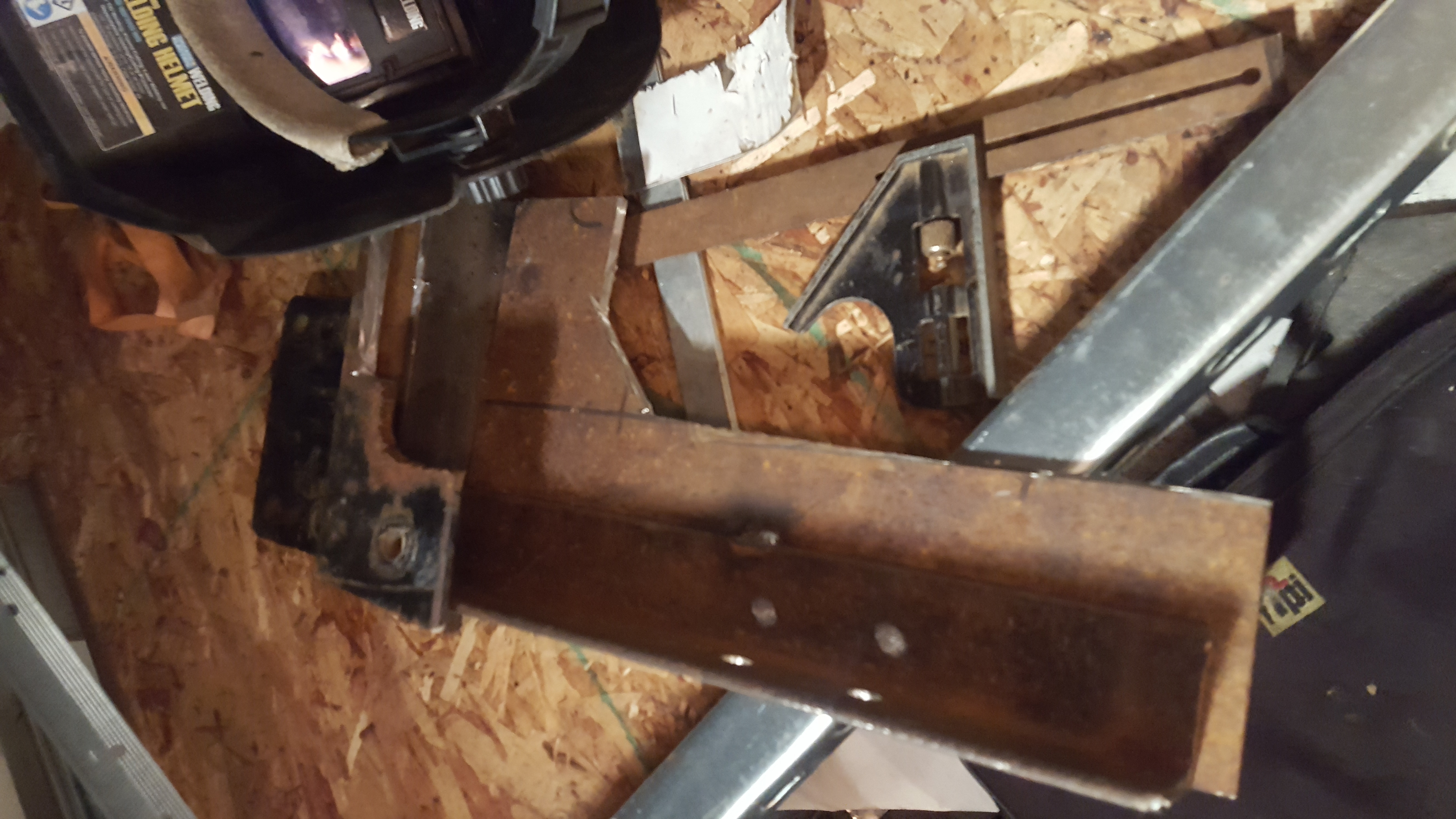

Starting to design the uprights. 2x2 angle will be going up to the bumper mounts. There is no other way to attach to the from in the front but bumper mounts

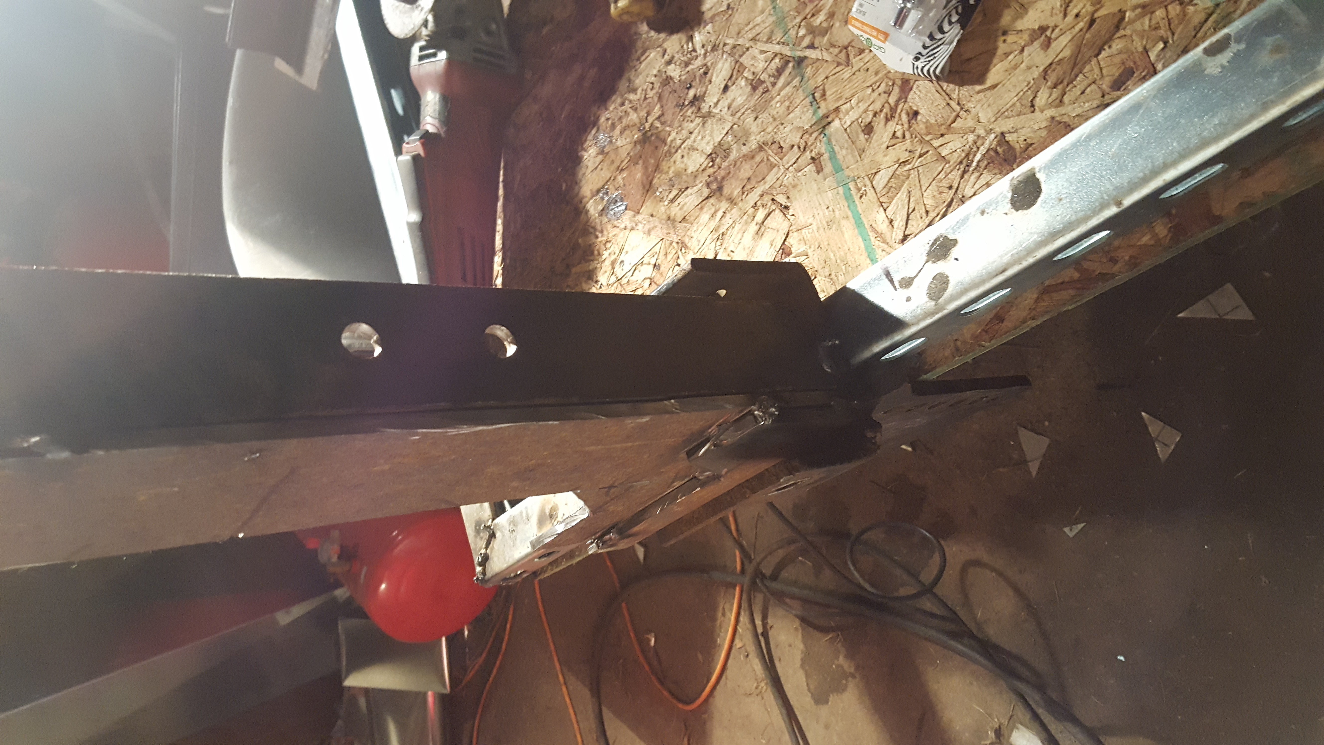

Bad picture but it shows how the upright will look like welded to the adjustments for height on the pushbar
Now it will get raised straight up and bolted.
Next will be doing the back mounts

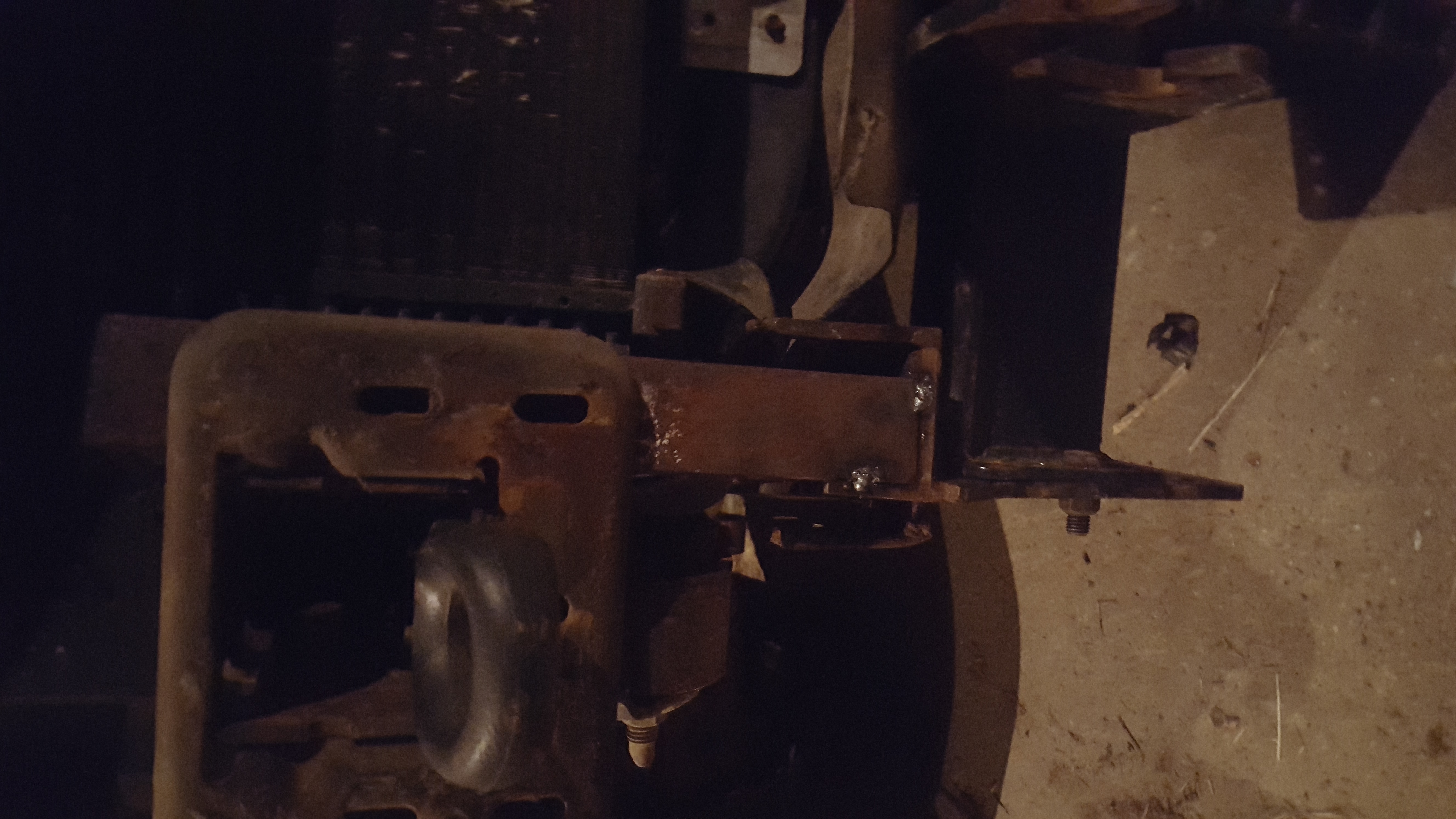

Had my dad look at it and we decided that it would need more support incase of a heavy impact. Cut 1/4in plate 3.5in wide and then cut it into a "boot" also. 1483363801639.jpg1483363813755.jpg1483363827235.jpg
Have to go through and weld everything up if it bolts up nicely. The adjustment plate has the holes cut on a angle for the push bar so the second mount that got tracked together got put on a angle to straighten the holes but first one didn't. So i will have to try and grind a corner weld and straighten it. The mounting holes to the truck also will get raised 1.5in or so and pushed out 1/4 to make up for adding the plate

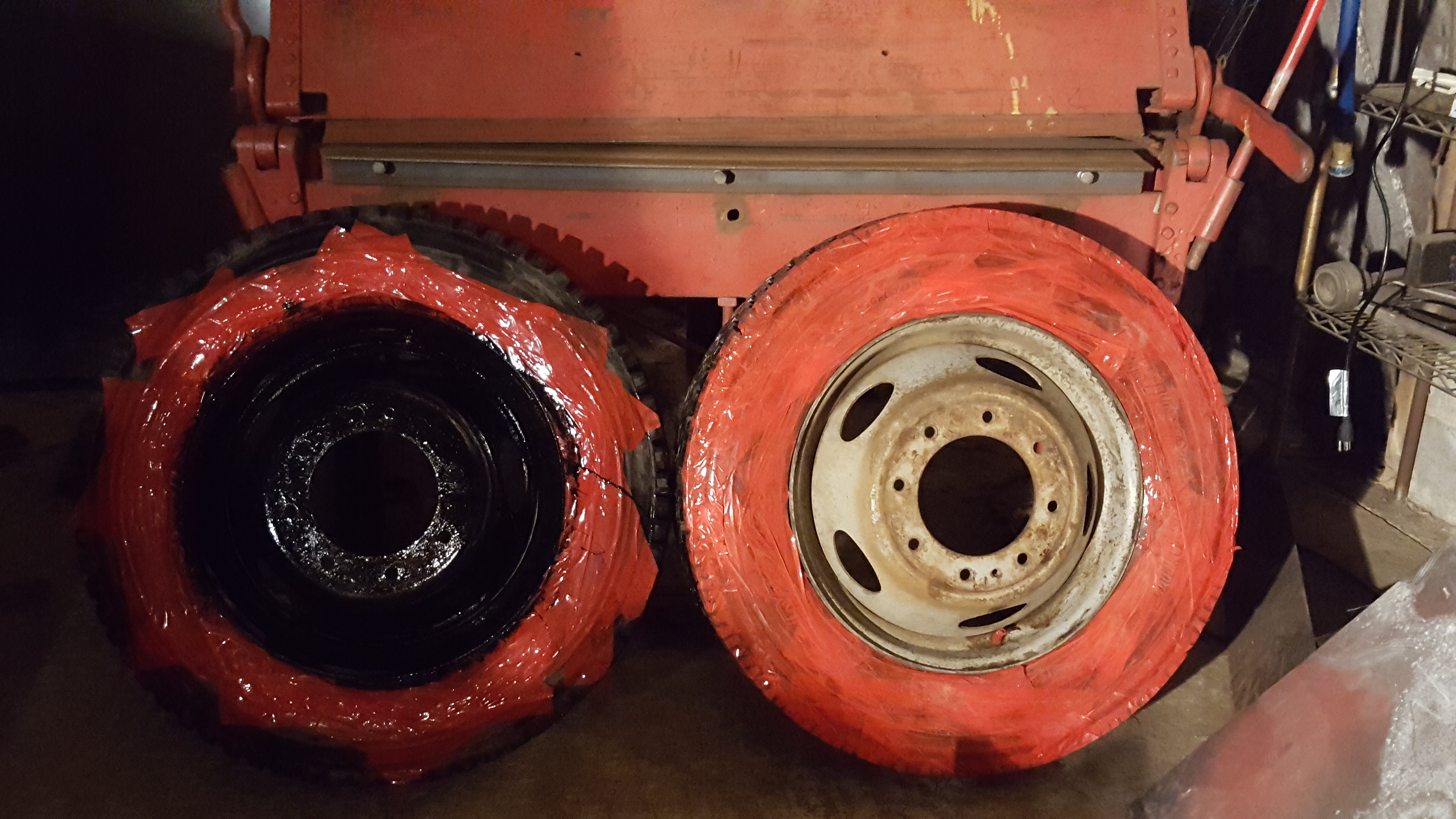

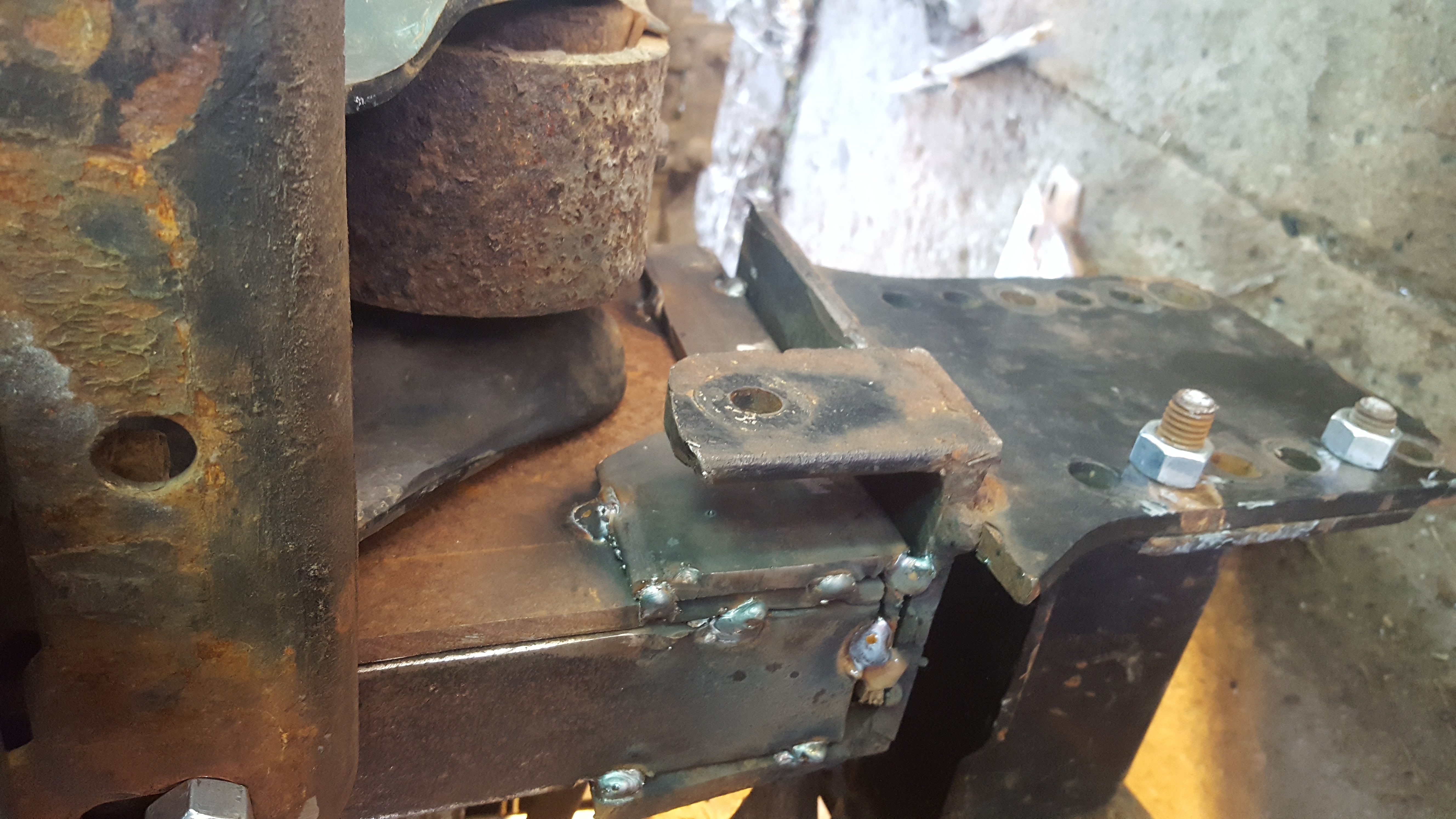

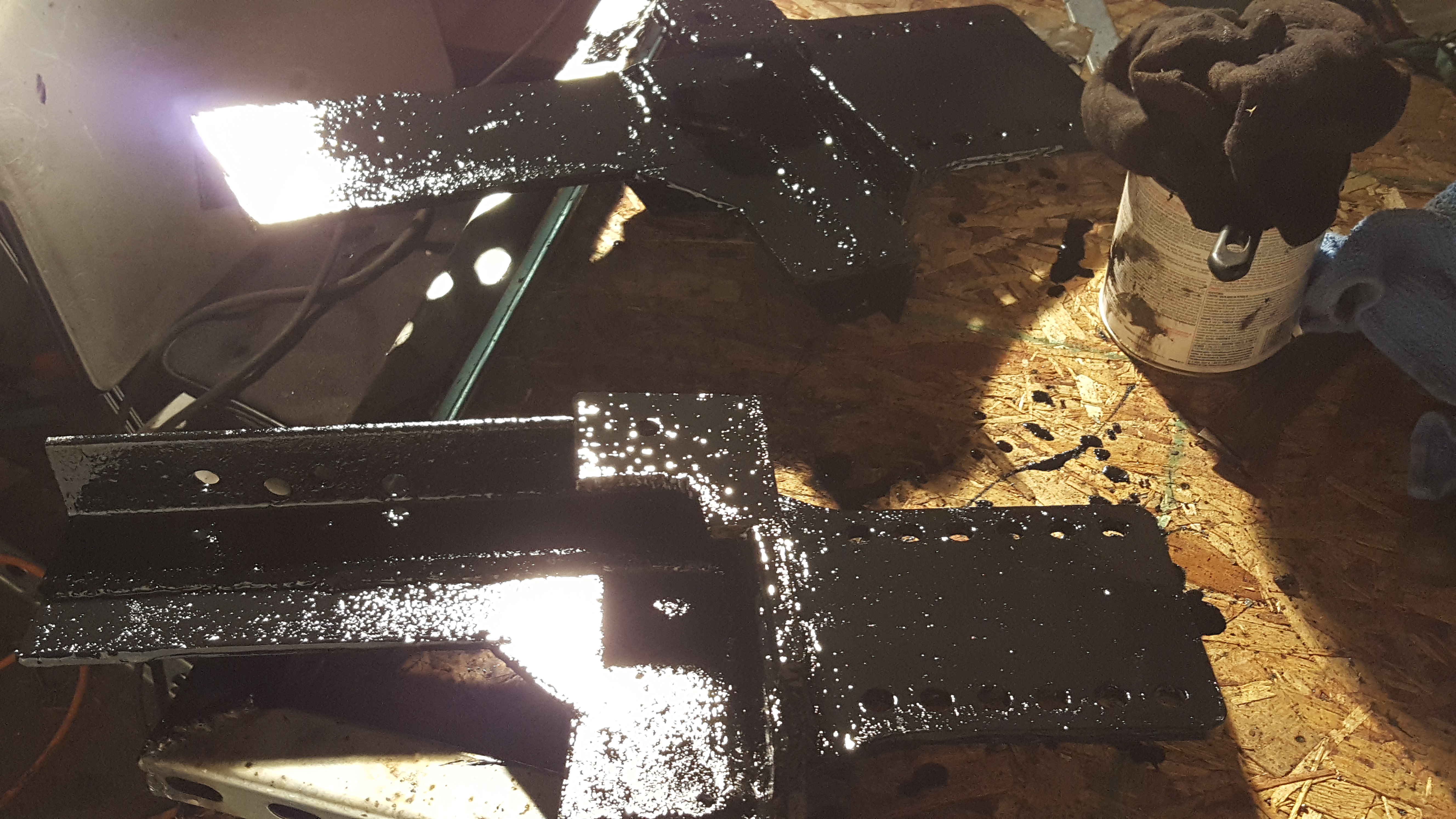

Well got the front brackets fully welded up. My welding still aint that good so my dad went through and hit it hard. Then got some paint and got 3 layers put on to it. Then put some paint on to the push bar and some onto the truck itself. Also painted the outside tires black too (have had them off to fit into the 8ft door on my other garage).
Some more pictures of how the bracket is done
Bolted it up while just tacked and make sure it was aligned
Bumper just set onto the tow hooks. Bunper will be raised another inch or so. Good news is that I wont have to cut the plastic below the bumper for the mount.
Paint on the mounts

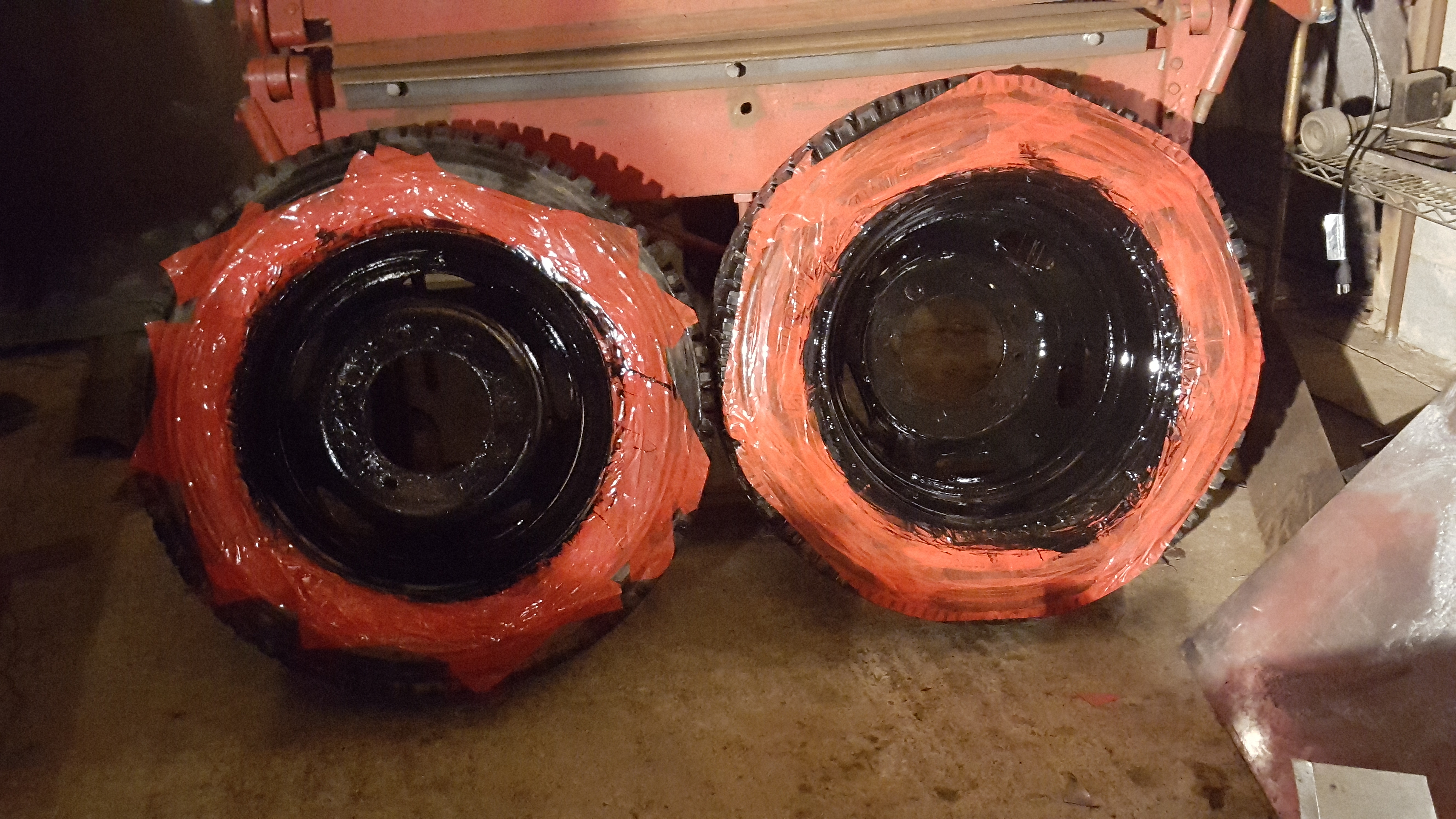

The 19.5 in rims look alot better with black paint.
Going back to school wednesday so will stop at tractor supply and get a few cans of spray paint to go over the rims one last time and to do alot more under the truck where a brush wont go.
