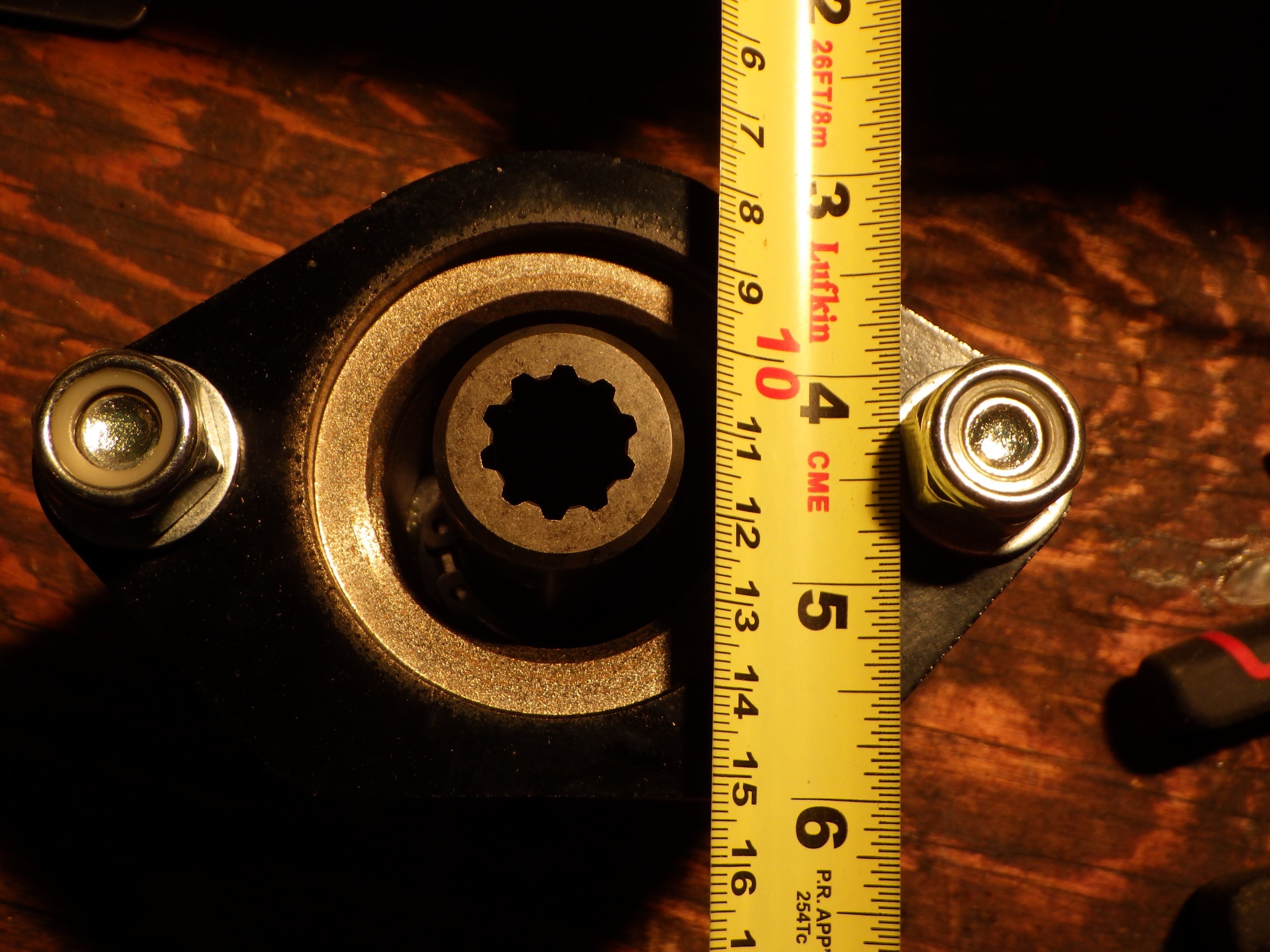

Alright, here is a picture of the implement-side quick-connect:
I measure the peak to peak distance as 18.8mm and the trough to trough distance as 15.6mm. The outer diameter is 29.9mm.

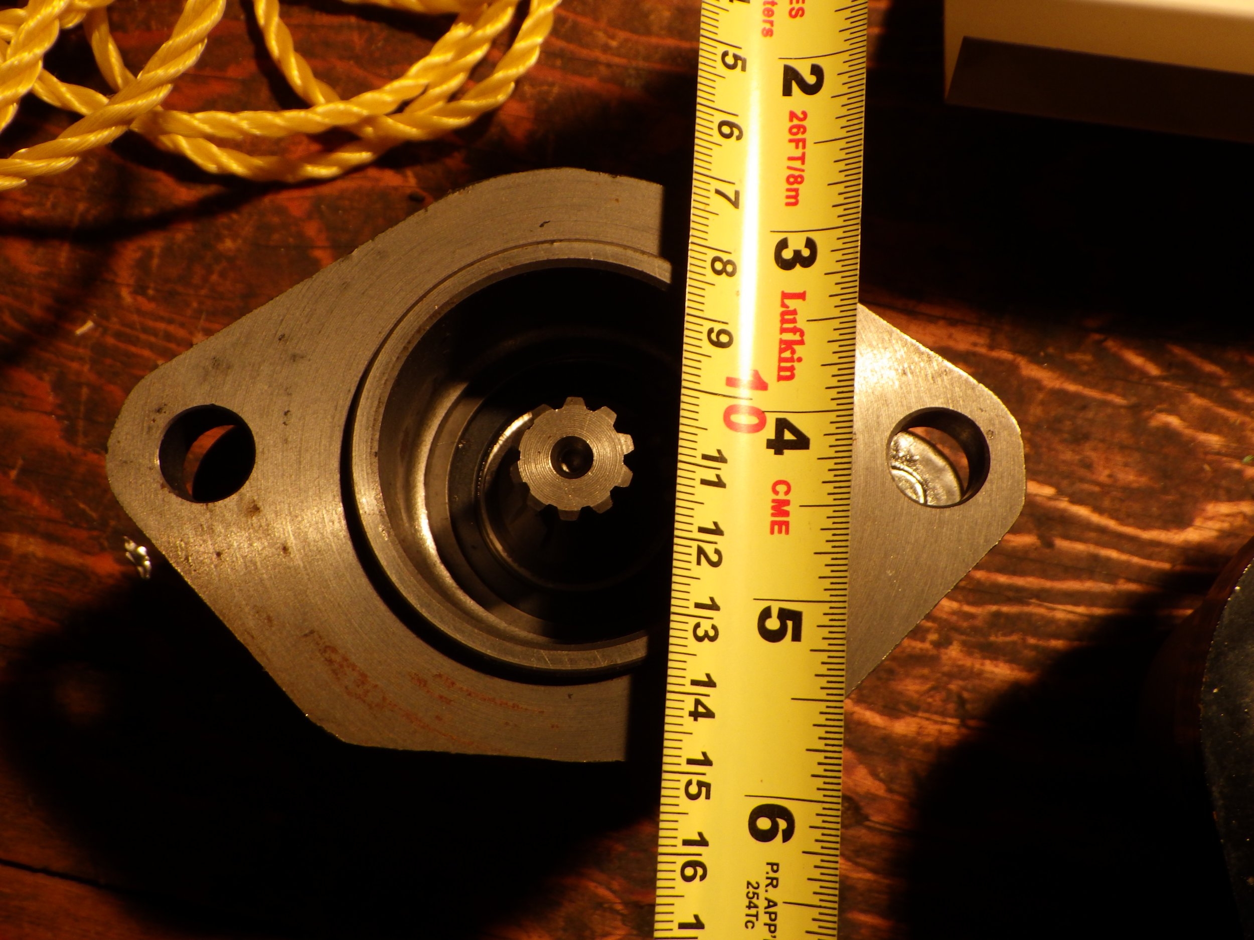

For good measure, here is a picture of the tractor-side quick-connect. As expected, this male spline seemed to fit into the implement side female spline perfectly:
I measure the peak to peak distance as 17.6mm and the trough to trough distance as 14.6mm.
I hope that helps. If you discover the name of the standard for such splines I'd be really interested in knowing. It'd make my life easier when I do get around to my custom implements.
