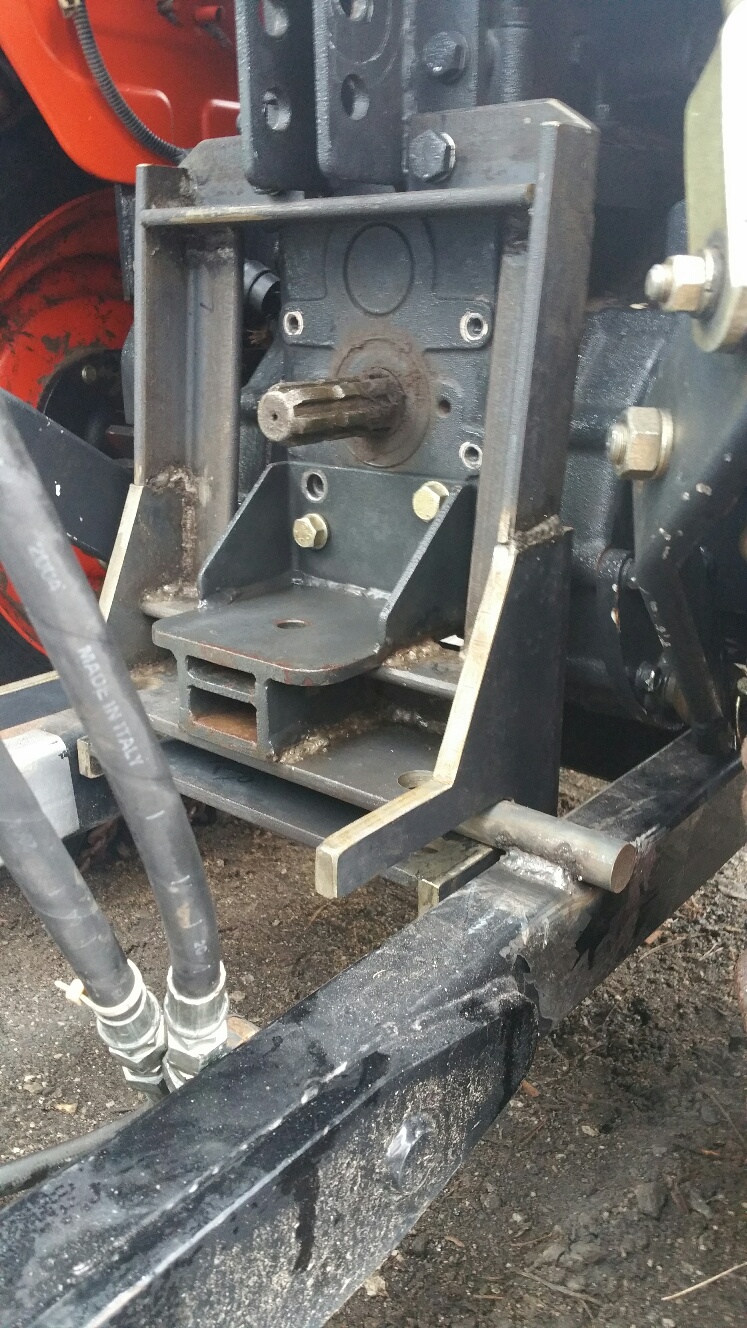

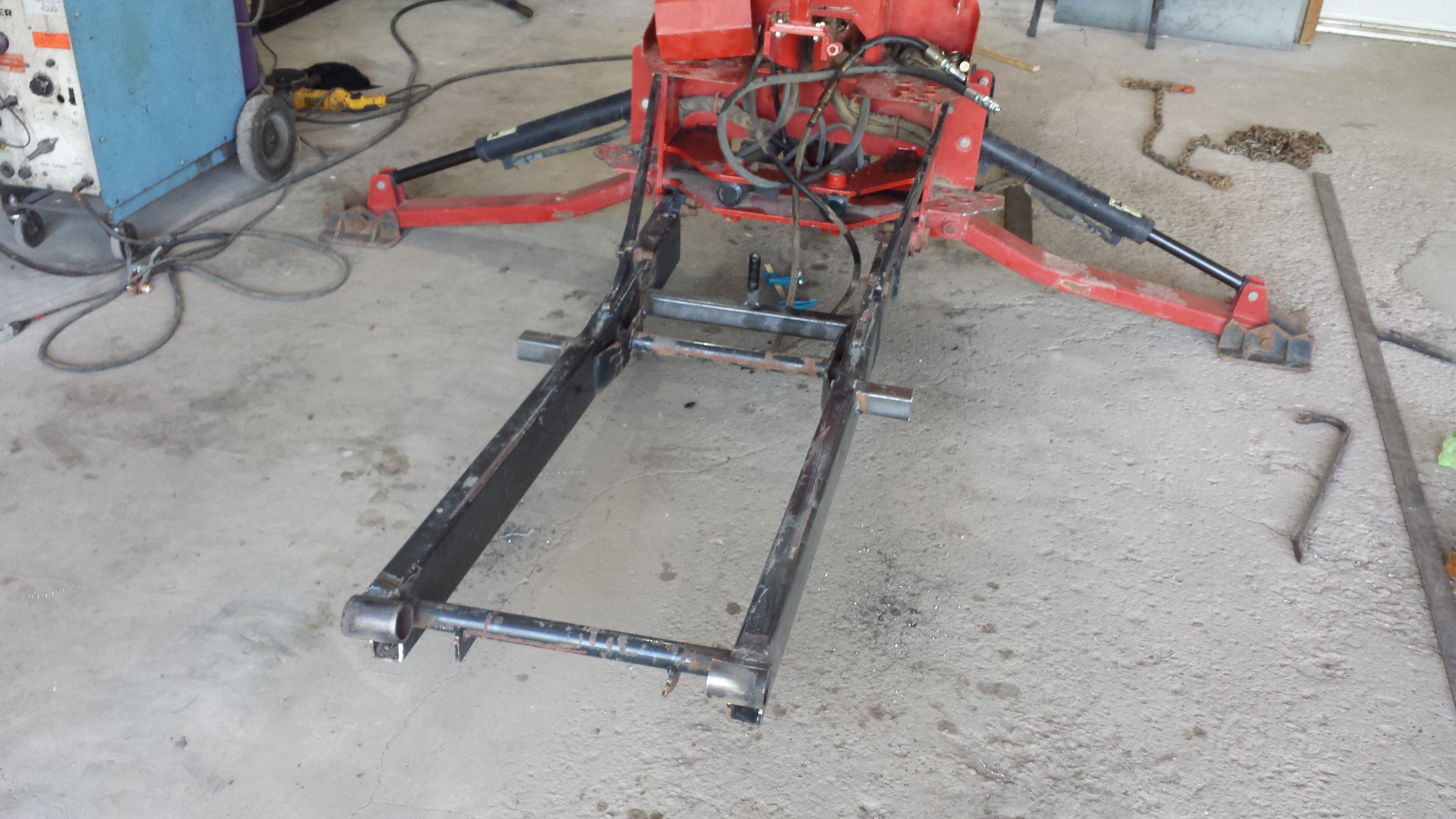

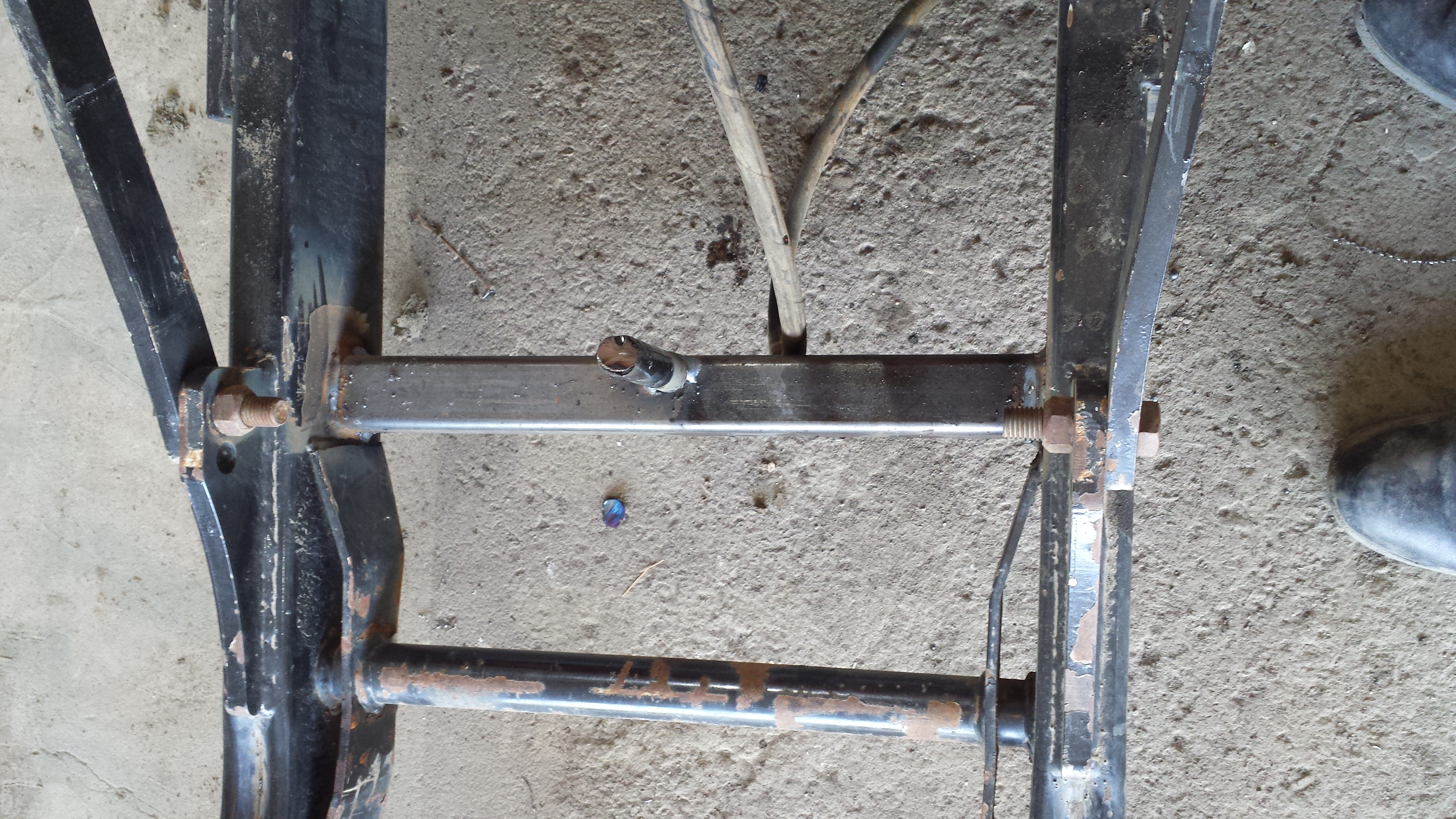

I recently got myself a 3pt backhoe for my tractor. I got it at a great price in an auction. It already had a subframe mounted to it which I then needed to modify to fit my tractor. The backhoe was a Case IH BH109 and I mounted it onto my Kioti DS4510HS. It took very little modification as it fit fairly well and close to my existing loader subframe. Aside from a front mount bolted onto loader subframe on each side of tractor, I did not have to change anything on my tractor. I was quite happy with my design and wanted to share it here and also get your opinions if I this will be sufficient or if I should beef it up more. I read over dfkrug's excellent thread about different styles and found it helpful. Hopefully he can look at this too and give me his opinion. I just want to get your opinions as to whether this will be strong enough for the various forces or if I should change it yet.
The installation is also very simple as I only have to back over the subframe, raise the subframe with hydraulics if it is right on the ground, back up until the two pockets at front bottom out, then use the backhoe boom to raise the rear end and let an aligning pin lock into the 1" hole on the drawbar, and then install the top link. Removal is the reverse.
I thought the drawbar pin was clever as it keeps things right where I want them and puts many of the horizontal forces into the drawbar.
I have not had any previous experience with tractor backhoes but have wanted one for some projects around my house so am happy to have got one. I want to make sure I build it strong enough to last. I tend to be hard on my toys.

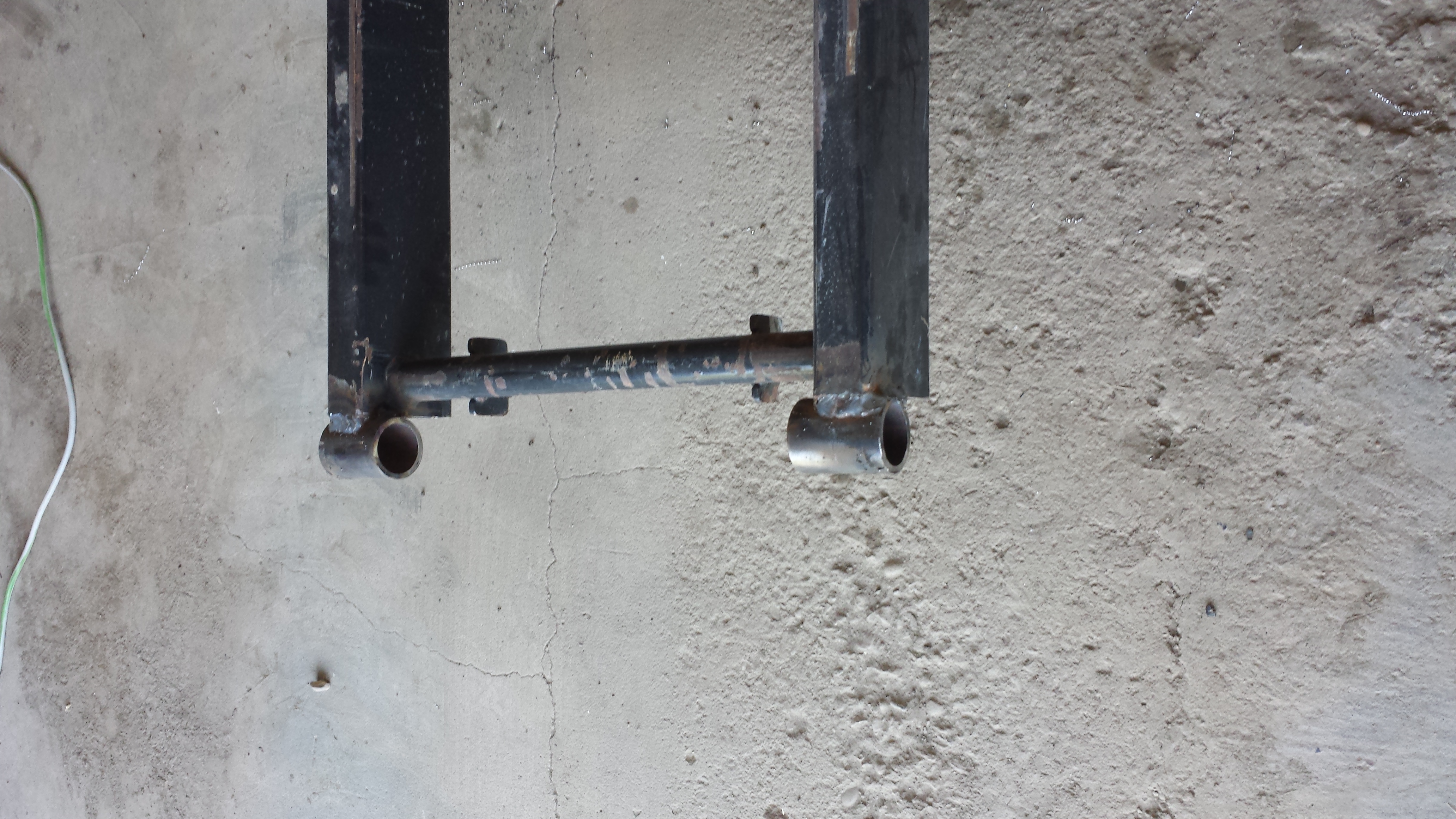

First picture shows backhoe as I got it. Only mods I did were weld 2 pieces of pipe to front edge, 2 pieces of 2" square to sides to act as vertical stops, and an aligning pin that fits into drawbar on tractor.
I had intended to not use the top link mount at first and had planned to weld two mounting ears on back of tractor, one on each side above axle where ROPS goes up. But I did not as I did not like that there would be no angle down to the implement (almost horizontal link would not hold UP the attachment) and because it would have been quite tight without removing the 3pt arms. It was doable but not simple. I decided to just use the top link for now (which still has a very shallow angle on it) and then see what you all have to say.
If I unbolt the front mounting brackets, the tractor is completely unmodified still and I can get normal ground clearance.

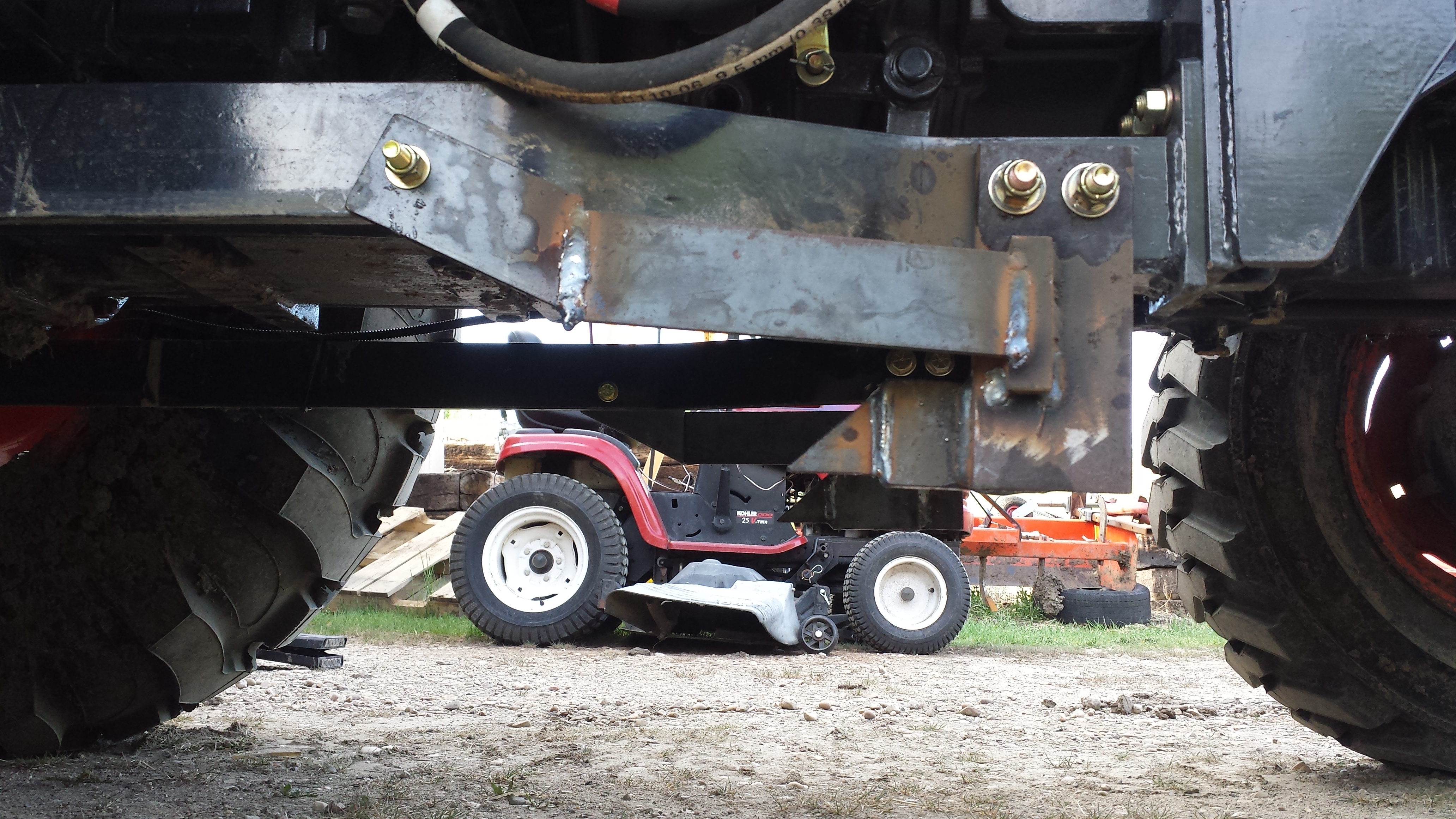

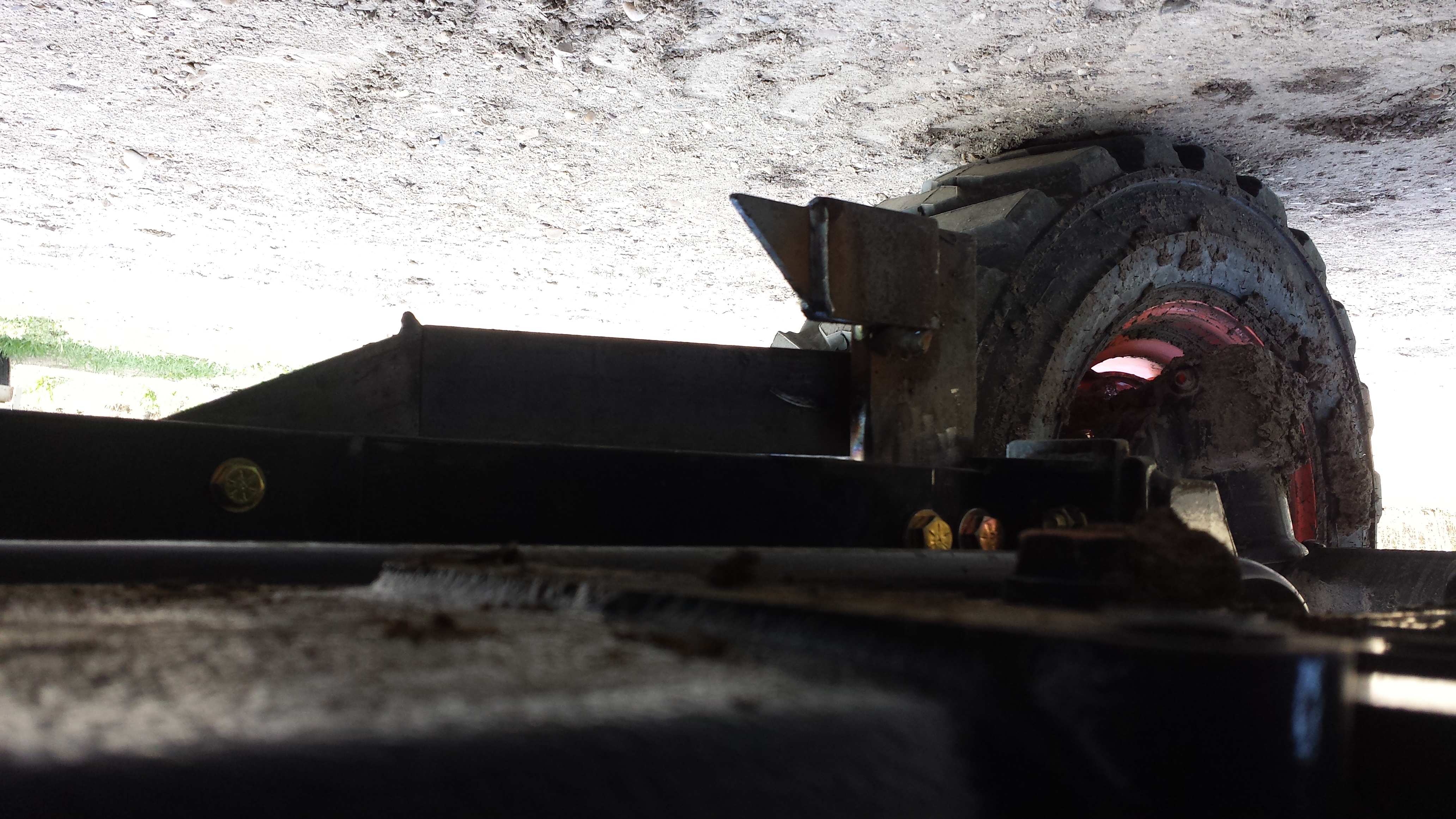

I tried to mount it as close and high to tractor as I could. I even had to cut the corners off the original steps to clear my tires.

Looks good, Caleb. On my Kioti CK30 subframe, I wish I had trimmed my steps away even more.
When you are ready for a test-dig, take a video of the hoe-to-tractor connection in back and
look to see what kind of flex you get.
