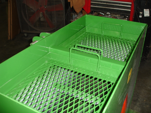

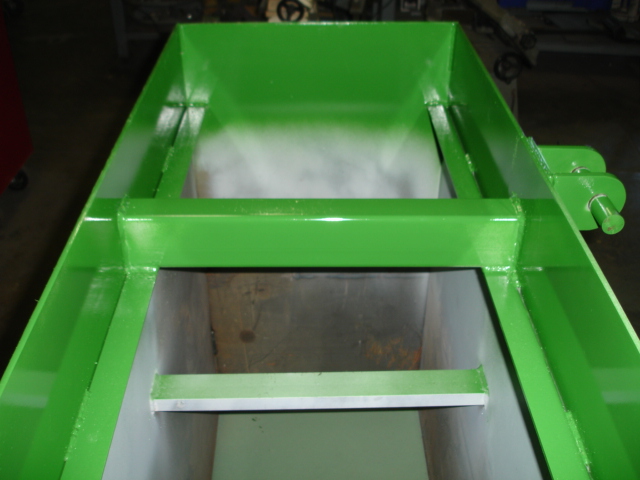

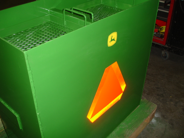

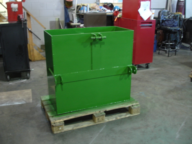

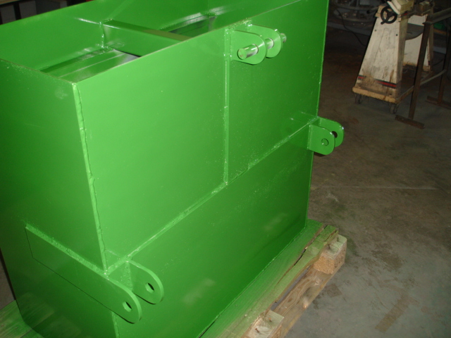

Here are some pics of my custom made ballast box.
Willybuilt box!!

that my friend is a serious ballast box. do you have any drawn plans or did you just wing it?
   / Custom Large Ballast Box (2000lbs)
Yes,, I redrew it on cad, but this is where I got my inital start:
Challenge Implements
If you want the cad file,, just let me know and I can send it via email.

I am putting it on a 5525 with a 542 loader. It weighs 425lbs empty and I plan on adding 1300-1500 lbs of concrete blocks to it. (we finished it up last night so i will put the final pics on here later)
Here are the final pics...........
(We added some trays in top to store chains or other stuff. And the final touch was some decals)
