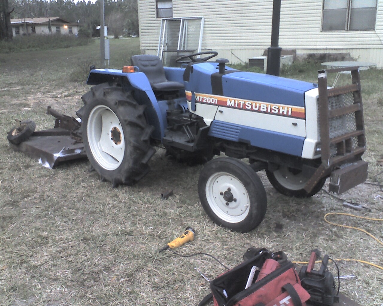

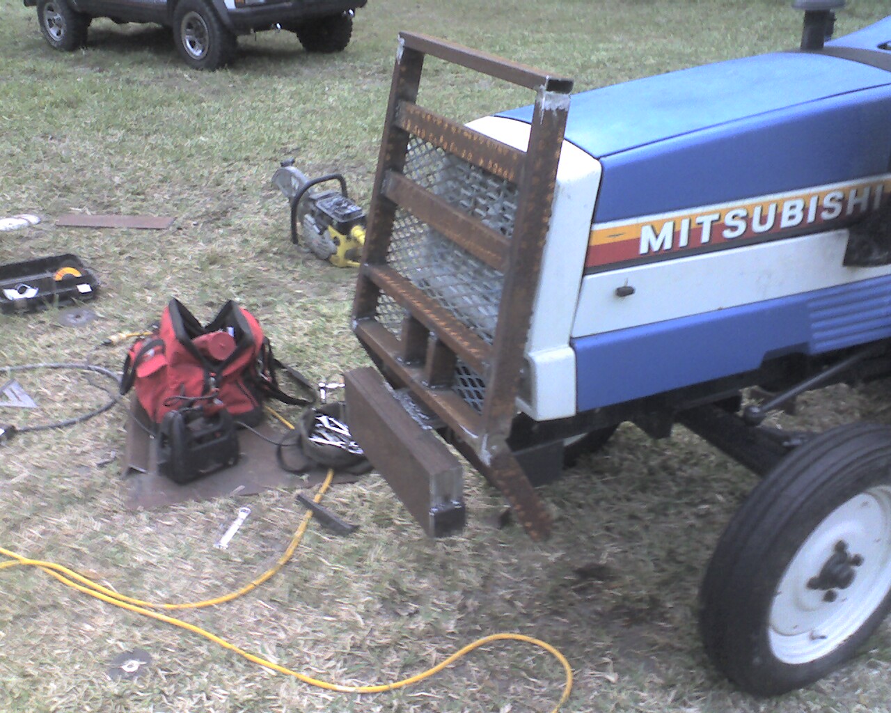

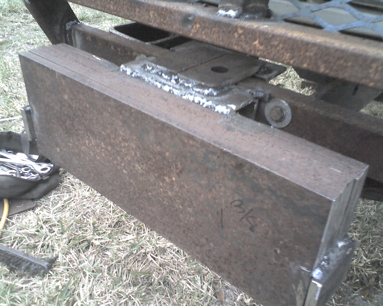

Here are a few pics of a custom brushguard (weight set) bumper and upgrades to an older model bushhog 105R.

Here are some resized pics, please let me know if they are still too small, thanks.

Much better......... looks good. How much weight do you have in steel plate on the front?
   / Custom Add ons for Grey Mitsubishi Tractor
Thanks for the compliment, its only about 100 pounds, will brobably add another 75 or so, I just mounted everything to see how it fits, plan on sandblasting and painting everything this week.

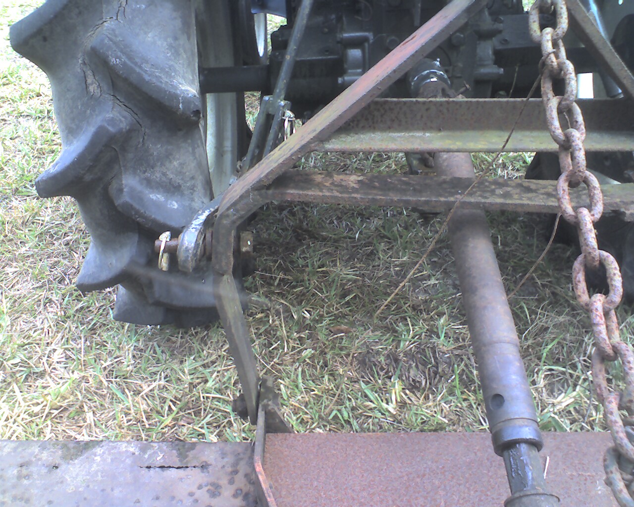

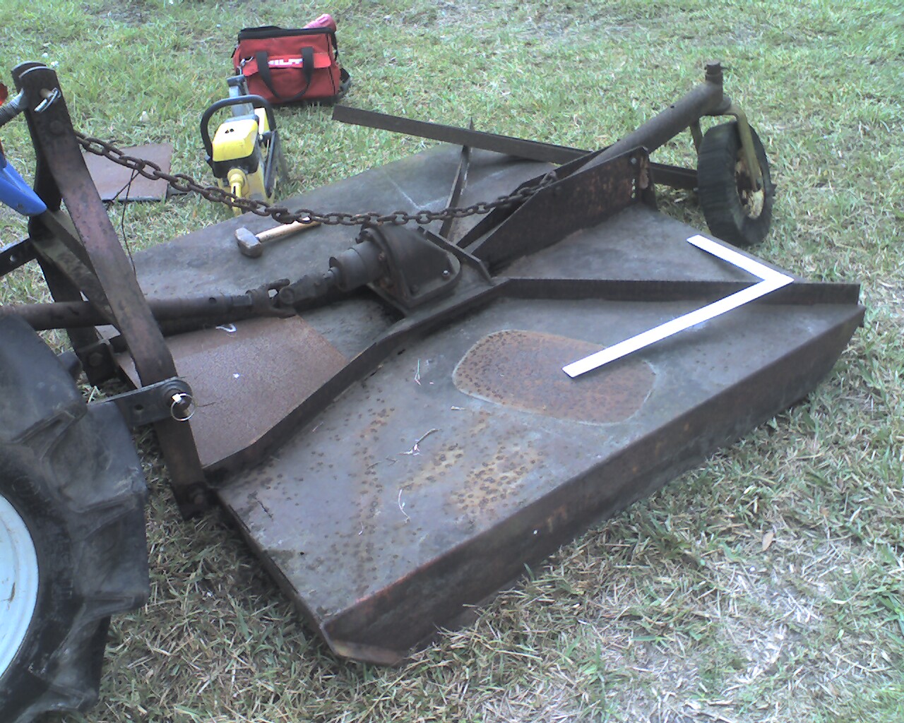

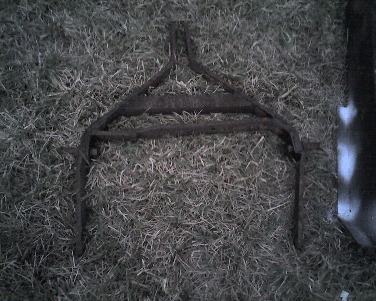

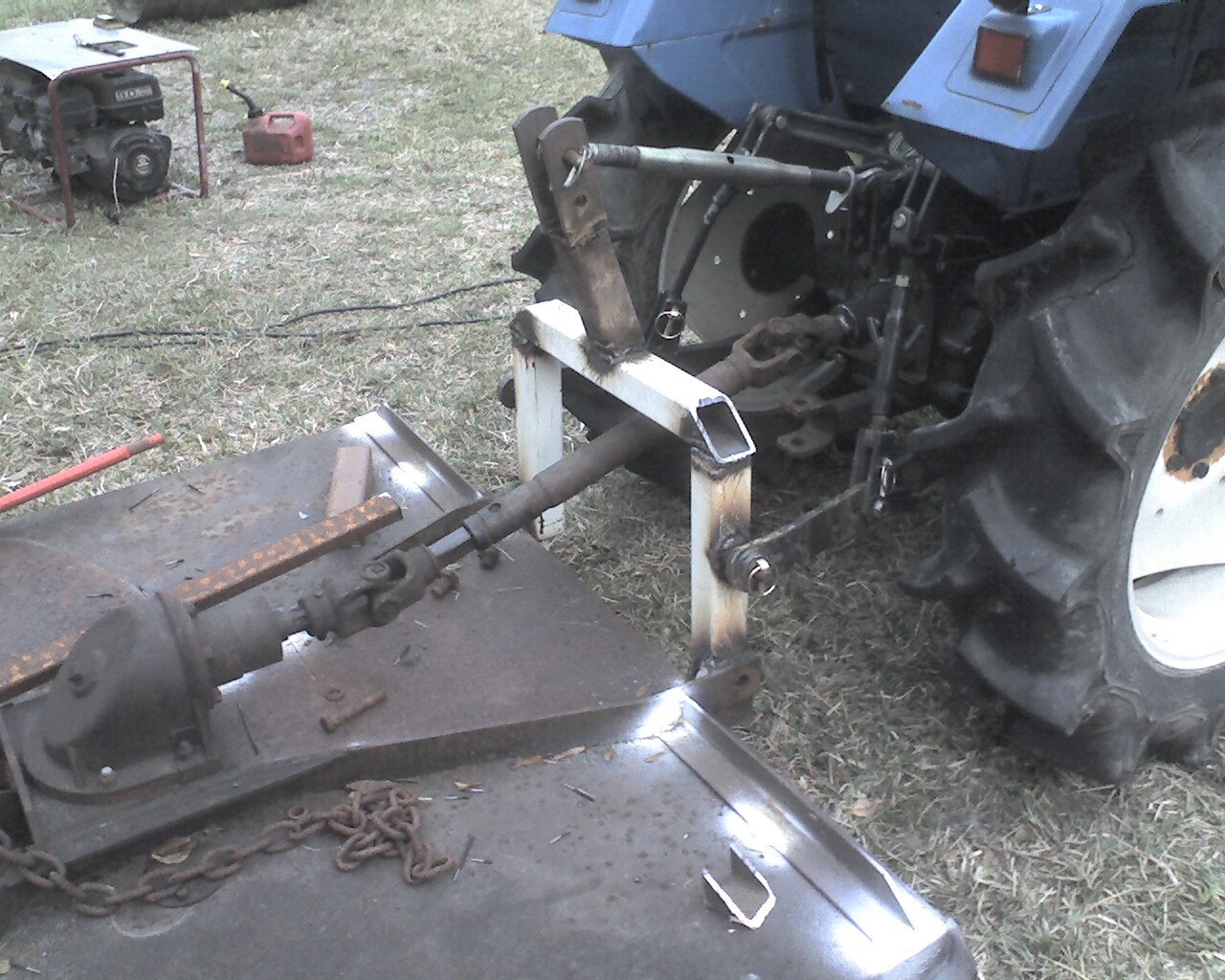

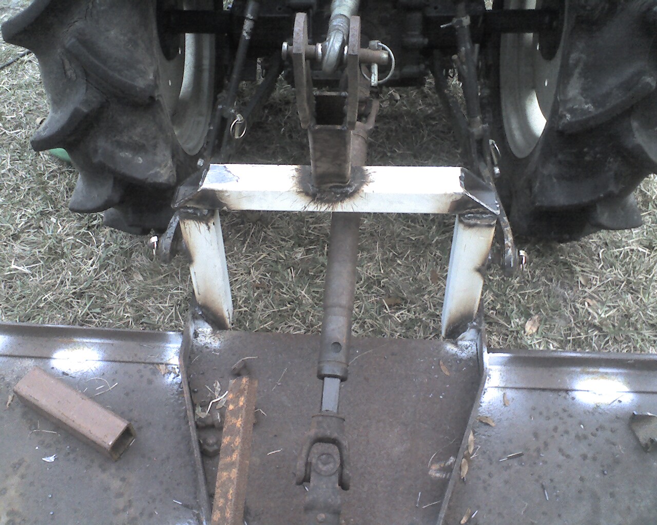

I was given the cutter for trading of services, the "A" was bent pretty bad and the deck need a little welding, so I decided to beef up the "A" frame with 2 1/2" square tubing 1/2" thick and just covered the holes with 3/8" plate. Have a few more mods. in mind, some more lighting, tool box and roll bar.
