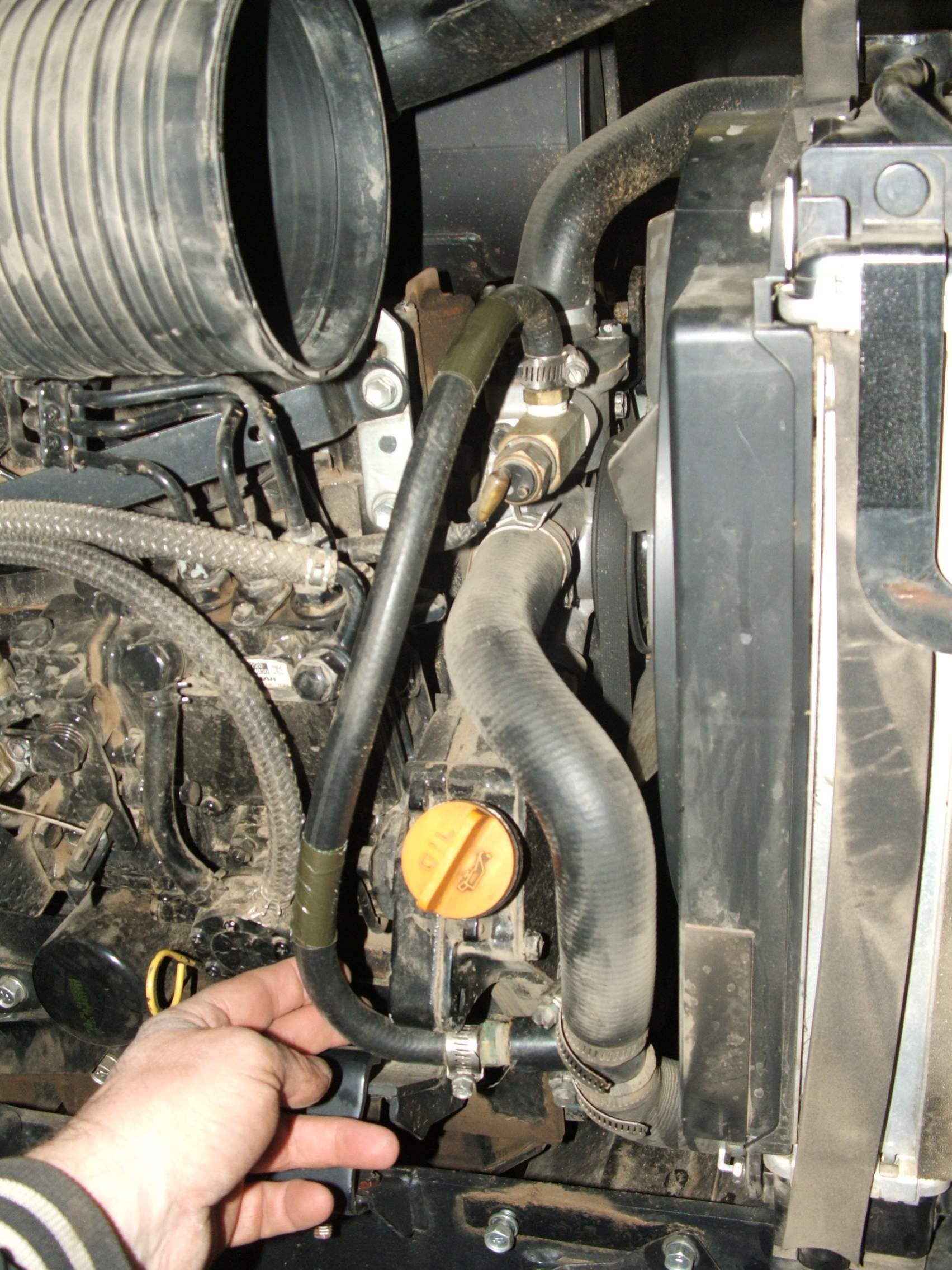

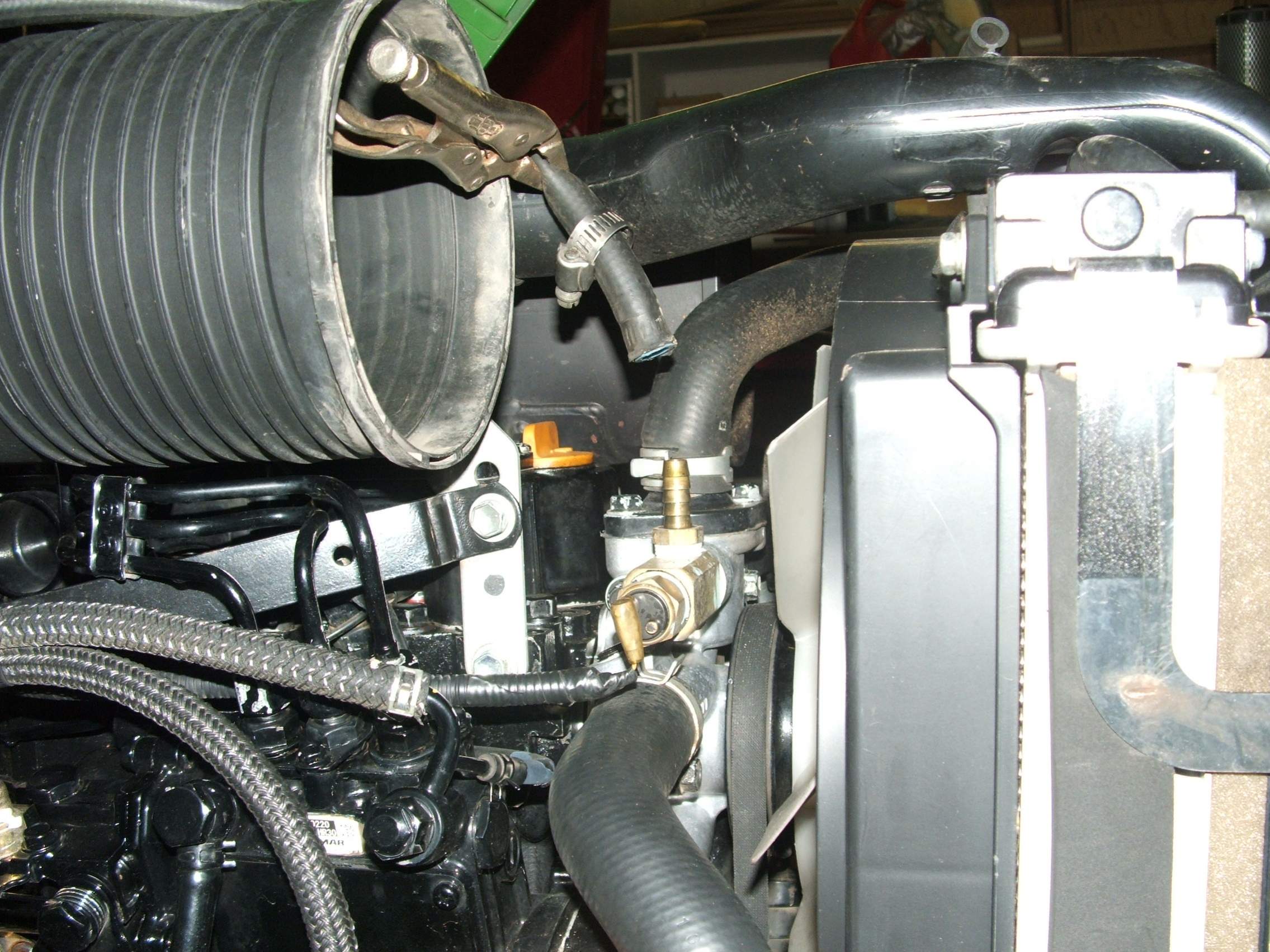

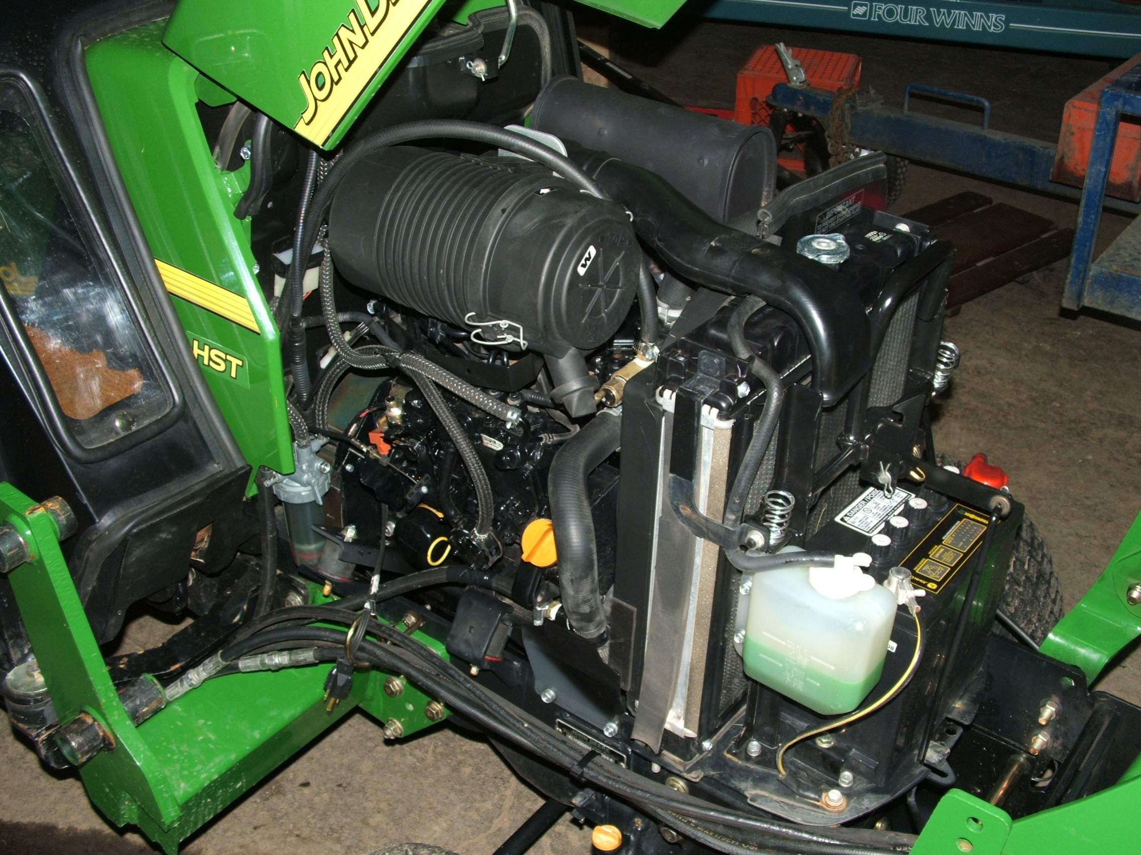

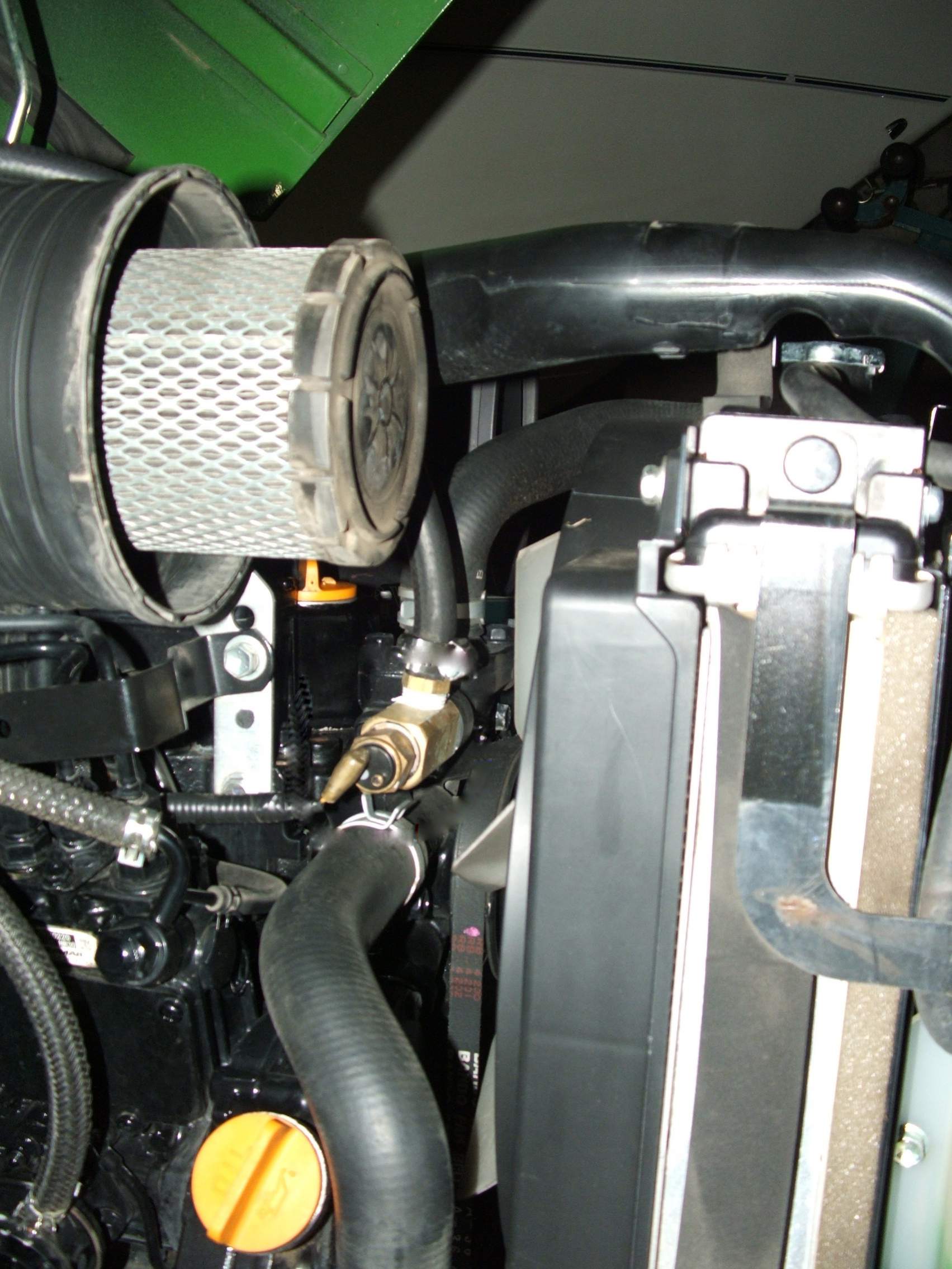

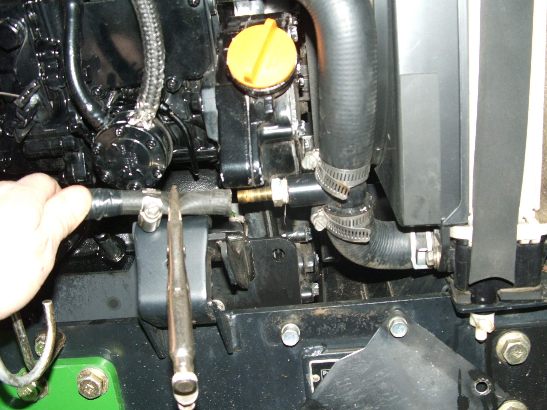

I've been eye-balling a Curtis cab for my 955. Just wondering if anyone here has one and if so, how do you like it. The one I'm looking at has a heater and I was curious where the heater hoses tapped into the coolant circuit.
   / Curtis Cab for a 955 #2
I can't help you with the Curtis cab but here are a few pictures that shows where mine is tap. The third pic. shows the loop I use when I remove my cab for the summer. Henri
   / Curtis Cab for a 955 #3
Is that a fresh air intake over the engine?
