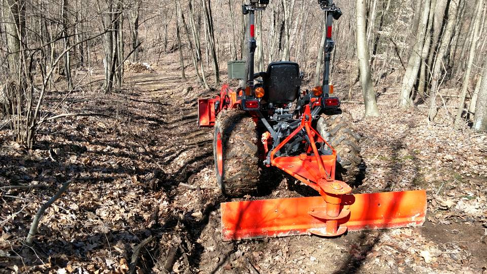

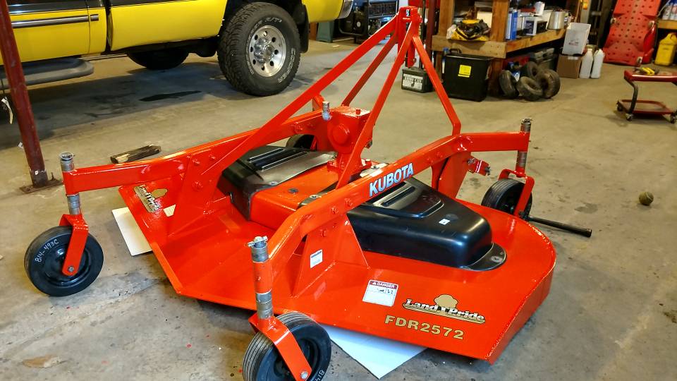

I must be really easy to please, I use the Tractor Supply Rust-Oleum Kubota Orange and find it to be plenty pretty enough to drag through dirt.
