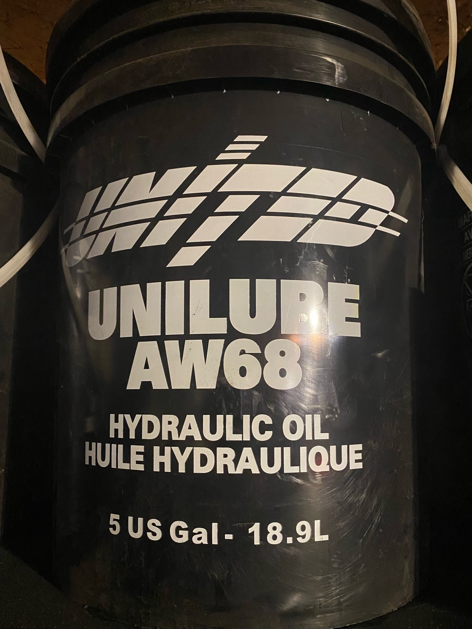

Just wondering if anyone has experience with using other name brands of hydraulic oil in their HST systems?
Have 5 pails of this stuff in the pic and a pail of shell tellus
Thanks, Billy

Cylinders, valves, hoses, tubing do not care what oil you use. Pumps do.
Usually it is the pump/hydrostat system that determines which oil to use in certain temps and conditions. Best to price out new pumps on your Kubota before using non recommended fluids, then ponder about prices of expensive Kubota oil.
AW68 oil I would only use in a heated indoor situation on a continuously running industrial hydraulic unit (I am in NH) or somewhere south of the mason dixon line maybe.

There is big difference between hydraulic oils and tractor fluid. The common sump in the tractors also lubricate the drivetrain. Regular hydraulic oils do not have the extreme pressure additives that protect the gears and bearings.
   / Curious about using hydraulic oil other than Kubota brand #6
Also, tractor fluid has additives for friction materials.

Candidly speaking I don't use Kubota SUDT or UDT in either of my Kubota's or in my previous ones I owned and sold. I use Chevron All Weather THC Synthetic and have for years now. It exceeds the Kubota specification for hydraulic oil and it ain't cheap either.
That stuff in those black pails is probably on par with the TSC cheapo hydraulic oil and will ruin your tractor.
If I were you, I'd build an oil furnace and burn it in that. You can use it but don't expect a good result.

FYI, Hydraulic oil is for hydraulic ONLY systems!!! Tractor Transmission/Hydraulic oil is for HST systems and possibly most hydraulic systems too. 😉
