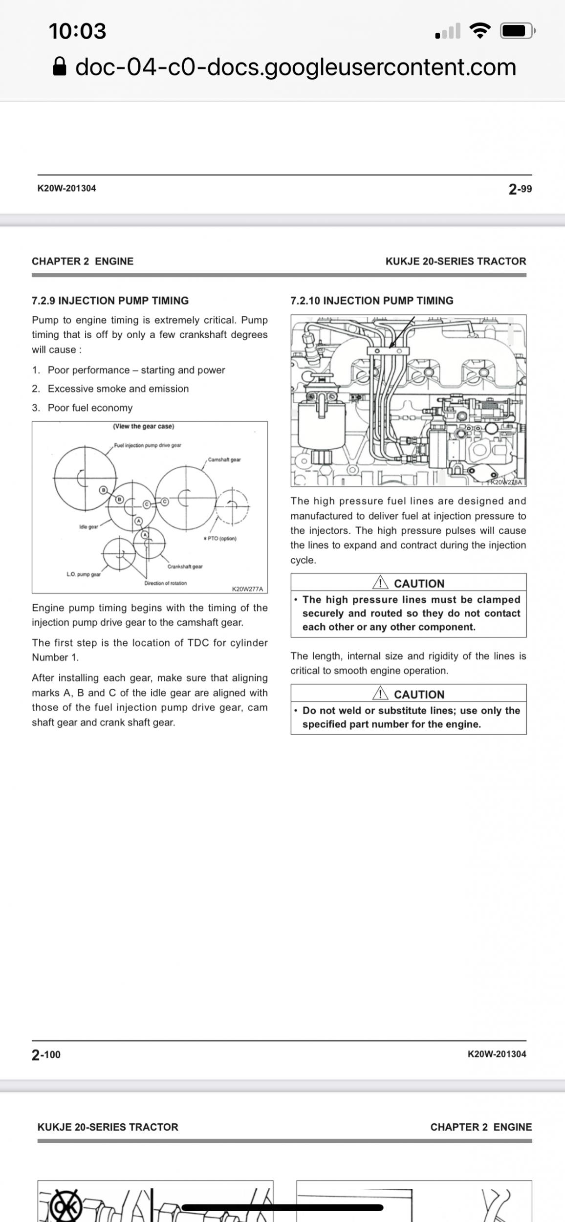

Can anyone provide engine timing specs/procedures for a 3 cyl A1500 like what is on my 2011 Branson 3120 tractor in preparation for removing the Injector Pump? Many engines seem to have a 'plunger' specifically for this purpose, located on the engine block in the vicinity of the Injection Pump that engages the timing gears when the engine internals are in the proper position; or the Inj. Pump itself might have a bolt/shim arrangement for such purposes. Mine has neither, and as close to the vest as Branson plays with information, I cannot find anything on the 'Net that addresses this. Thanks for your attention.
   / Cummins Injector Pump #2
From the service manual.
Thanks so much, K51wq !
