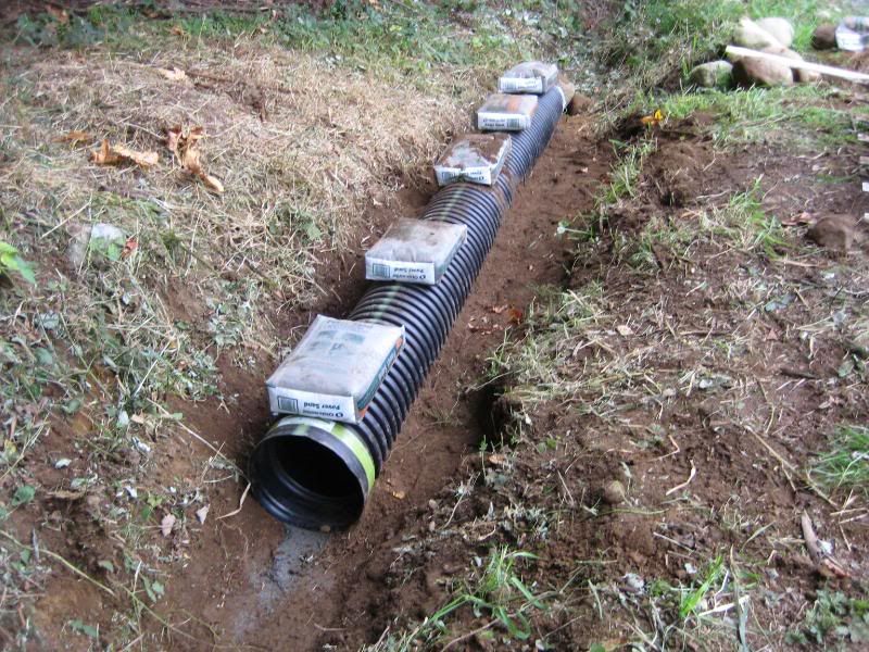

i need to spend alot of time clearing deadfall in my woods but given all the other projects i had to get done this summer didn't really get to it. i figured if i could access the woods in the winter i could spend alot of time out there the only problem is the only way for me access is via the pasture which is the spillway for my seasonal ditch. i decided to cut a swale with my boxblade to keep the water in a semi tight path but in the winter it's still too soft out there to run my tractor. so to get around that i decided if i added a culvert to my open ditch i could get into the woods via the upper part of the property and actually be somewhat productive over the next 5 months.. this would also give my better half yearround access to the roundpen for her horse training - added bonus. So this was todays project.
i picked up a 13' stick of 12" double-wall ads pipe - $5.75/ft.

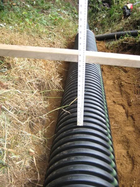

kinda a steep slope (about and 15" drop over the 13', the ditch was open for the most part but i did have to clear some blackberry vines.. gotta love the NW..
after a dry run i discovered the i would need to do some grading around on the woods side of the road, pretty steep looking:
minimum coverage for this pipe is 12" and to start with i am looking at 15" but will probably end up with 18"-20" since i'll build up the road a bit..

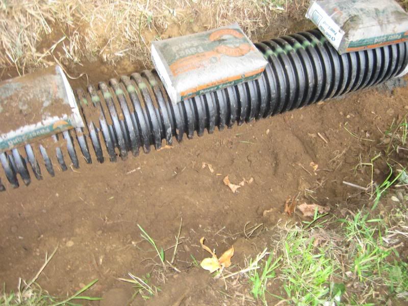

i had some leftover bags of sand from another project so decided to use them as weights to keep the pipe in place during backfill..
after created a "bed" for the pipe to lay in i decided to lay down a couple inches of this wet sand in the bed so i could make sure the corrugations all filled up on the bottom.
starting to backfill. i dug another ditch on the other side of my property and this fill was what came out of the trench, i think they call it glacial till around here, it seems to pack pretty tight.. there were a few rocks in it but i pulled out the bigger ones, figured a few small ones here and there were probably ok. i didn't have a pneumatic compactor so i used a hand tamp.

outlet in progress. for those interested i laid the backfill in 6" layers tamping each time as tight as possible, probably 4" lift when packed.
