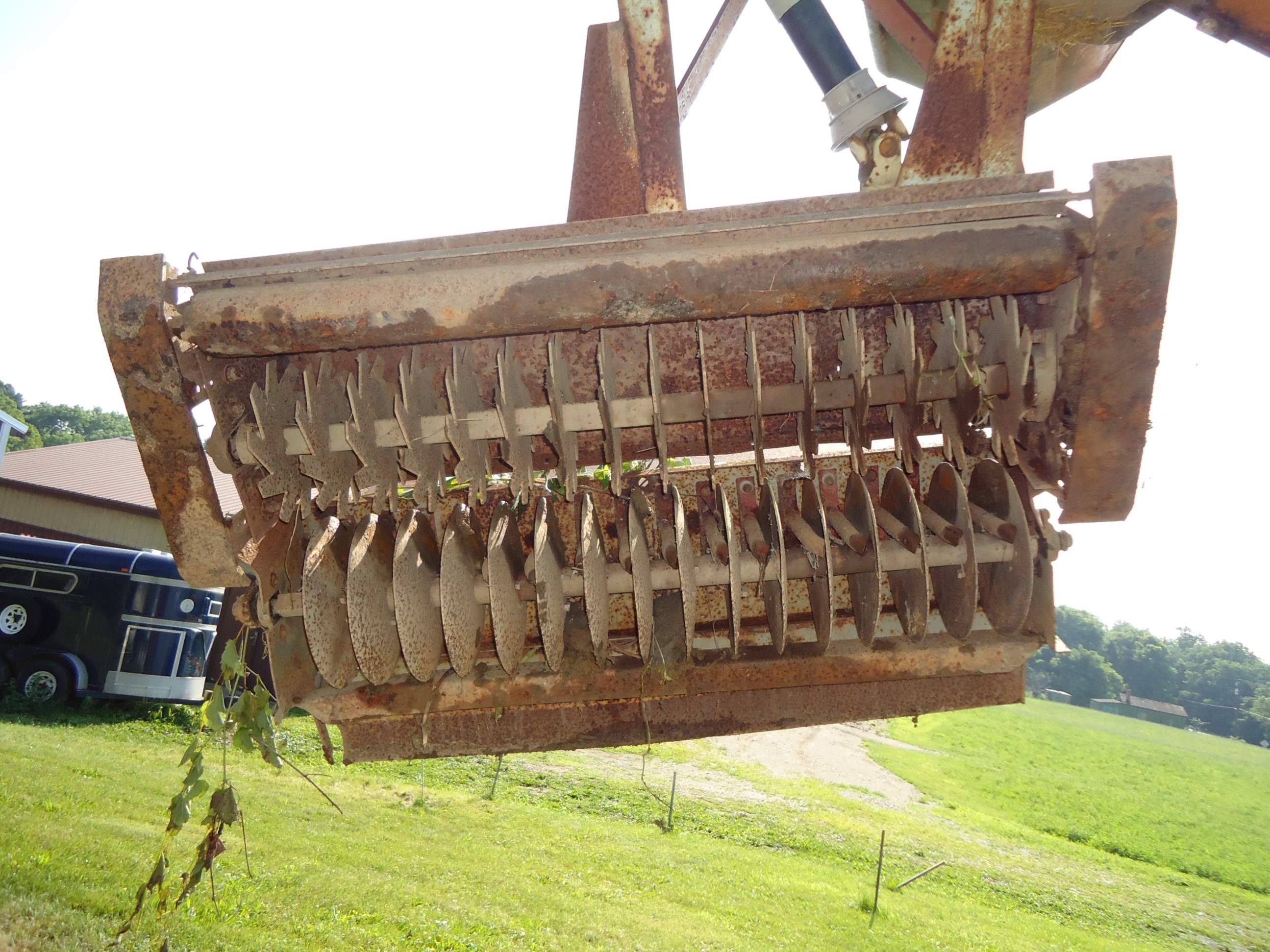

I have 3 tools I use in the hay field, and pasture here. #1, a 3 pt. Bush Hog aerator, for compaction from the horses, and tractors making hay. Usually done in April when the ground is firm, but mellow, where it can penetrate down 4". Makes a world of difference.

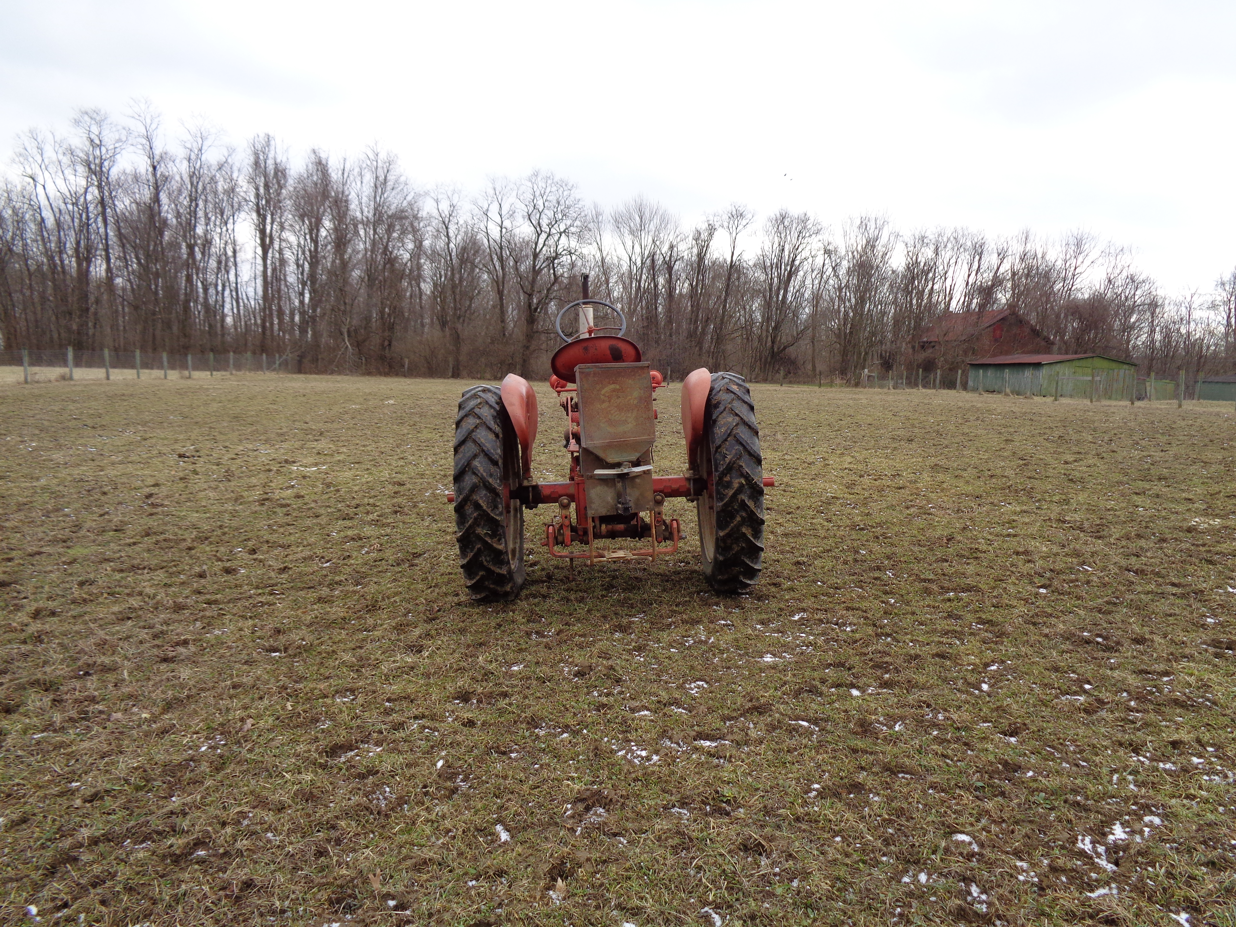

#2, an Easy Seed broadcast spreader I do nearly all of my seeding with, using the "frost seeding" method. Done the last 2 weeks of Feb., or first 2 weeks of March, when the ground is going through the freeze/thaw cycles. You're basically mimicking Mother Nature, pulling seeds into the ground, when the dirt honeycombs, opening, and closing pulling the seed in under the surface. If you have any clovers in your mix, the freeze thaw cycles also helps break the hard seed shell on it. I've been doing this method for over 20 years, and have had great success every time. Just mow the field down tight in the late Fall, so it's easier for the seeds to make better ground contact. I just re-seeded my small pastures this Spring (pictured) and had a very good stand once again. The Ohio State University has some very good instructions on it, through their online Extension service. It just needs to be done, when there is little wind. As you well know, it gets pretty breezy in March here in the Buckeye State. 2 years ago, I re-seeded the hay field in Sept. with Tuuka Timothy, and did it right before an expected 1/2"+ of rainfall, to get it set in. Very pleased with the results.
