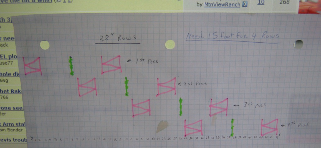

Hello all you guys, and gals if there are any....
This board is great - I've learned so much from many of you already - thanks :thumbsup:
I plan on planting Sweet and Field Corn patches next spring (they'll be well-separted, so no cross-poll problems)
I've plowed some ground recently and will let it "percolate" over the winter.
Next spring I'll disc and look for a harrow to level things up.
I recently bought a 1-row JD 71-Flex planter.
I may look into a 1-row cultivator, and if so, I may have to have it custom-built (a guy near me does such a thing) Due to the width of my tractor tires, I am almost locked into 38" rows. (I could change the tire width somewhat, but don't know if I want to go through that)
BTW - I have an 861 ford and the outside width of tires is apprx 70 inches; inside width between tires is about 44". I used some graph paper to try to figure out how to plant the rows, and it looks like my 2nd pass will require my tractor tires to be right on the edge of the rear planter tire from the first (and subsequent) rows. (I will include a picture of the graph if anyone is interested)
My question is: How close should I cultivate to the corn - how many inches? (I'll use this # to possibly have a cultivator made to fit my tractor and row-widths) I looked at the 1-row cultivators at Tractor Supply, but am not sure if it would be wide enough to effectively get close enough to the corn. I plan on going back with a tape-measure and checking the total width as well what spacing I can get on the tines. Anybody have a King-Kutter or County-Line 1-row cultivator that might have those figures? (I think they're the same cultivator, just different names)
I may just use my rear-tine tiller to cultivate, although it's width is only 16 inches and would probably (depending on your answer/s to question above) have to make 2 passes between each row. (the total area of my corn patches will be about 1 acre)
As always - thanks for your input!
P.S. Went ahead and included the graph picture (each square is 4 inches)

A Ford 100 series tractor is designed to straddle 2 rows, not 1. You'd do better with a 2 row planter & cultivator.
If you are stuck with the 1 row planter: offset the row to one side so it is 19 inches off-center, drive north to plant, turn around and plant to the south in the exact same tracks. This will give you 2 rows 38 inches apart, and allow you to straddle the rows for cultivating.
You will need to set up a 1 row cultivator with the same gap offset so you can do the same cultivating.
This is basically what the other person said, but in a different way.
You can easily set up your wheel spacing and offset the planter 15 inches, to be at 30 inch spacing, if you want 30 inch.
In any case, don't think you will be happy trying to plant with one row centered on your tractor - in effect you would be setting up for straddling 3 rows by doing so and that won't work out well.....
Really be better to have 2 row planter for that tractor, but with the offset you can make a 1 row work - pretend it's a 2 row with offsetting.
Edit: Looking at your graphpaper again, you have way too much wheel traffic way too close to the plants - corn hates compaction, no good. As well, you can't do that pattern with a cultivator, be running over growing corn. You have to offset & use the same tracks, keep your wheels away from the rows.
--->Paul
--->Paul
Thanks for the info, Paul... I appreciate your insight...
I bought the 1-row planter (and just received it about a week ago and haven't even unpacked it yet). I bought the 1-row for 3 reasons: 1) cost, didn't think I could afford a 2-row, 2) didn't think I'd be planting enough to justify a 2-row, 3) I could get the 1-row delivered fairly cheap via UPS and not have to fool with having to find someone to freight it.
I'm gonna forget about a cultivator - I'll just use my rear-tine tiller and avoid possibly having to deal with adjustment issues and tearing up any corn... Plus, it's paid for - might as well use it.
I saw on the oldfordtractors.com site that the wheels on my 861 will adjust from 52" to 76". I don't know that I have the expertise, tools nor confidence to try and adjust them myself, but if I were to have someone narrow them for me, what width would you recommend? I also use the tractor to plow (2-bottom), disk (6-foot 3-point) and bush-hog (6 foot, going to a 5 foot when old one is shot).
Since I'd be narrowing my wheel widths to accomadate my row plantings, obviously only once a year, I'd like to find a "happy medium" that would still work well with my other implements. Are there any "concerns" with going too narrow and having issues with my other implements? (i.e., problems with my swing-arms and stablizer bars being impacted?)
I can deal with 38" rows, but would prefer 30", but I'm more concerned with ease of planting (where the tractor tires fall). Unfortunately, the Tool Bar that came with my planter is not very long, and it looks as if I'd only be able to move the planter about 3 inches either way. I guess I could get a wider bar and use that. (May even be able to send the short one back and trade it for a different style that would more readily adapt to my planting situation...)
Thanks again... I'm interested in hearing back on your opinion. Anyone else? Feel free to jump in on this!

Do you have a manual for your tractor? They explain the wheel tread adjustments very well, and safely. I'm used to my 960 Ford tractors, I have not worked with the lower wide front models, so my info may be slightly off, but in general....
The front axle you jack up one side, take a few bolts out, move axle 1/2 in or out to where you want it, and bolt back together.
The rear axle may have 2 designs, power adjust, or bolted on dished rims.
The power adjust you take off the 4 bolts holding the cast clips that lock the rim to the center, and drive the tractor forward or backwards to screw the rim in or out. The rim center is a bit screw-shaped, and will stay in the 4 guides on the rim.
The bolted dished rims, you have to take the dishes apart from the rim, and reposition the dish, or the side of the rim, or swap one side to the other, to adjut the width. It's not as complicated as it sounds, but it is much more work than the power adjust!
A plow needs the right wheel set up just right on a tractor, if you move that right rim, you'll need to put it back where it is for plowing. For the rest only concern is the narrower the tractor, the easier it can tip on hills and such.
Hum, a planter that isn't adjustable but 3 inches. That's kinda a bummer. Going to be much harder to make this work. No offsetting.
I'm a farmer, corn & soybeans. My goal is to produce the best crop I can. I probably realistically only get 50-60 chances to make a crop in my lifetime, I need to make each chance count. Corn is a fussy crop to do well tho easy to grow any old way, it likes even emergence, it likes no weed competition when it is small, and it prefers to have a low-compaction zone on at least one side of it for the roots to grow and suck up nutrients. In my world, those are the important things, and I've used up over 1/2 of my chances to get a perfect crop..... ;) So my goals might be a little different than if you want a fun hobby of growing a little sweet corn & deer plots. ;)
Since you are one row and I assume harvesting by hand, you can use other common spacings, 15 inch, 18, 20, 22, 30. 36,38, 40, 42 But, the narrower you go, the more passes you make planting, so likely won't help the problem. The 38 inch as you drew out is probably as good as anything, and if you don't plant when it's muddy will likely work out.
