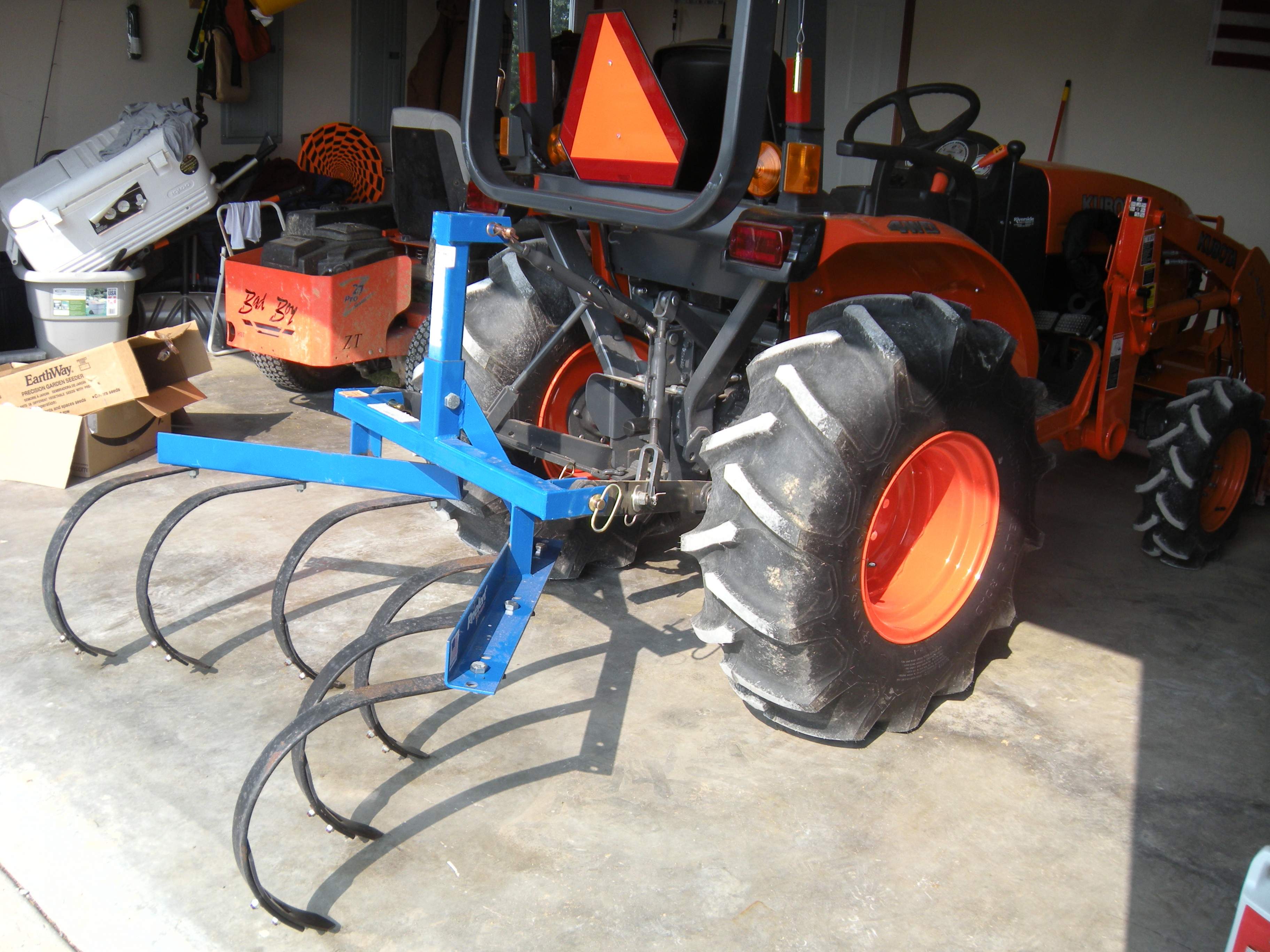

I'm using a C-shank 1-row cultivator, with straight bars [not sweeps]. One issue that I'm having trouble with is the turned-over soil flops onto the planted row, breaking some of the tender plants. I tried widening the spacing, and then angling the bars, but same result. Would a half sweep attached to the inner most shank throw the soil away from the planted row? Or if any other ideas I'd appreciate it. Thanks.

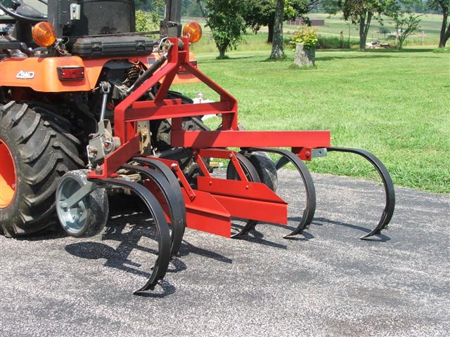

Cultivators come with Shields or a rolling guard to protect the plants. maybe you could fashion some sheet metal to slide along the row to protect them.
Like this
or this

have you tried adjusting the angle of the inner bars? it doesn't look like you can change the height relative to the others.
   / Cultivating Between Rows covered #4
I agree with randy...try loosening the bolt on each of your inner shanks and turn them so they spill the soil away from the tender plants ...then tighten the bolts...see if that works.
Thanks. I played with angling the shanks. Also, I moved the interior shanks outward one bolt. It did help some...so I'll play with it more. As for vertical adjustments....there is one I can make, and that's to reverse the tips on the shanks, since the bars are offset. I made the outer bars to cut deeper, so I can ease up overall, which helps to not throw too much onto the planted rows.
On the shields, I googled that topic, and did find some ideas to put one together. That would work as well. Thanks all for your help.

That type cultivator has "swinging fenders" available from most mfgrs. Here is a less expensive way to fix the issue....You should have 2 bolts that hold on the point. Just below the top bolt that holds on the point, wrap tightly electric fence wire until it protrudes 1/2-3/4 inch out from the points leading front edge. This will cause the dirt to breakup and roll back down before it curls over onto the tender plants. Not joking! Ken Sweet

If this fails and you need a set of swinging fenders, I may be able to get a set for you? Keep us posted. Ken Sweet
