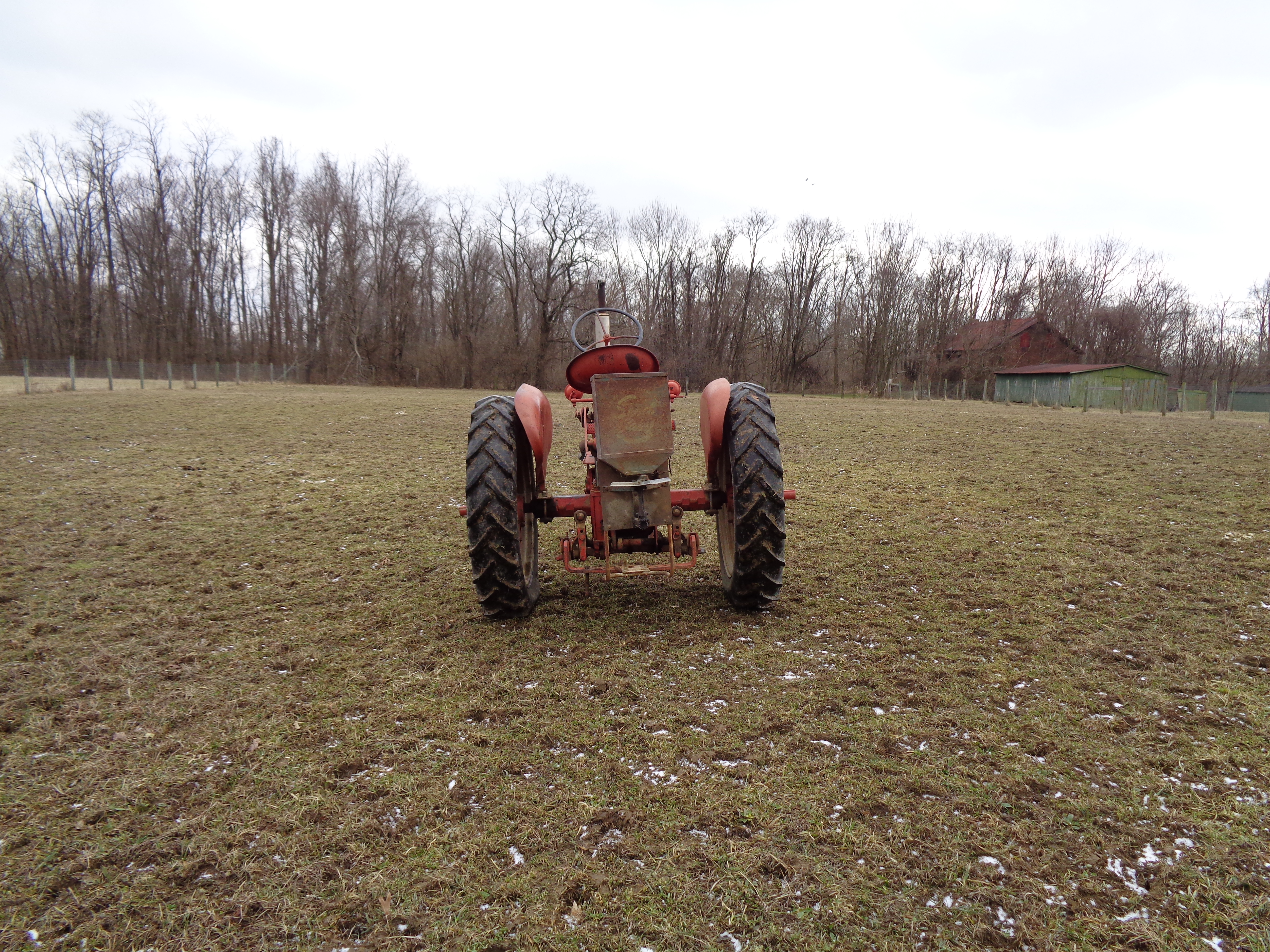

You're pretty much doing "frost seeding" (Google it) a few months early. We normally do that here the last 2 weeks of Feb, through the first two weeks of March. With the freeze/thaw cycles, the top surface will honeycomb when it freezes, then smooth out when it thaws, pulling the seed into the dirt. Basically mimicking Mother Nature, in the way she reseeds.
Anymore, that's the way I reseed my small pastures & hay field, unless I start some Timothy in Sept. The freeze thaw cycles also help break the hard shell of the Alfalfa, and Clover seeds. Many times here, I've seen farmers seed clover on top of snow, to take it into the ground.
I've always had great stands, after using the Frost Seeding method. Here is a picture of where I frost seeded a small pasture this past Feb., using my Super C Farmall, and Seed Easy spreader.
