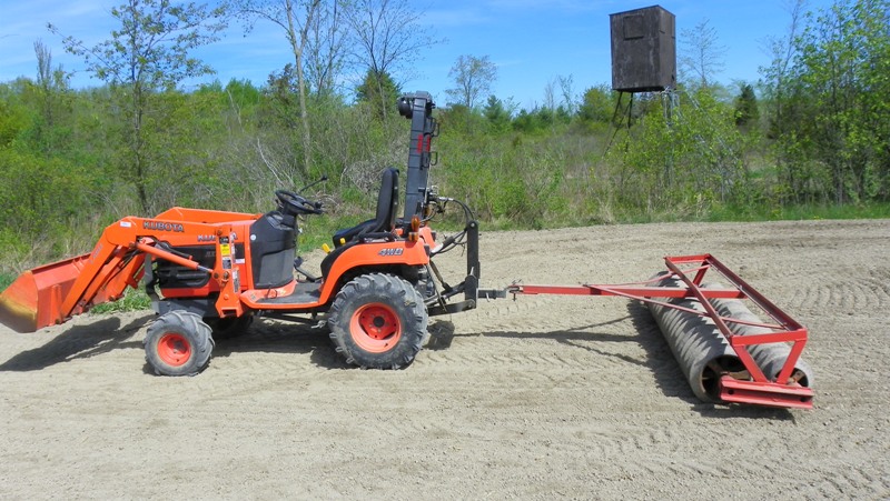

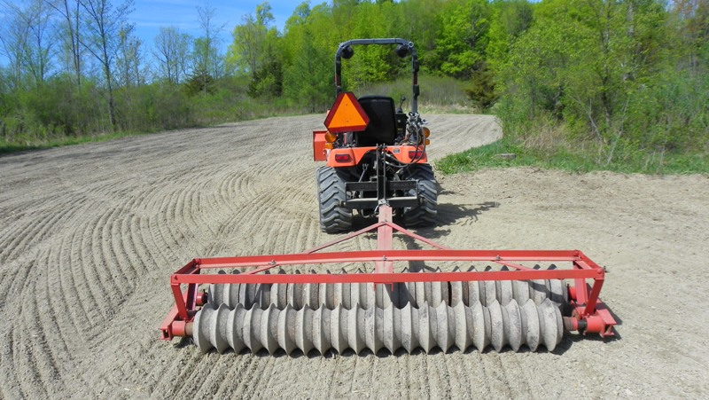

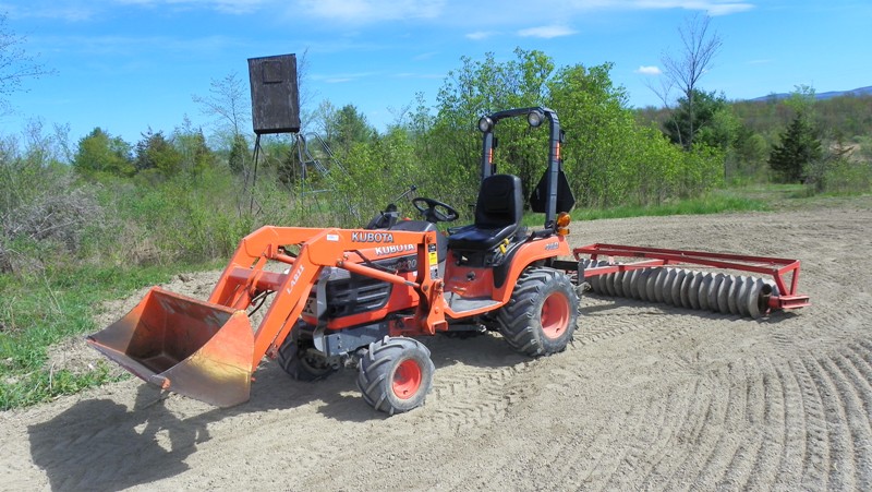

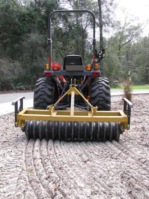

The cultipacker is the way to go for me. My Deer plots come up great here.
David Pidgeon

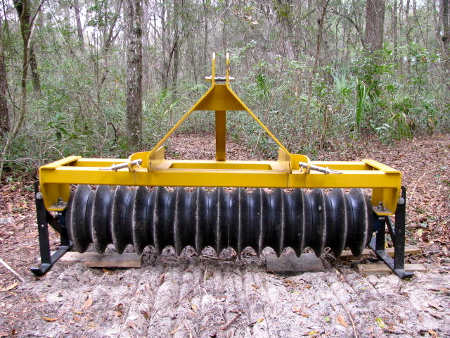

Drag Harrow is a good tool but it will not PACK/PRESSURE seeds into close contact with soil, which a Cultipacker does.
Some food plot seeds are very small but require light to germinate. A Drag Harrow is more likely to cover these seeds too deep.
Cultipacker will leave some ridges after rolling a lawn but not much if you choose a day without mud to roll in seed.
Three Point Hitch mounted Cultipacker, which is heavy and compact, makes an excellent counterbalance on your tractor.

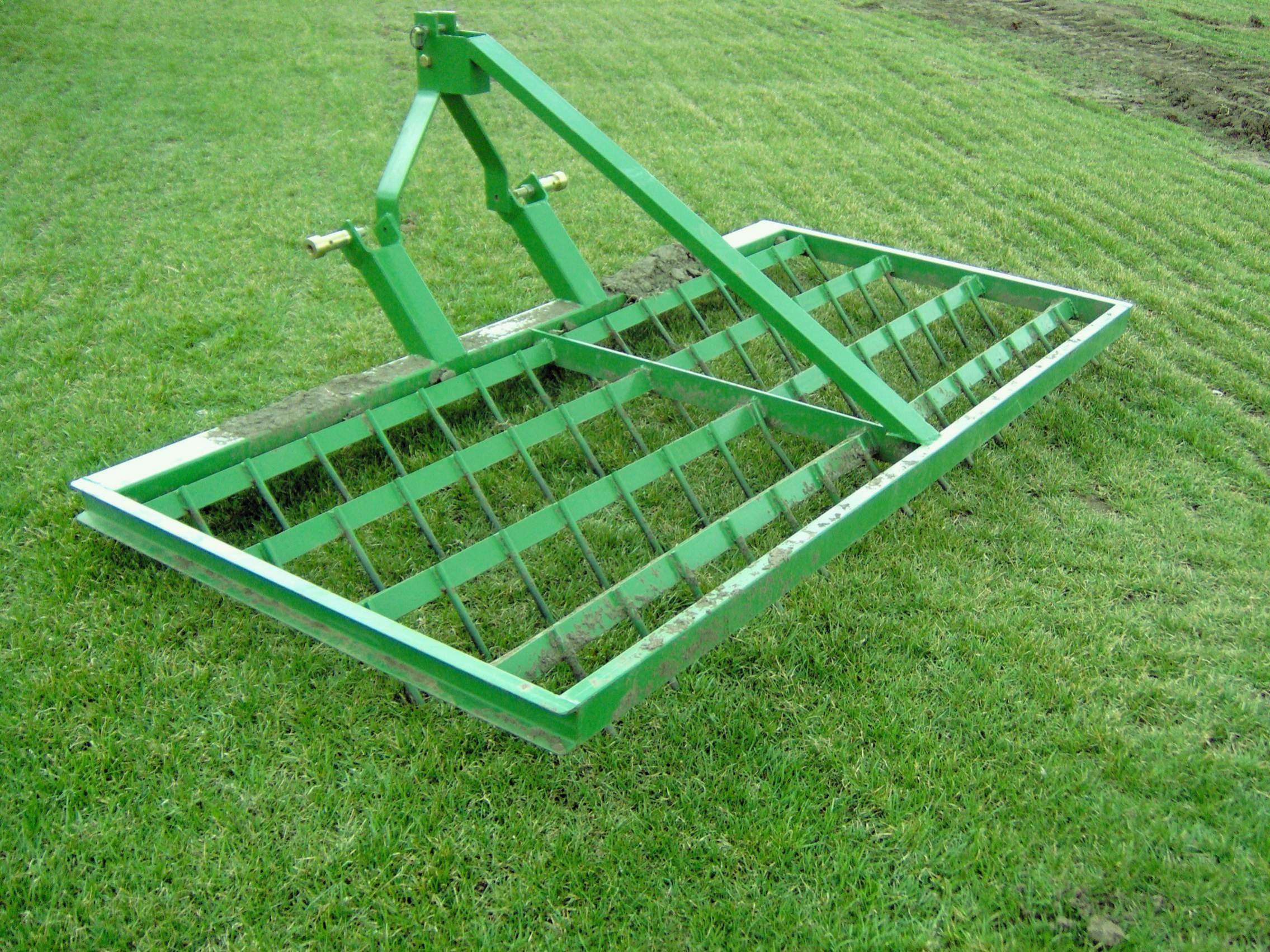

I like cultipackers too but for a lawn area I prefer something smoother so I use a roller. Using the home built spike tooth harrow and water filled roller worked for me on my lawn.

Thanks for pics of the first 3PH Cultipacker that I have seen. I agree the two implements are very different in use and function.
   / Cultipacker vs drag harrow #8
I like the parking stand for the 3pt. cultipacker...!! That would be perfect for my 3 pt. Aerator..!! I see a future project..!!
