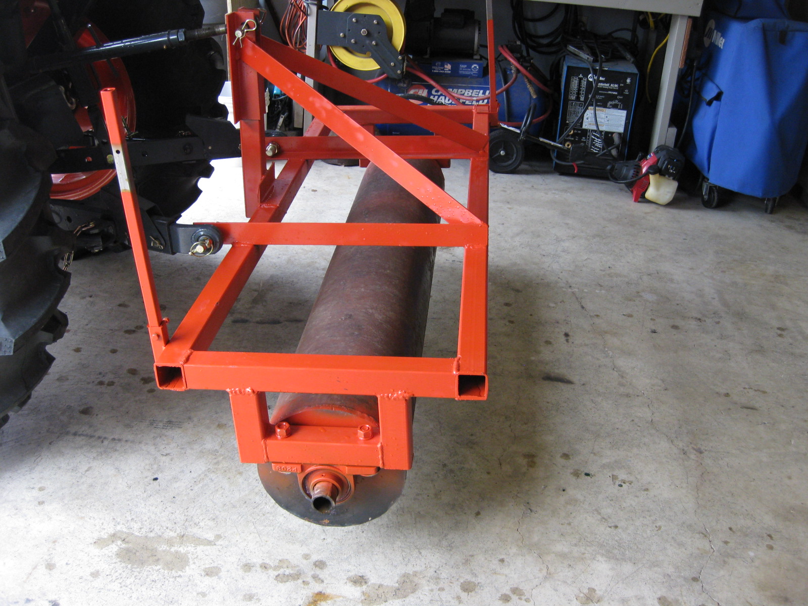

I have to agree. I made a roller-below and it worked way better than any drag I had used. Borrowed a cultipacker and planted the same way and rolled-packed the seed. It worked WAY better with almost every seed coming up. And to say the least they all came up at the same time. When planting small seed it is a must and with larger seed- I have found that you can just not cultipack after tilling or discing. So small seed, till, cultipack, spread seed cultipack in. Larger seed, till, spread seed and then cultipack in... This year I will plant rye, oats and clover all together. So I will till first, then spread my oats and rye cultipack then spread my clover and cultipack again... By the way got my cultipacker wheels from sweet and they were perfect and good price! The roller I made just didnt break clods up and high centered on some of the fields and I didnt get proper packing with it..

Nice job Andy. I wonder how much lead weight you could put in those tubing frames. That would really help on knotty soil. For the guys who like to "project", I have 2 other sets of just used rollers and axles and pillow block bearings running on Ebay. We have 20-25 used cultipackers on hand today. Ken Sweet

I forgot to mention that I traded the roller for a boxblade. No longer needed it nor wanted it after using a cutlipacker. :thumbsup:

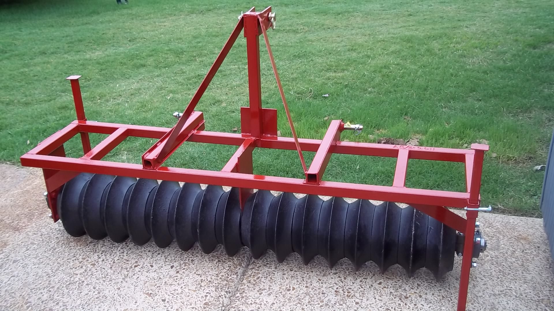

These photos were very helpful. I also looked at some photos of used Cultipackers on the Sweet website and it got me to thinking. I have a spiker/spreader that includes wheeled spikes spread about 3.5 inches apart - I'll be using it to spread the seed. I was wondering if I could put cultipacker wheels in between these spikes and have a similar tool to what you've created here. But, because of the spikes in between it might break up any dirt clumps better. I'm looking for an inexpensive way to replant my pasture which became overrun by weeds back in the drought of 2012 so I killed it off and am starting from scratch. However, I hope to only have to do this once, so can't really invest in the purchase of a cultipacker.

Is that a Dunham? I've seen a couple of those double-roller cultipackers come up for sale locally, how do you like it? I'm shopping for one.
   / Cultipacker Guideline Use for Sowing Seed #9
It works good. I had to fix one of the bearings on it. Kind of did a schlock job but it should last for years as they turn over real slow and I don't use it a lot.
I also had to braze up one cast iron end frame which was cracked.
I looked for a long time before I found one that was reasonably priced.
You can kinda see the crack in the first photo.
