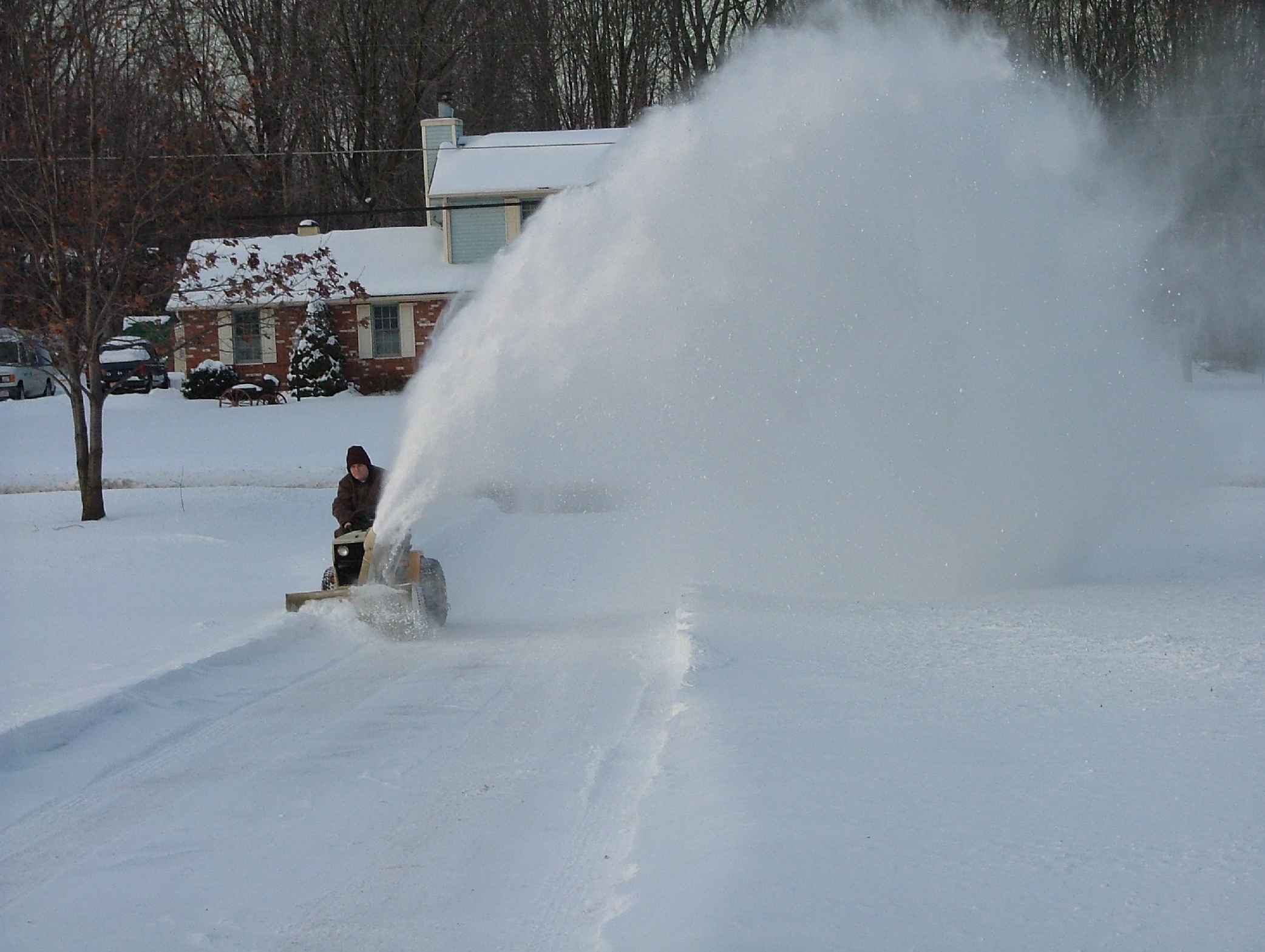

Thanks Art, Bob,
The 1862 needed an adapter on the lift cam, I think.
I may try the IH Registry and see if the 451 manual is there. I'm guessing the fact that is hooked right up and lifts with no problem, the worst case might just be a need for a different belt.
Here's a picture of the 450 mounted on the 1872 in action.
