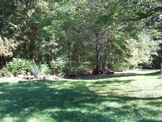

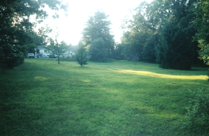

Hi All,
I have tried to find as much info as possible to make an informed buying decision but finding info/opinions on the following mowers seems impossible. Maybe I'm looking in the wrong places. I'm hoping tractorbynet is the place to get some good advice...
I am looking to buy a zero turn mower with a steering wheel (I don't want to buy a lap bar or get into lap bar vs steering wheel thing). The 3 mower brands that sell them are Cub Cadet, Toro and ExMark (made by Toro?). I have about 1 1/2 acres to mow that is rolling & sloped about 5º-10º on average and a few very small parts of my lawn are more but not worth noting. I have too many trees and things to get around to use a standard tractor mower which I use now. I'm looking for opinions (should be easy to get on the internet :laughing: ) to make a decision on what brand to buy. As for deck size, I'm thinking of 42"-50". My current tractor mower takes me 2 1/2 hrs to mow then another hour with a push mower to get the places I can't get to with the tractor. I don't need a commercial super mower, but would like a mower that will last a while (10-15 yrs?) and do a good job cutting my lawn (which is not a plush flat lawn that you see in the suburbs or in commercials but more "natural"/rough).

I don't have any advice for you on those two specific mowers, but do have some other advice.
1. I doubt that any mower that is not a full blown commercial mower is going to last 10 - 15 years unless you put very few hours per year on it AND baby it AND maintain it religiously. The mowers you are looking at are $3,000 mowers. It is very doubtful you would get that sort of longevity from one of them. There is no such thing as a free lunch. You don't always get what you pay for, but you never get something you don't pay for.
2. I don't know what level of motor the Cub and Timecutter use. Almost certainly not a commercial grade. Kawasaki designates their engines by the prefix FR (residential), FS (semi-commercial) and FX (commercial). Kohler's commercial engine is the Command Pro. Briggs & Stratton's commercial engine is the Vanguard, which is not built by Briggs but by Daihatsu. The commercial models of all three brands are good motors. The lower end motors seems to be luck of the draw. From any of the three, you might get one that is great, or you might get a problem child. Which is best or worst? Well, that depends on who you ask. You can find people who love one and hate the others. Another guy will have some anecdotal story about one of them that blew up, used oil, backfired, wouldn't start, etc., etc. There are guys on lawnmower forums that will whip out their keyboards and duel you to the death over which brand is best and which one sucks the worst.
3. I don't know what type of transmission the Cub or the Toro use. If it's HydroGear, my understanding (which could be incorrect) is that any HydroGear tranny below a 3100 is not considered commercial grade and may not be repairable (or, even it if is, may not be cost effective to repair vs. replace). If it's TuffTorq, some of the TuffTorq hydrostatic drives (used in JD lawn tractors) are not repairable - at least not officially. The K46 is one of them, although I believe there's a thread here on TBN on how to repair one. On the other hand, some of the TuffTorq's are indeed repairable and are a lot more robust than the K46. I have a TuffTorq K71 in my John Deere GT235, and it's a very stout transmission that was used back in the days before JD sold out their integrity to the big box stores.

Have you ever used a zt mower on a hill? My brother had one and found it alawys wanted to turn down hill when running across the hill. He had a heck of time trying to keep it in a straight line. Maybe it was the machine, maybe it was him, but I can see how the casters on the front could cause that.
He had 20 hours on a new Snapper and traded it in for a conventional steering unit.

My lawn condtions are similar and I have no complaints over the longevity of my Toro residential mowers. I have a Timecutter z420 (B&S 16hp) going on 10 years old now, and I have a 32 inch rider (B&S 8hp) that we keep for backup that my grandfather bought in the 1980s, The current z420 gets about 2 hours a week of use, there was no time saved when I upgraded to a Zero turn...my lawn simply got bigger!
I have a knarly drop of the edge of a septic field, I always hit that going nose down and the Toro can maintain a controlled descent. Occasionally I will have a problem on a hill steering in one direction, so I just spin it around in the other direction, remember, ZTRs are like driving a spinning tea cup at Disney World, have fun with it.
