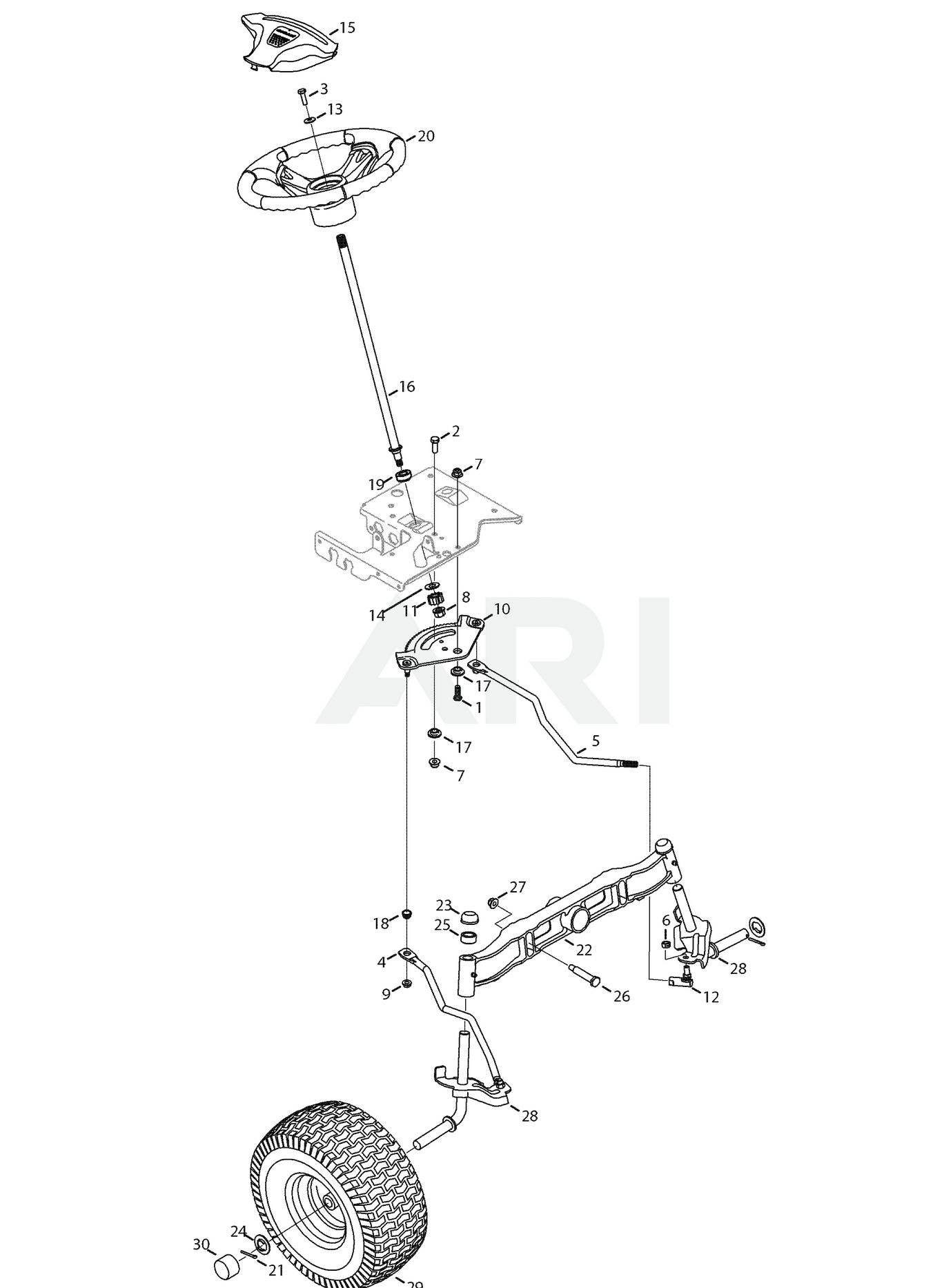

Sep 16, 2021 / Cub cadet steering problems #1 B Blondegrl69 New member Joined Sep 16, 2021 Messages 1 Tractor Lt1050 My steering free spins to right. Only grabs to left. Is it my geers
Sep 16, 2021 / Cub cadet steering problems #2 Roadworthy Elite Member Joined Aug 24, 2019 Messages 3,779 Location Southeast Washington Tractor Kubota L2501 HST, Check for stability of the steering column. If it's a bit free to move at the steering box end it may not be engaging properly.

Sep 16, 2021 / Cub cadet steering problems #4 ruffdog Super Star Member Joined Dec 31, 2011 Messages 10,511 Location southern wisconsin Tractor Bobcat Toolcat 5610G, Deere X744, Cub Cadet IH 982 Maybe the OP is talking about the LT1050? Check the steering gear/rack.
Sep 17, 2021 / Cub cadet steering problems #5 T tomplum Elite Member Joined Jan 30, 2017 Messages 2,745 Location PNW Tractor XJ2025H It may be only the lower bushing that supports the steering shaft. Remove the deck for access. When inspecting the gears check for wear in the support plate where the bushing rests.
Sep 17, 2021 / Cub cadet steering problems #6 JasperFrank Veteran Member Joined Nov 23, 2018 Messages 1,864 Tractor Ford 1220 Here's a diagram for the lt1050. Check for broken teeth on part 10.

Sep 17, 2021 / Cub cadet steering problems #8 L lman Veteran Member Joined Oct 3, 2009 Messages 2,356 Location Indiana Tractor New Holland 3040, New Holland 1530, Oliver 1850 Part 11 and 17 regularly need to be replaced. My mother has an LT1050 and I try to keep it going.
Sep 17, 2021 / Cub cadet steering problems #9 JasperFrank Veteran Member Joined Nov 23, 2018 Messages 1,864 Tractor Ford 1220 The repair vids all seem to point to part 19. Which is a guide sleeve for the steering wheel shaft.
