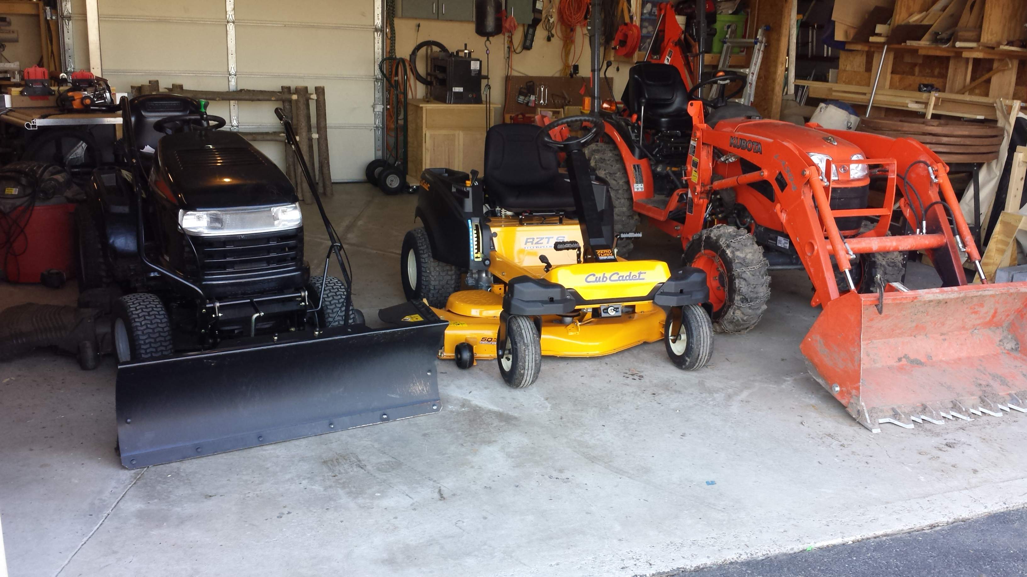

I will try to attach a picture. The other mower is being sold but I thought it was a neat picture with them lined up

Mower looks great! What are the peddles for?
