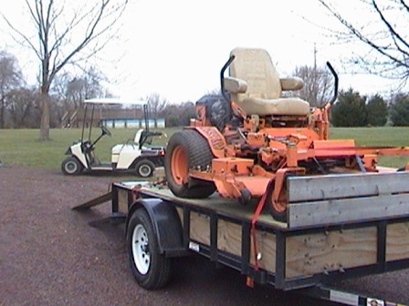

I own a Scag ZTR and I can tell you it is built rock solid. This is the second Scag mower I have owned (the first was a walk behind). I'm an IT Manager by trade and I sit in an office all day overlooking our corporate center. I was sold on the Scag by watching the lanscape workers running around on these things all day. If they can handle running all day every day then they will surely last me a lifetime on my 2 acres.
Here is a pic of my current Scag. It's a 2001 Turf Tiger with a 27 HP Liquid Kawasaki and a 72" deck.

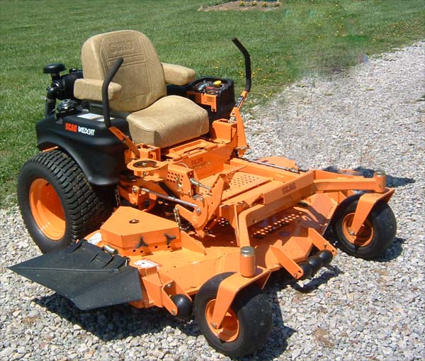

</font><font color="blue" class="small">( I own a Scag ZTR and I can tell you it is built rock solid. )</font>
I'll second that for the Scag line. I got the Scag Wildcat last year and have been nothing but pleased with it.
I'll attach a pic.
