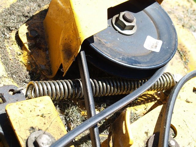

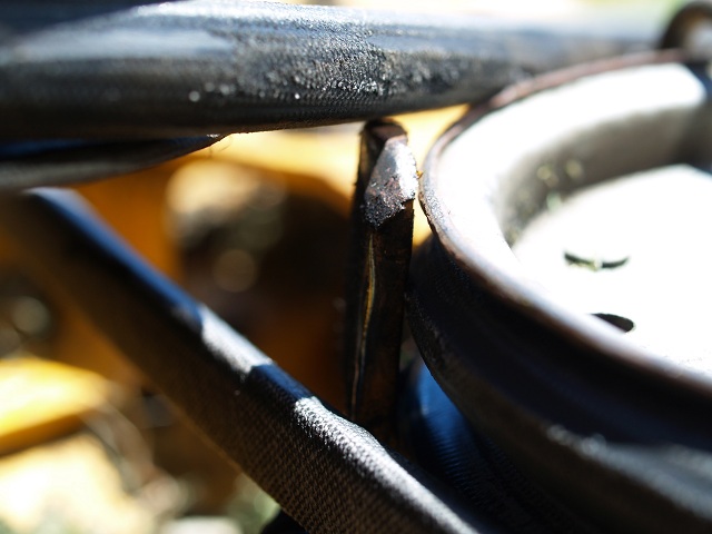

   / Cub Cadet LT 1042 has no cutting power
Okay - I checked the tensioners and the springs feel pretty firm - no stretchy-give in them - a good solid amount of tenson applied at all times.
One thing I thought of now though - now that you've drawn my attention back to the deck - is originally, I tried replacing the deck belt without removing the deck and ended up with the belt on the outside of the guide for the tension pully. This resulted in a short lifespan for the belt but also caused some wear on the outside of the guide. It's quite close to the pully wheel and on the tension pulley, the belt faces outwards. I'm wondering if maybe this is bent and a little too close to the pulley and is catching on the belt? I've attached a photo (hard for me to judge because I never saw it before I put the belt on the wrong way so don't know if it's even bent at all).
I've also attached a photo of the whole deck so you can see the belt is configured the right way.
Cheers,
Mark.
   / Cub Cadet LT 1042 has no cutting power #5
I had a lt1042 2005 model for several years and had no deck belt problems.
But - in looking at the pix of your deck - and then looking at the parts list diagram from my 2005 model - there seems to be a difference in where/how the tension idler pulleys are located.
Could you please post the full model number of your tractor from the ID decal located in the cavity under the tilting seat.
We can then at least compare parts list diagrams to see if your deck is incorrectly assembled or just a different design.
right now, appears you would have the belt rubbing in at least one or two spots when installed and under tension...
Whups! just spotted the needed model # in your original post. Will check out and repost.
   / Cub Cadet LT 1042 has no cutting power #6
well, was not able to get a parts list for your machine, but did find a decent illustration of the deck and deck belt in the owner's manual for your model.
and it appears that your deck's configuration is OK.
The belt type can be important. CCC (MTD) uses Kevlar belts in many of their apps - aftermarket substitutes don''t hold up well.
Also verify that the tensioning idler pulley bracket is not sticking but pivots freely and that when deck is fully installed, belt tension should be such that you will need to use a tool to relieve belt tension in order to remove it. if you can do such by hand, belt is not tight enuff and probably stretched.
Belt routing looked OK on your pix - just verify that belt V's fit down into both spindle pulleys and PTO pulley - and that belt back (flat) side contacts both idler pulleys.
Also make sure both deck cutting blades are NOT installed upside down (easy to do).
If replacing that belt, make sure you get an OEM belt that carries the correct p/n for your machine. That p/n should be on a label on the underside of your engine's hood or in your manual.
If still concerned about the PTO slipping, have someone sit in the seat, turn ignition to run (DO NOT start engine) and activate PTO switch. Should hear a sharp click from the PTO - then try to turn one of the deck mower blades by hand - should not move.
BE CAREFUL.
good luck
