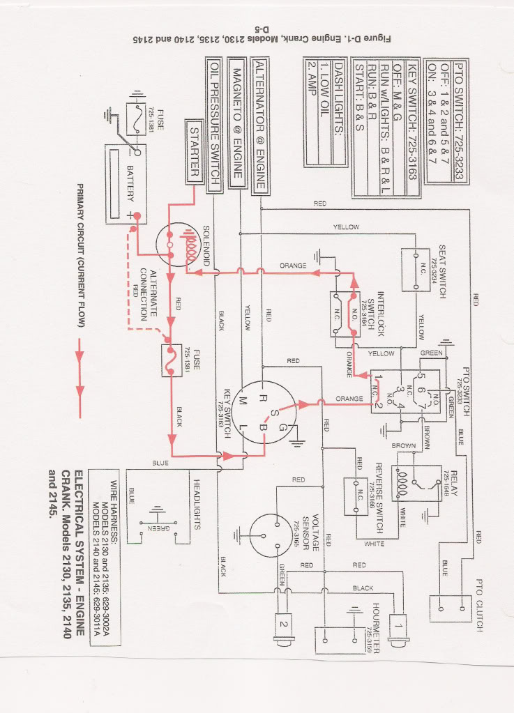

My cub cadet starts just fine but will not shut off or turn lights on. Any idea on where to start solving this issue. i have this schematic and I think the problem would be in the ignition switch.
   / cub cadet hds 2135 ligths and turning off problem #2
I would get a test light or meter and check for voltage on the wires from the switch in each position. Pretty simple design, I would agree that the switch is probably bad.
